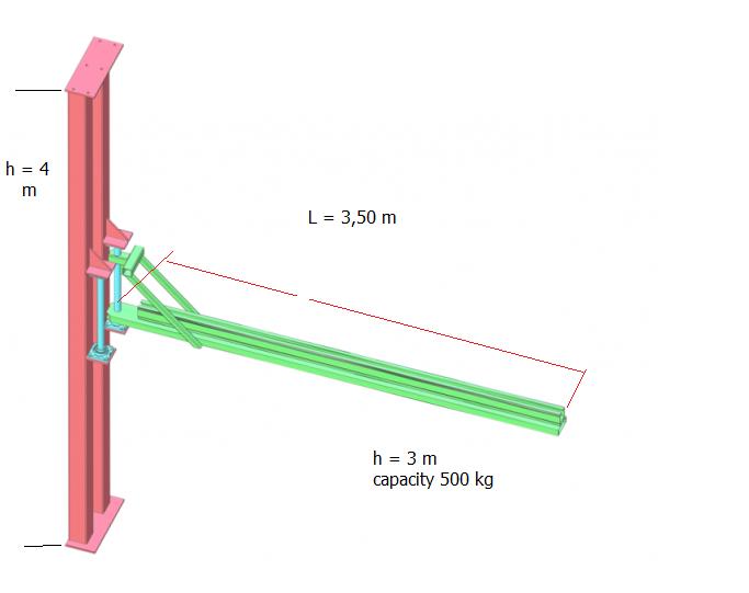

    Really! I'm sorry forgiaro but you keep changing the parameters and to add that the "floor is old and yielding". This is feeling unsafe at any speed or belief in being able to do it or not...It's just not right and common sense should prevail.
    The difference between 200 & 500kg for a system like this is SIGNIFICANT and who is to say that it won't be overloaded at some point in time, probably because you have no way to be sure what a weight may be above the 200kg or between those extreme (Maximum) values.
    I have made my recommendations for the vertical stanchion and how it should be attached with Strap Plates with no penetration of the concrete pillar. However with the "floor being OLD and Yielding" I no longer trust any of it to support such a system.
    These are the Wrong Calculators for this type system! Plus I barely read Italian, even with Google Translate!

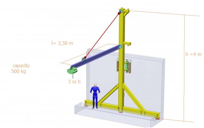

    pillar crane
    thanks for the suggestion I was sincerely buying the beams to H but I have been too many doubts, thanks again for the help, maybe if you would have pictures drawings with measures of homemade structures already made, you would do me great pleasure and courtesy, thanks again sorry if take advantage of your patience thanks again

    I don't want to be rude but you really don't want to be attaching such a load to any concrete column, especially one of unknown construction. At a minimal you will wnat to contact the engineer that designed the building in the first place. The potential for failure is huge. Further more this is a situation where you either buy a turn key engineered solution or do the engineering yourself. In most countries you will be legally liable for any harm done if things break.
    In the USA there are companies selling free standing jib cranes with the engineering already done, that includes the foundation requirements. This is the way to go if you don't want to engage in an engineering study yourself. Everything is laid out for you including rebar, stud requirements, hole depth, hole diameter and what ever else needs to be considered design wise.
    This is one of those DIY projects that really requires proper engineering to be even remotely safe.
