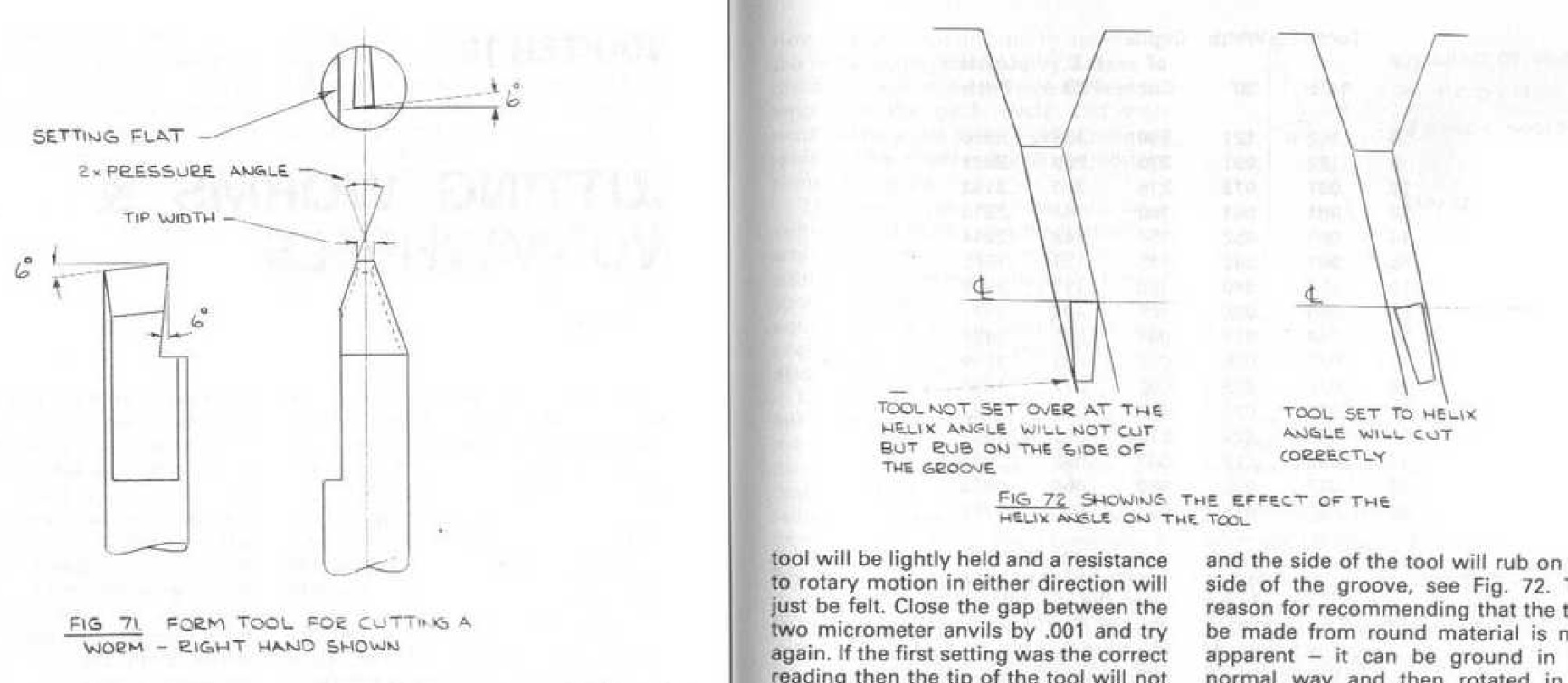

    Pic from Ivan Law's book "Gears and gear cutting":
    Help wanted with sanity check for a 40PA hob cutting tool-40pa-cutting-tool.jpg
    Background:
    To even grind the tool's helix angle and .73 mm front flat tip* of the turning tool as per the right pic above,
    I first need to design the entire hob - Right?
    Mod 1 hob formula for simplicity:
    OD of hob: 25 mm,
    DOC: 2,41 (Addendum 1 mm + Dedendum 1,25 mm & Hob root clearance 0,16 mm = 2,41, correct?),
    so at PI mm worm pitch (as it's Mod 1) and a 22,59 mm average dia of "tread",
    that would give med the helix angle: tan a = 1/22,59, or 2,53 degrees - right?
    If I'm correct above, it would be pretty straightforward to grind the tool by tilting its holder an extra 2,5 degs,
    but then checking its geometry in (say) a Shadowgraph it has to be held at 2,5 degs as in the pic above,
    and not be twisted so as to keep its top edge horizontal, i. e. not kept flat, as in a 40 deg angle gage...
    *A theoretially "pure", sharply pointed 40 deg 1 MOD cutting tool would have a 3,41 mm DOC.
    But this, with its 0,73 mm tip width (thus 1 mm ground off the sharp tip) should then only have a 2,41 DOC,
    to generate a generous enough "non-topping" hob.
    Any ideas/ corrections positively welcome!
    Wrong.
    The moment you have chosen the pressure angle and the diameter of your hob, you have set all choosable parameters. The pitch of the hob - if you choose to make a hob with pitch - is then the width of (a multiple of) one tooth at the pitch circle diameter - a derived quantity.
    Quote Originally Posted by DIYSwede View Post
    . . . then checking its geometry in (say) a Shadowgraph it has to be held at 2,5 degs as in the pic above
    Wrong again. Geometrically speaking, the transformation you need to do to get root clearance is called shearing, not rotating. The difference between the two is that in shearing, top and bottom surfaces of your tool remain horizontal; with rotating, they do not. Thus, if you view the tool in your shadowgraph, the cutting surface on which you focus has to be horizontal as well. Rotating the cutter, as your picture shows, is a crutch that can work, but, as your question shows, leads to misunderstanding of what happens during the hobbing process. By recommending this rotation, your book is leading you astray.
    Should you decide to make the cutter / hob without pitch, you need to build your tooling such that both hob and gear rotate in concert. A hob with pitch can be operated by and large without that constraint.
    To understand what I have said here, visualize the hob as a (rotating) broach. If there is no feed forward of the broach during gear cutting (i.e. the hob has no pitch), the gear shape is a direct copy of the cutter shape and not an involute curve. Thus, your milling machine needs to supply that feed forward, and it also needs to couple that to the rotation of the gear blank. But if you build your broach in the form of a screw, feed forward is part of the broach (a hob is another name for a rotating broach), and if you permit your gear blank to rotate freely, the hob will do the move forward action for you - just make sure to pre-cut the blank enough that the hob does not slip.

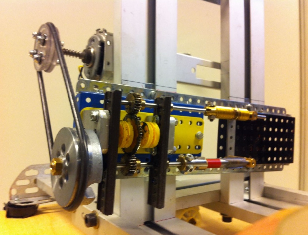

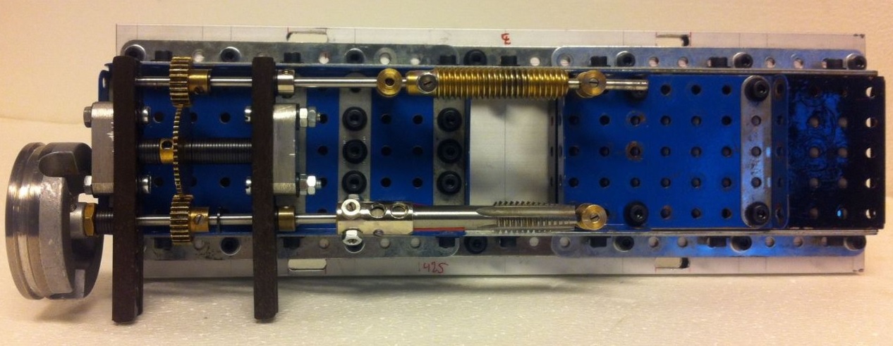

    Namely, to devise a cheap, operative and good enuff gear copying apparatus for (initially)
    three different modules: 0.5, 0.7 & 1M.
    Something like a bigger brother of this "old misdemeanor of mine", with a 1/2" x 12 Whitworth tap as a "hob":
    Help wanted with sanity check for a 40PA hob cutting tool-gear-cutter-frame.jpg

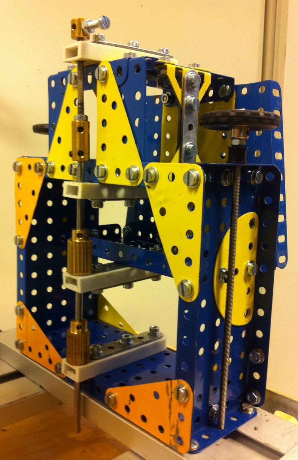

    "The mill" will consist of two (vertically spaced and parallel) horizontal, synchronized axles
    carrying a 25 mm OD bottom hob and a 25 mm top worm "lead screw".
    Same principle, but much flimsier -The "No Frills Meccano Gear Cutter" from a few years back:
    Help wanted with sanity check for a 40PA hob cutting tool-mecc-gear-cutter-assy.jpg
    Perpendicular to this, a horizontally moveable "table" carrying a vertical axle (holding a gear blank fixed at the bottom,
    and the gear to be copied on a free, keyed bushing, constantly meshing with the "lead screw" -
    allowing the liftable axle to move the blank upwards into and thru the hob, while rotating.
    The vertical axle will be slanted according to the hob's and worm's helix angle,
    and DOC radial feed thru the "table's" horizontal feed into the "mill",
    while axial feed is provided by merely lifting the blank's axle.
