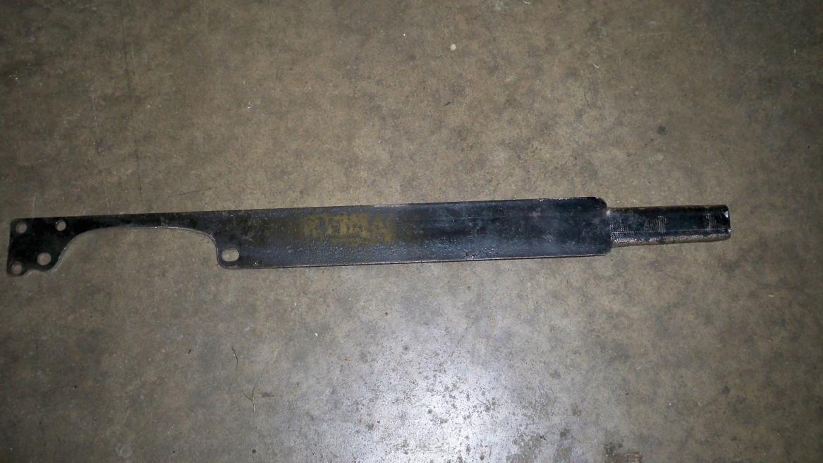

    Helping Hand
ID:	636 A quick and dirty tool I have used to hold a flywheel stationary while torqueing down the flywheel to crankshaft bolts.The holes at the ends of the arc take bolts where the outside ring of bolts for the pressure plate goes. It also will hold the rear universal piece on the rearend so I can torgue up on the big pinion nut. I don't have a hoist in my garage so I have to do this kind of stuff with the car on stands and me on my back. This piece of scrap metal has helped me considerably
