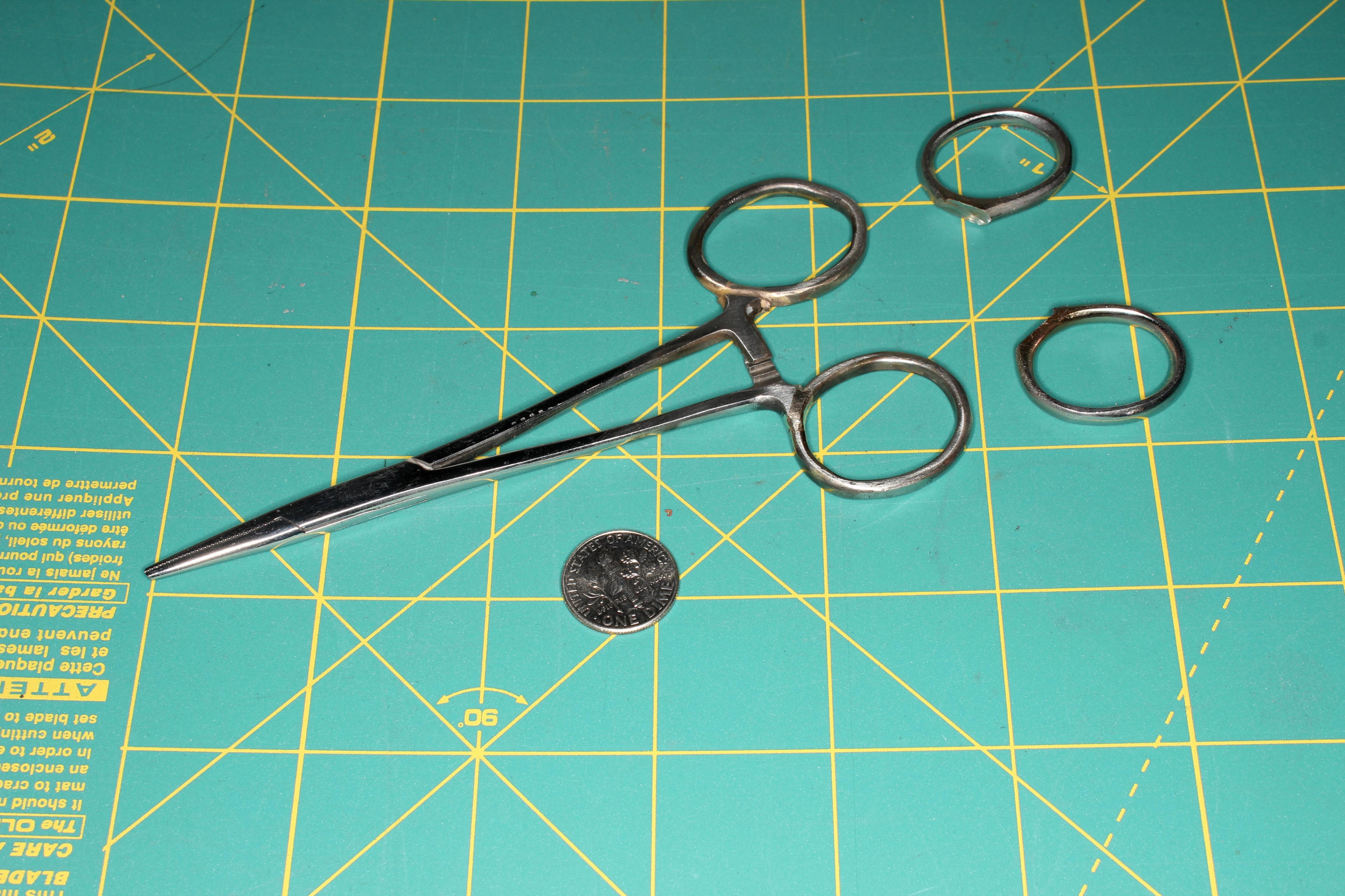

So I went to Ax Man Surplus today and picked up a 4” hemostat for my friend. It had tiny finger holes. I couldn’t even get my thumb and bird finger thru those little teeny holes. Imagine trying to use a lilliputian’s bowling ball the size of an orange, right?
I have a shop and some skills. As such, it is my higher calling and duty to rectify social injustices like hemostatic finger size discrimination when possible. So I did.
I made new finger holes of a size better suited to experienced manly digits. I made them out of 1/8” stainless steel welding rod. I silver-brazed the butt joints that made them rings, and then I silver-brazed the rings to the stumps on the hemostat from which I’d amputated the original, absurdly small, wimpy little finger holes. I’ll give the modified hemostat to my friend when we return to the lake.
Attachment 45815
