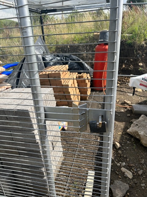

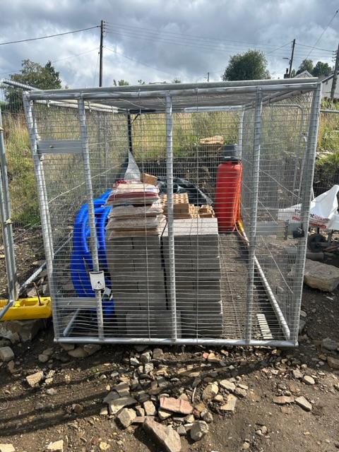

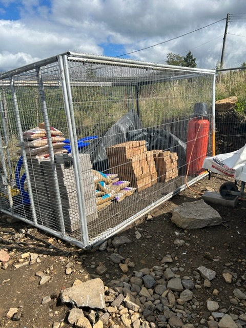

As we are all aware space is very valuable. Especially if it is a dry and secure. To help solve this problem and free up some space I decided to make, from bent and damaged heavy duty Heras fence panels a cage to store materials that are not weather effected but desirable if left out. Of course I could have purchased a commercially made security cage but the old panels, if not used, would have been destine for the scrap yard.

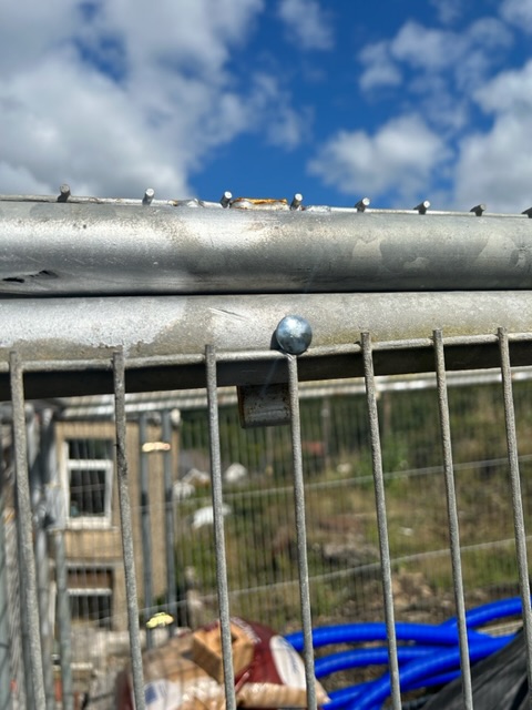

Construction of the cage is a nut and coach bolts through the tube and welded on tags. This made it easier to transported to site and erected. The door is hinged on purchased farm gate hinges and the lock is fabricated to accept a padlock. The base, is also a repaired heras panel.
The photos show the finished cage in place.
Attachment 45960Blocks, bricks, bags of sand and propane gas bottle stored in cage.
Attachment 45961Hinged end
Attachment 45962Fabricated lock with padlock fitted.
Attachment 45963M6 coach bolt holding cage together.
