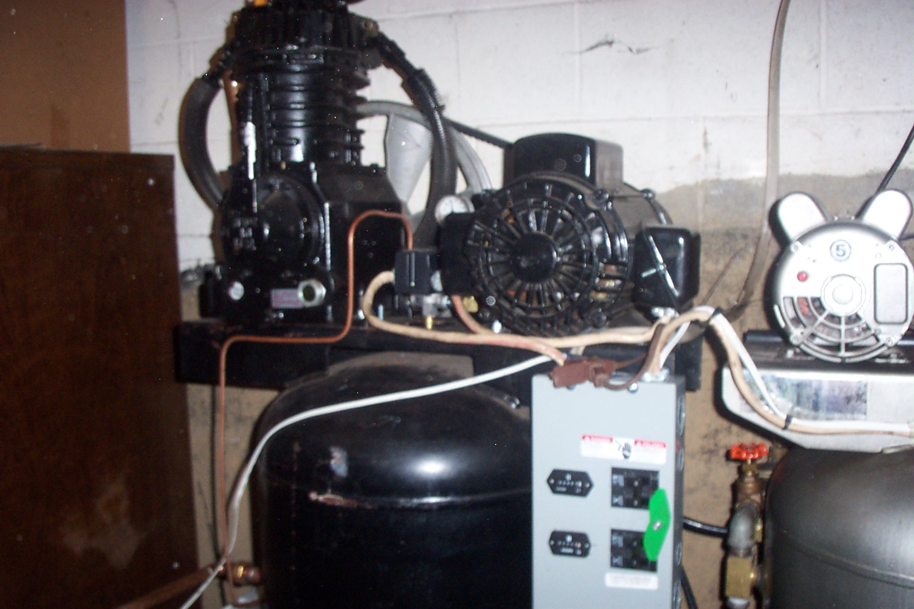

    Quote Originally Posted by chief36chevy View Post
    Here is a post that I added to hotrodders.com.
    New compressor

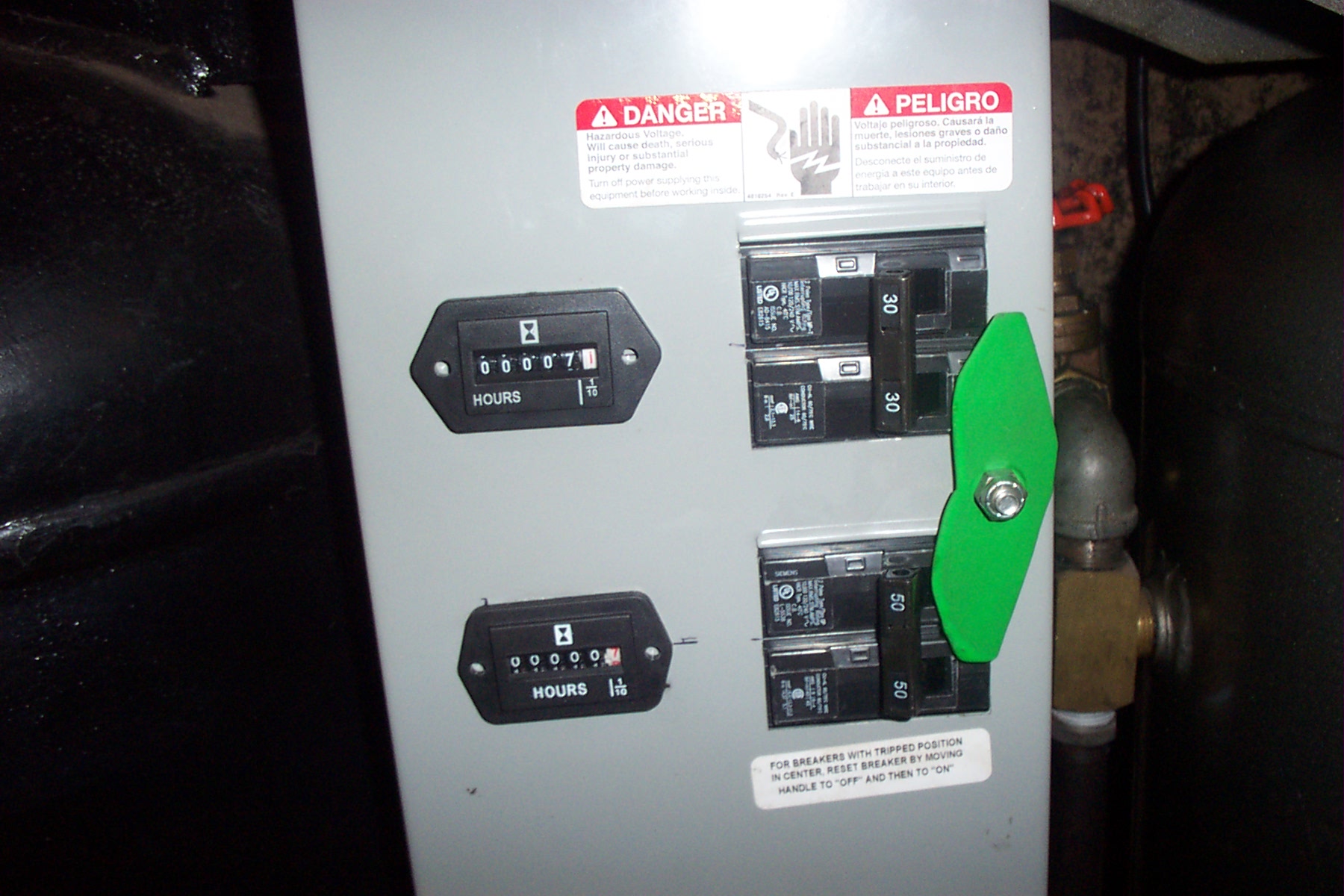

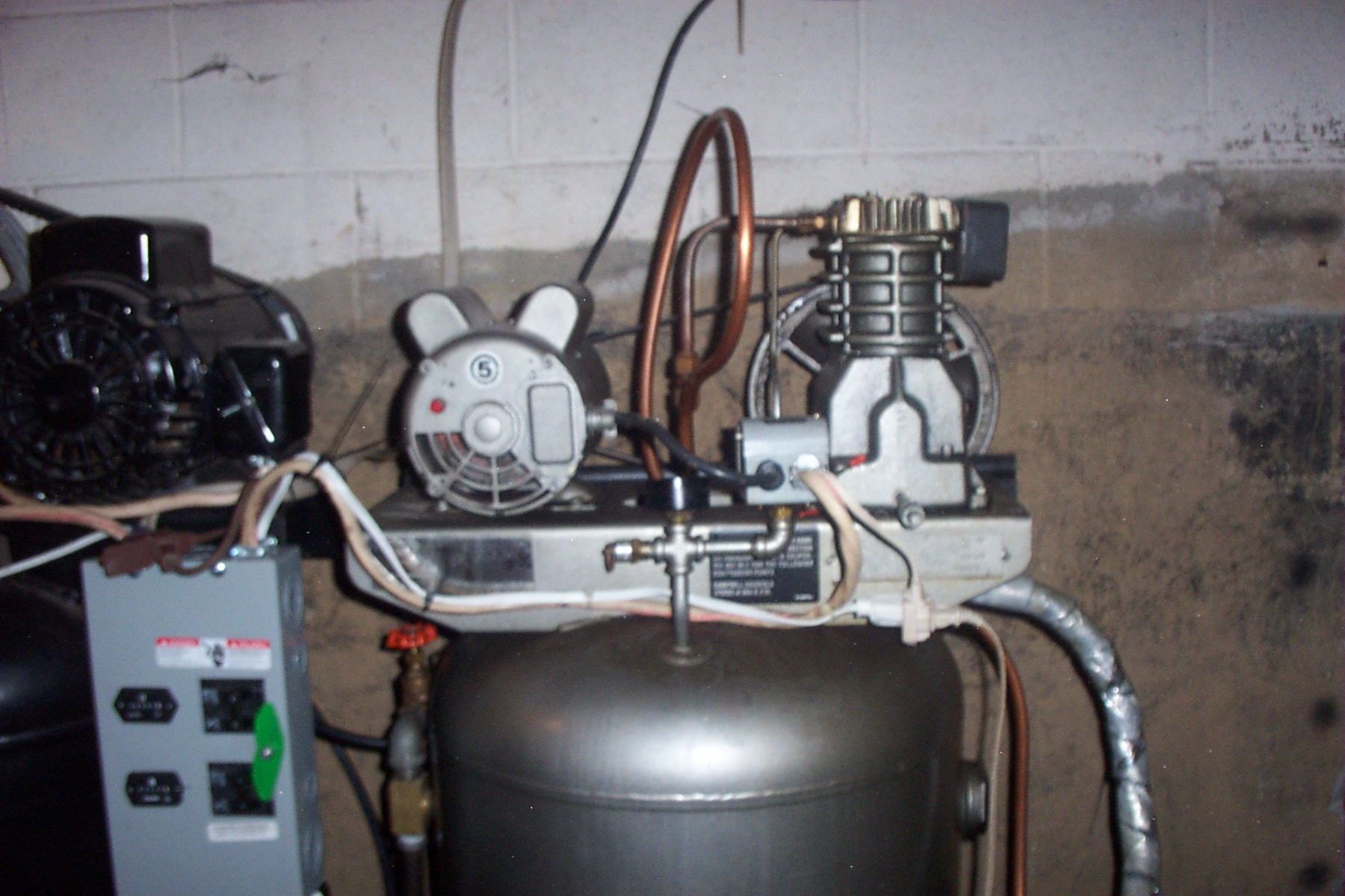

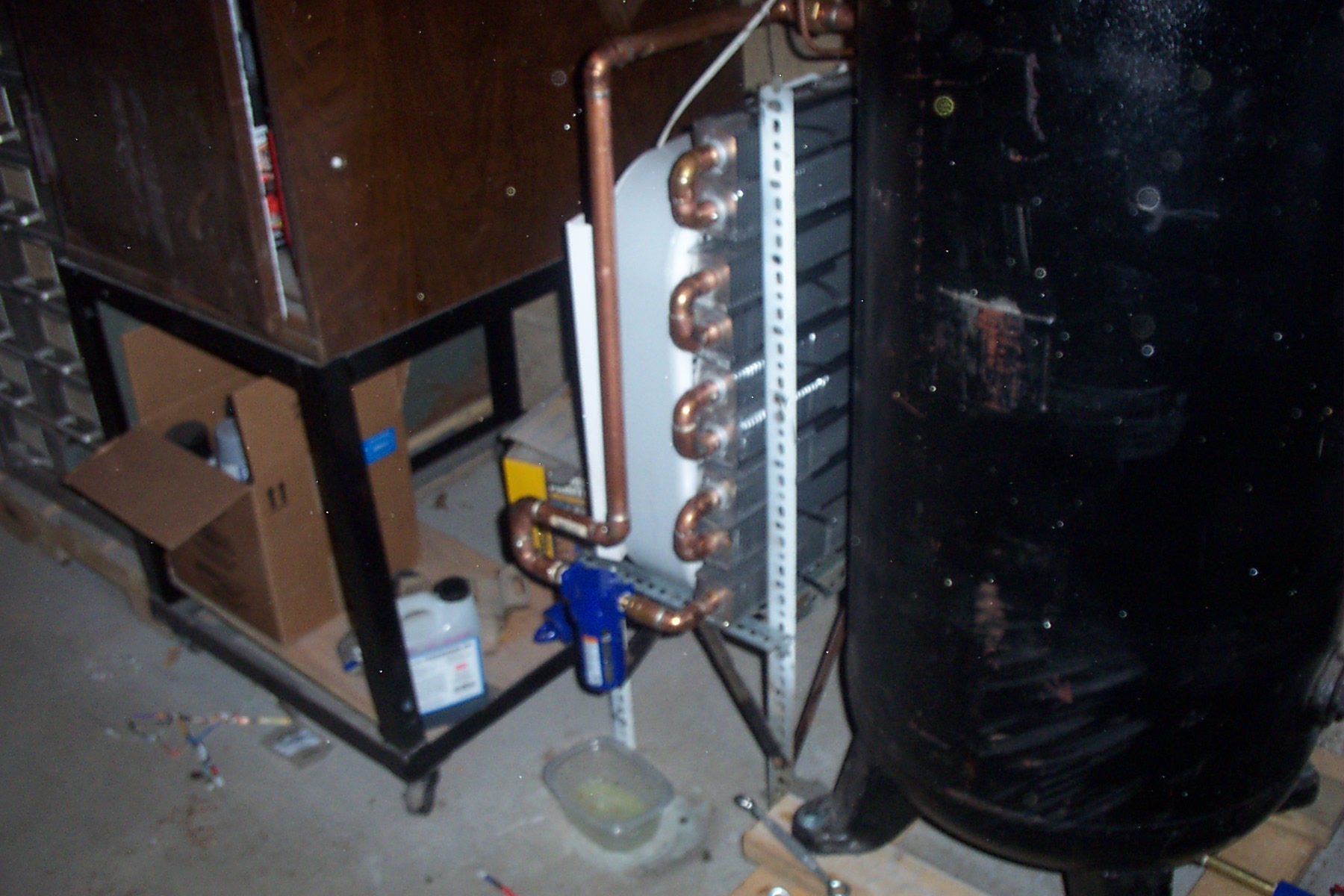

    I picked up this 2 stage air compressor off e-bay. I added an automotive AC condenser to my old compressor and it worked quite well, so I added the home made condenser to the new compressor. It is simple but effective. The condenser is on the unloader side of the system, and when the condenser bleeds off air down to about 5 psi the filter opens and spits out any water in the system. Thus the little container to catch the water.
    Since I kept my older compressor I installed a set of circuit breakers with a flipper between them so that only one can be turned on at a time. I also added the hour meters to keep track of service time.

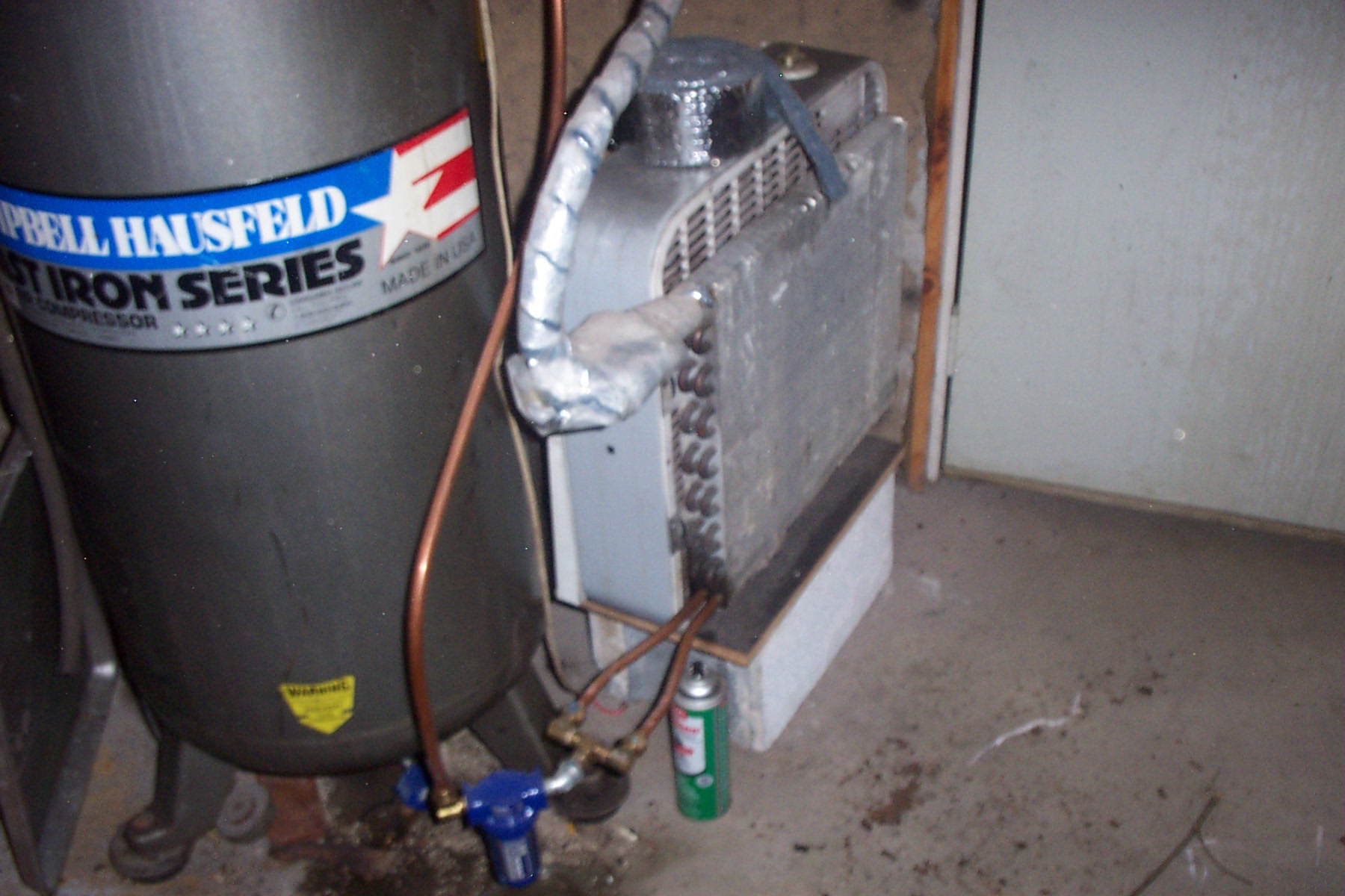

    What I used was an AC condenser off a car. I rerouted the compressor to tank line through the condenser and an air water separator I got at Lowe’s. I use the Lowe’s air water separator as at low pressure they will dump the water. I also added a 20” box fan to the back of the condenser and wired it into one lead of the compressor switch, so the fan would turn on whenever the compressor ran.
    I later bought a 2 stage compressor and built a condenser out of ¾” baseboard radiator tube.
    I can get more photos if needed.
    Attachment 14231Attachment 14232Attachment 14233Attachment 14234Attachment 14235

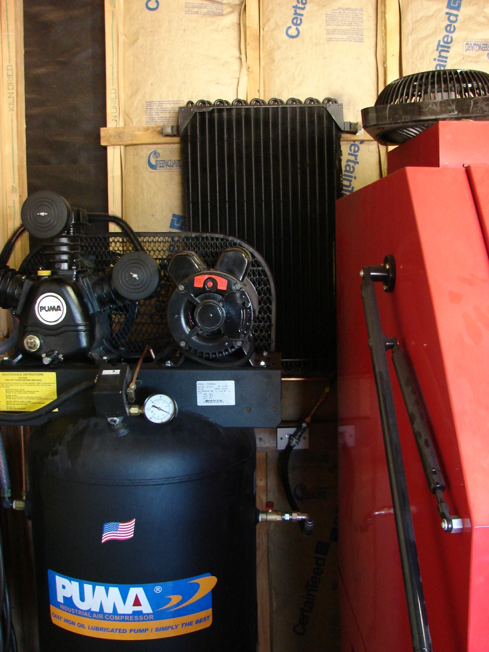

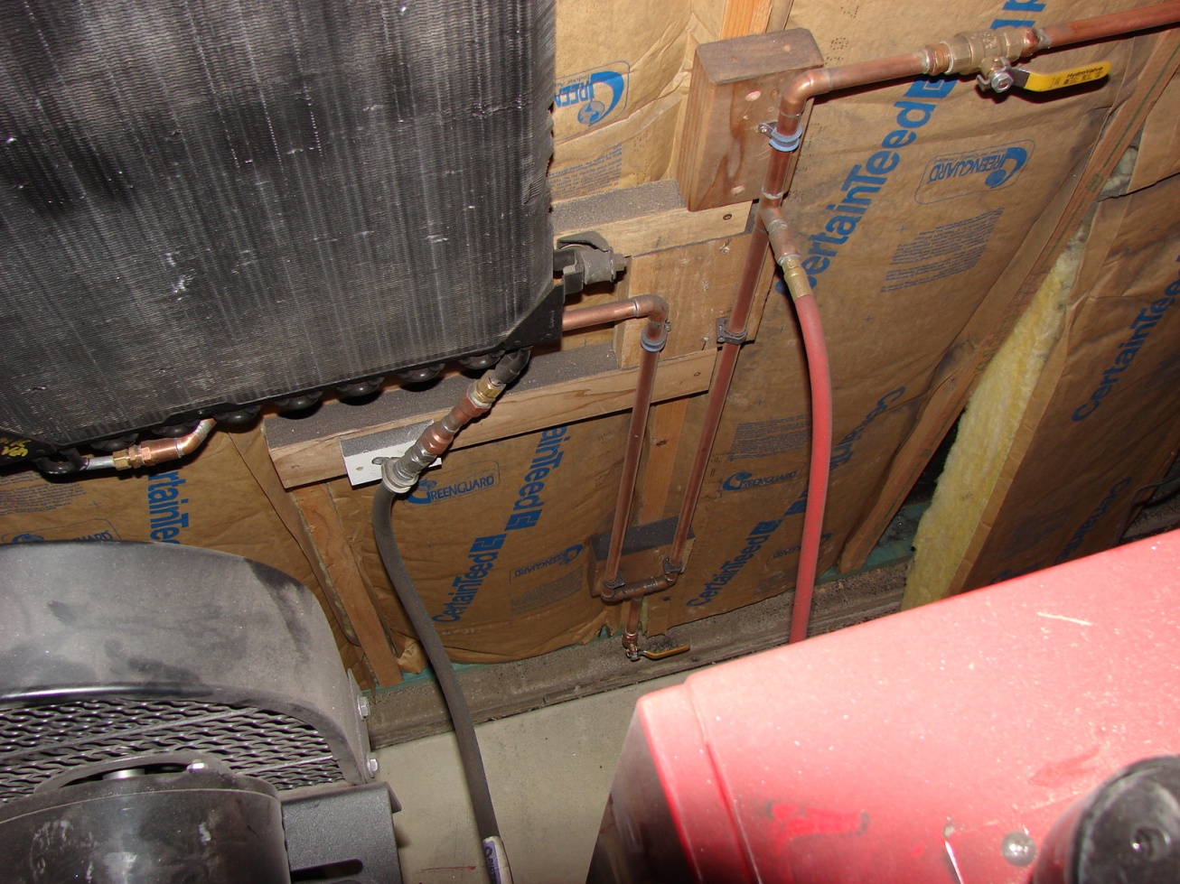

    I used an auto AC condenser and it works very well installed after the tank. Picked it up from a junk yard for 20 bucks and just needed two standard compression fittings from the hardware store to install it. I also use seperate water separators at the end of each line before any tool. The drop right after the condenser collects plenty of water but no other separator has seen even a drop so far and I've tested it over the entire summer. Some said a condenser would be too restrictive but I've had no problem with the blast cabinet or any HVLP paint gun I've used. I have an electric radiator fan that I thought would be needed but so far it doesn't seem necessary for the condenser. I mounted the condenser in line with the compressor motor so the fan could also aid in cooling it as well so I'll probably install it before next summer.
