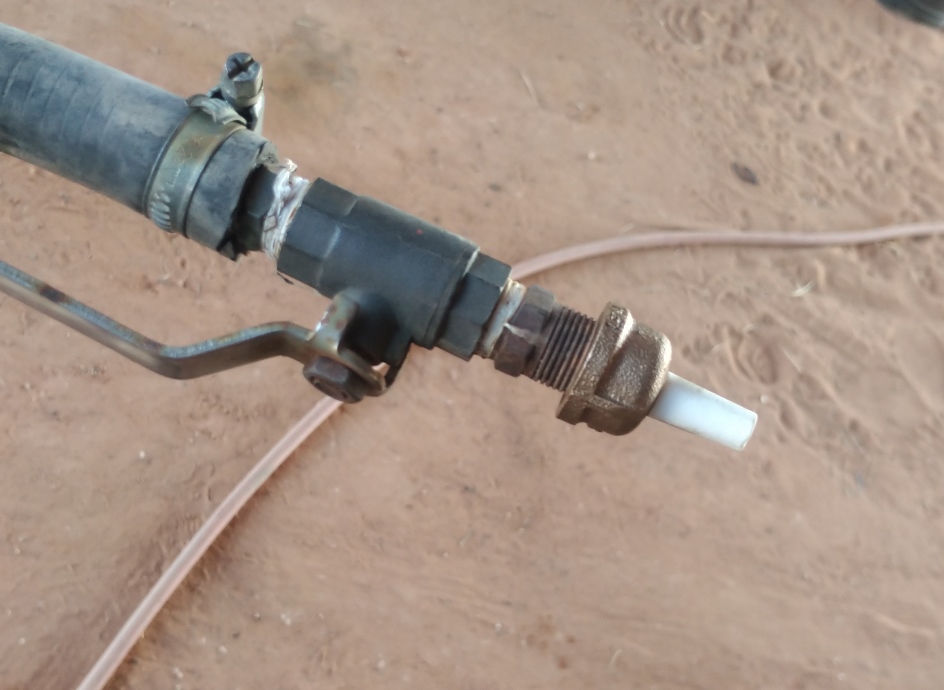

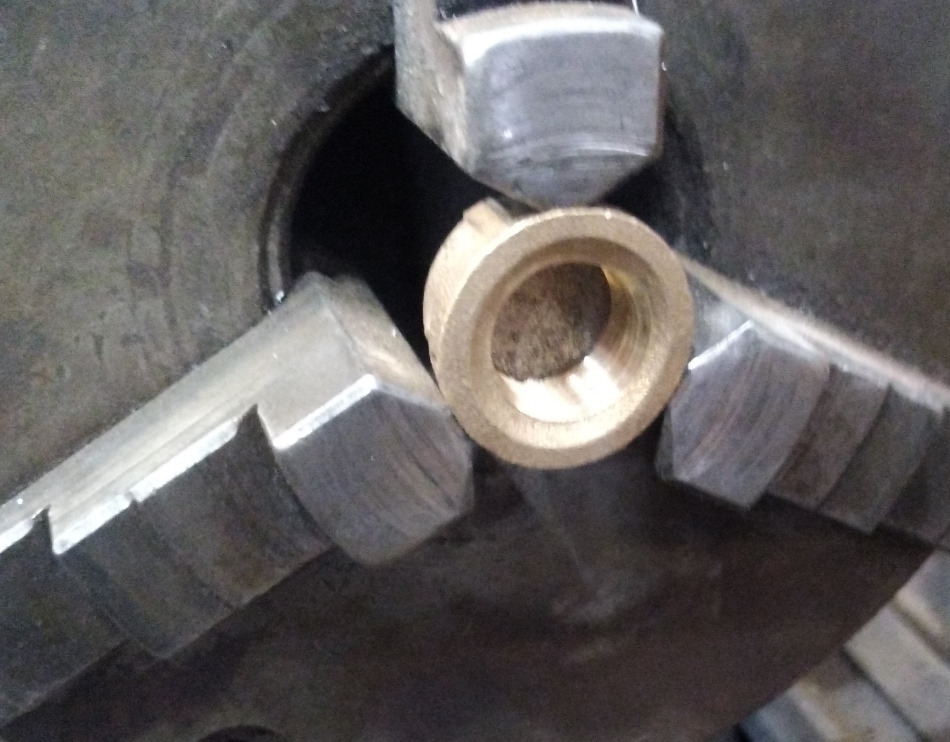

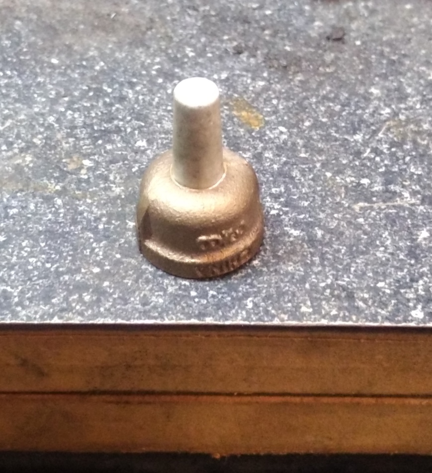

My little 8 year old HF sand blaster was in need of some repair the Hose had rotted way so I replaced it with a used Air conditioner hose off of a Mack truck the nozzle cap had gone walk about so I made a new one out of a brass 3/8 pipe cap by drilling a tapered hole in it
