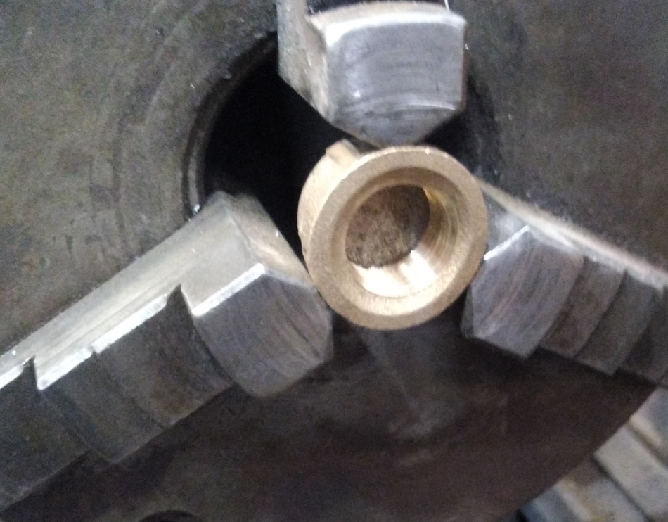

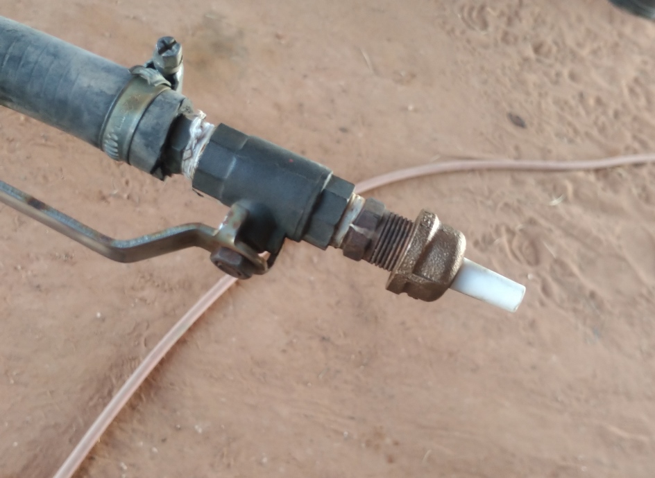

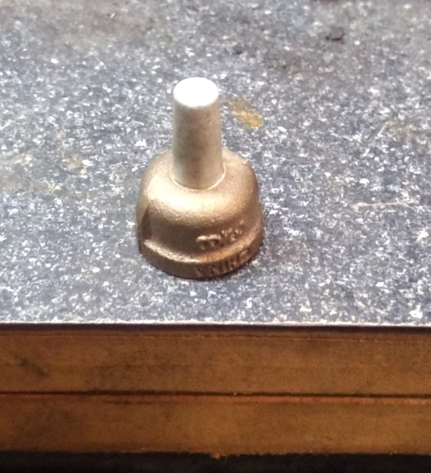

    My little 8 year old HF sand blaster was in need of some repair the Hose had rotted way so I replaced it with a used Air conditioner hose off of a Mack truck the nozzle cap had gone walk about so I made a new one out of a brass 3/8 pipe cap by drilling a tapered hole in it

    Great idea. What compressor are you pushing the media with, Frank
    12,615
    2,677
    Thanked 11,103 Times in 5,386 Posts
    Quote Originally Posted by TrickieDickie View Post
    This one
    Air compressor build in progress
    with this water trap
    Air system water trap
    The media that was in the sand blaster had been in there for 8 years. It was sifted play sand I blasted an old tractor wheel just to use it up and to tweak or repair any final things on the blaster that may have deteriorated over the years. When I start blasting the parts of our project I will be using Black Beauty to remove the mill scale
