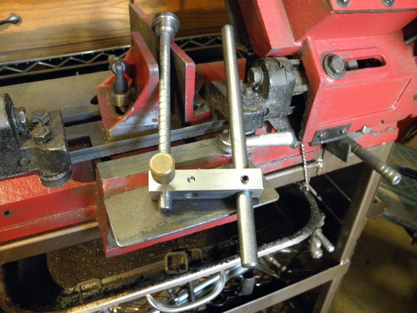

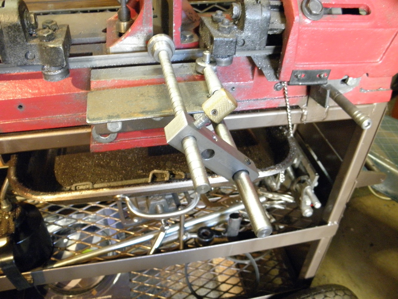

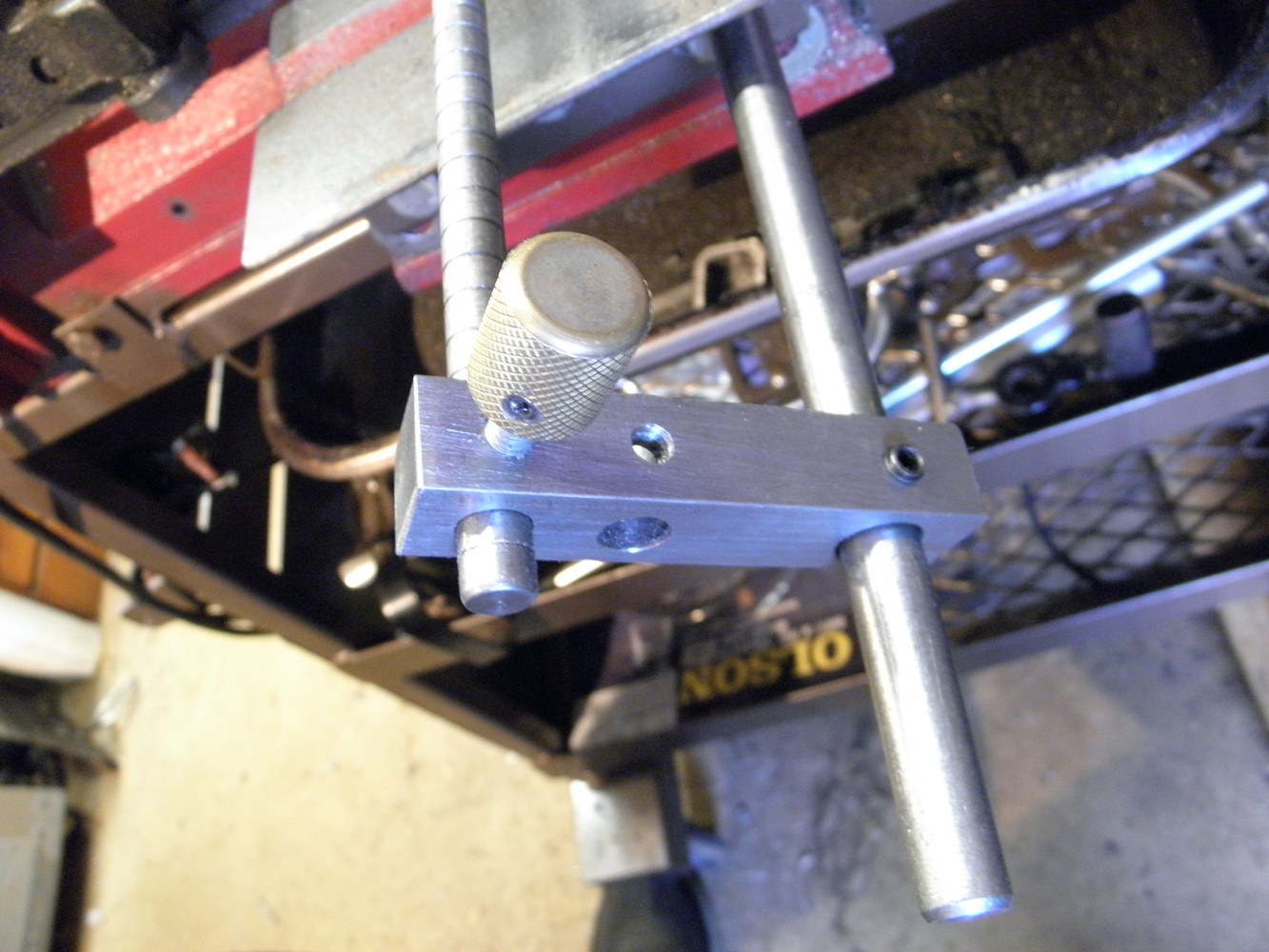

HF Bandsaw********Small Parts Stop*******MOD Made from 3/4 " flat bar, 3/8 " rod, 1/2" rod, 1" round foot and brass 1/2" thumb screw. 1/4" 20 all thread. I also cut a flat on the 1/2" shaft so the setscrew would seat properly.
