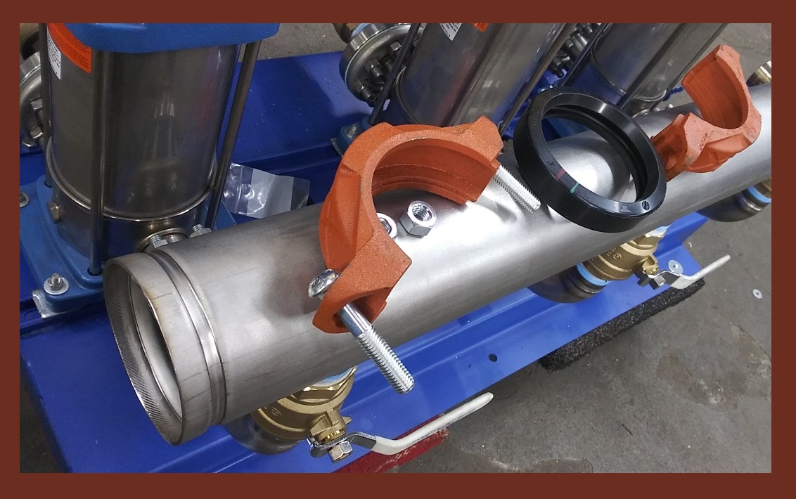

Another immensely used product emanating from WWII, you can't swing a dead cat without being near some. As the Navy established beachheads in the Pacific, an efficient method was needed getting various liquids, especially fuel & oil, ashore, and continuous resupply. Army mess had liked white gravy for SOS in that volume, no comment
Instead of welding pipelines, the piping clamp, rolled groove and seal were developed; it lives on today virtually unchanged as the Victaulic product line.
Works in carbon, stainless or copper pipe. I'm sure the heavy underground plastic also, but those grooved might have to be machined, metallic pipe is done with a 'groover', essentially opposite of knurling. Clearly visible to left in this terrific (sprained my arm patting myself on the back) photo, also visible are lips of the rubber seal. The 'carriage bolts' aren't square lugged, they are obround; more contact, less chance stripping the recess.
Attachment 44352
Seal? Sure does, main method of assembling fire sprinkler systems, high pressure, resistant to vibration, to stringent codes of life and safety.

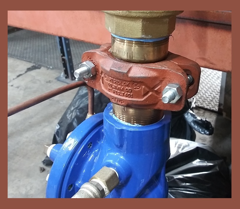

Here's one performing as a union; a close copper NPT nipple cut in half, grooved and joined by a Victaulic.
Attachment 44353
Both these are headers for transfer pump skids, built where I'm visiting in Los Angeles. Proud having mentored this young man, figuratively before his Dad even graduated High School. No wisecracks, he was born 8 years later.
