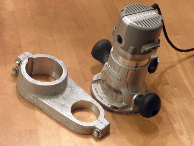

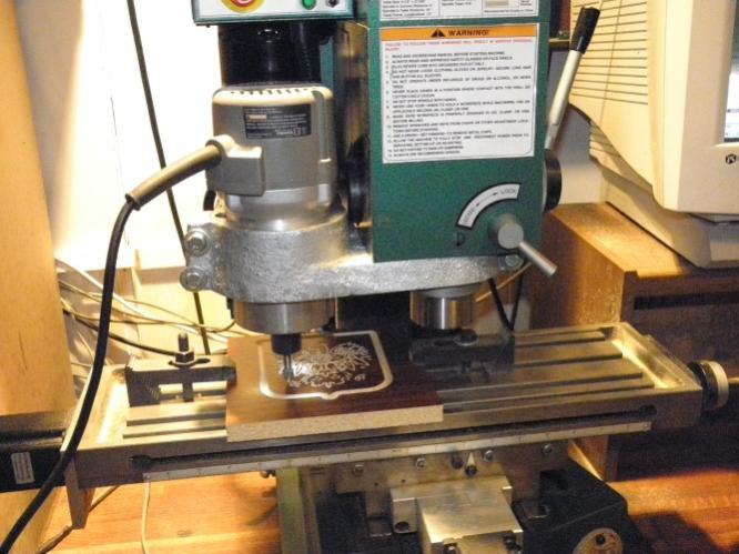

    Mount for attaching an auxiliary router motor to a CNC milling machine. Cast from aluminum and finish machined to fit.
    Here is a picture of the Craftsman router and finished mount before assembly.
    High Speed Spindle (Router) Mount for a CNC Mill-mount_03_finish_w_router.jpg

    I see that you made it to mill wood, but how will it perform milling aluminum?
  10. #8
    Supporting Member scorch's Avatar
    Apr 2015
    Oakdale, MN
    61
    9
    Thanked 148 Times in 33 Posts
    scorch's Tools
    Quote Originally Posted by owc View Post
    I think the mount will do fine with aluminum. It is really stout. I am a little worried about where the aluminum chips are going to go with the router running. There is a lot of airflow coming from the bottom of the router. I have a feeling there is going to be aluminum chips all over the workshop and potentially inside the router.

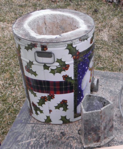

    The Gingery book is good. Another good source of information is Backyardmetalcasting.com
    I use the homemade refractory recipe that is on the Backyard metal casting site. I can't remember why for sure but I think the refractory in the Gingery book needed something I didn't have or didn't want to source.
    I use a steel crucible. It is made from angle iron and bottom plate that I welded together (Using a homemade welder of course.). I also have a smaller on made from welded together sheet (~.1 inches thick).
    My furnace is made from an old popcorn tin. It has pictures of snowmen and holly on it so it is pretty funny to see it in the yard during the summer.

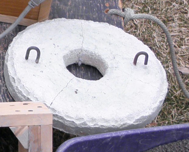

    (To get an idea of scale the furnace cover pictured below is 12 inches in diameter.)
    Picture of the Furnace and Crucible:
    Picture of the furnace cover (it is cracked but it is reinforced with "rebar")
