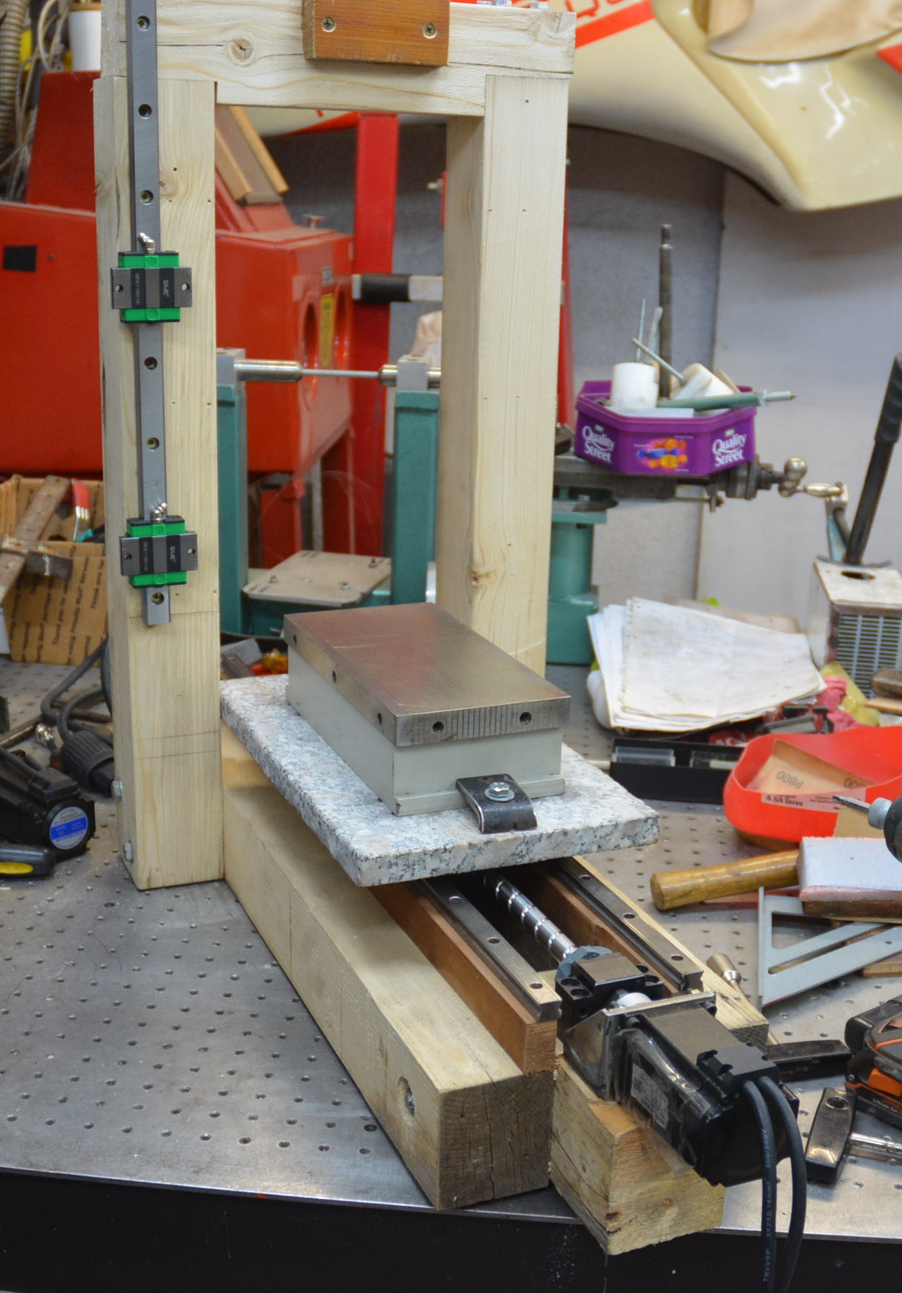

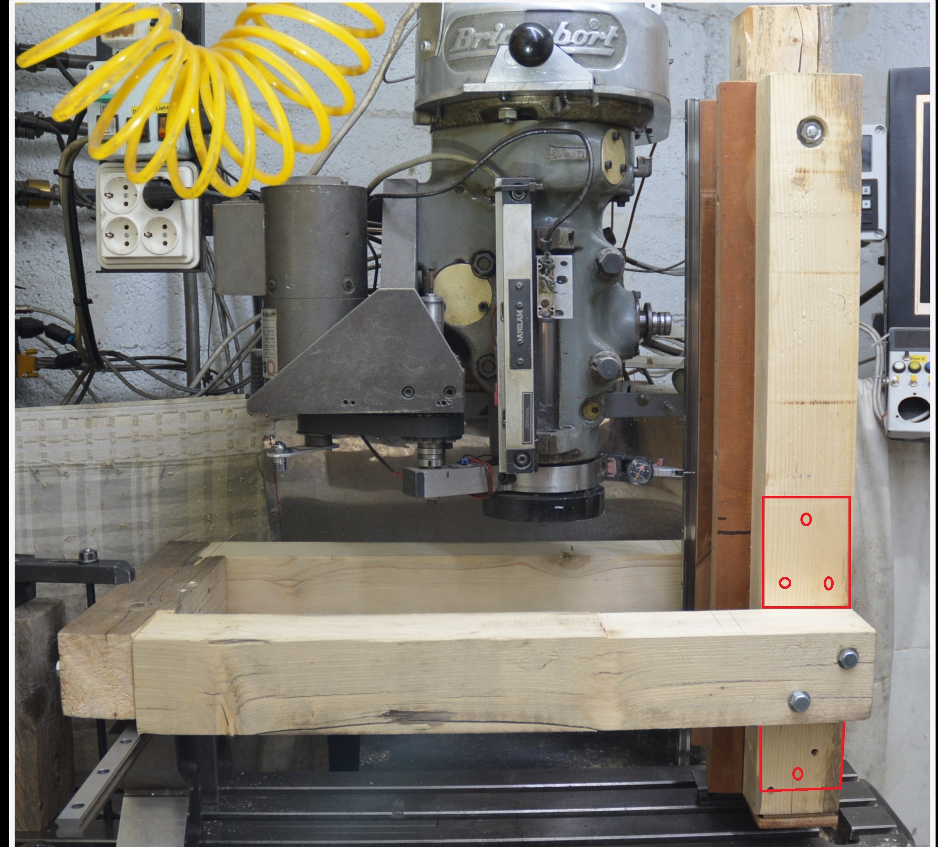

Not sure how you plan to bolt the vertical tube frame to the horizontal tube frame, but I would add two plates at the bottom of vertical frame as "T" to allow for the torque applied when shaping a tall piece of metal. Also leave sufficient grinding wheel clearance below vertical axis granite to dress the wheel substantially smaller.
I have no doubt you have thought of all this already.
