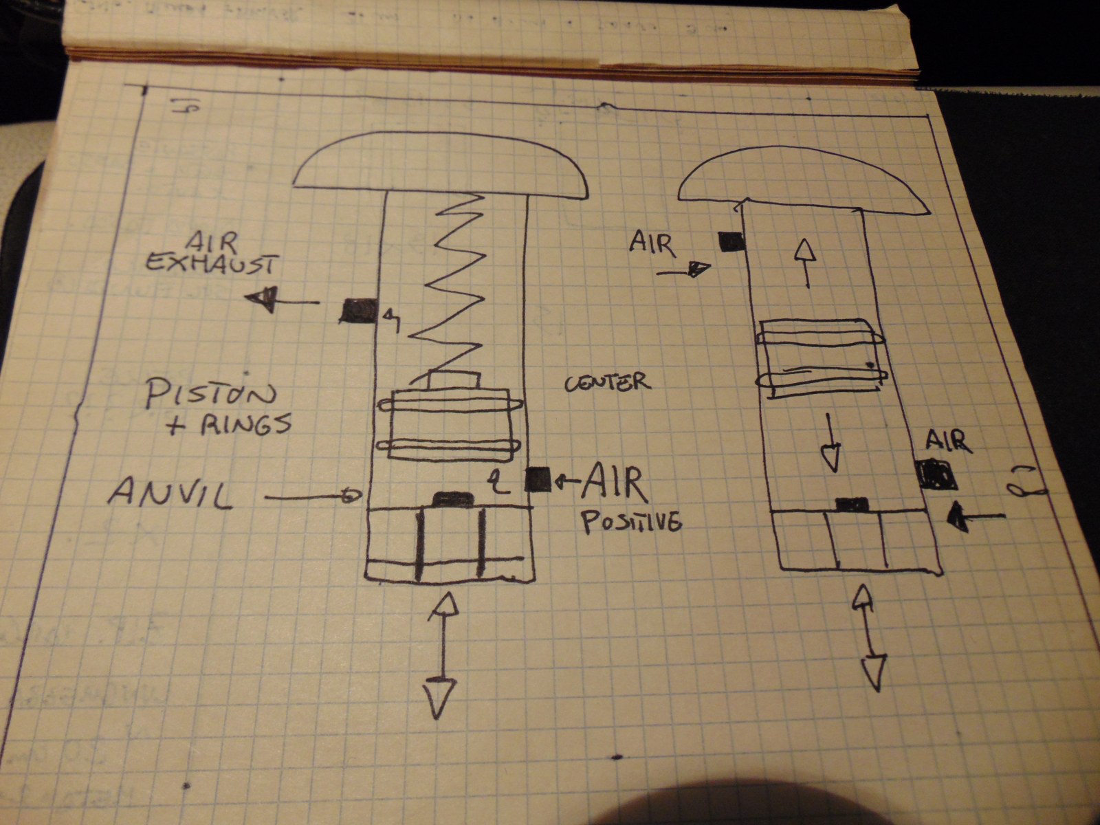

    Hi all!
    Someone has some good info about how this type of engraver is made?
    Thanks!

    At first sight it seems a piston that acts like an hammer. Looking the spring I would think that it works in depression. I remember this tool has a power unit with air flow control. It would be nice to try one!

    Quote Originally Posted by rendoman View Post
    I think your appraisal is correct. A miniaturized pneumatic hammer. I think a piston could be induced to reciprocate like a two cycle engine - where one port is covered alternately. Light spring operated poppets might work too, opened by piston impact, returning to a starting position triggering that poppet.

    Just out of curiosity, I tried drawing a couple of sketch.
    The left tool should should work with positive pressure, in few words a compression chamber and a piston, like you said a 2 stroke engine. According to this design I think the mass of piston, type of segments and force (plus centering) of the spring should be the key of the tool. At first sight I suppose it would be the simplest way, choosing the right size and pressure should be the hard part. I suppose the limit of this setting is the reloading speed, the spring should be the limit itself.
    The right drawing should be better and perform faster, if well tuned. A good comparison should be like a desmodromic valve system of Ducati against a normal spring distribution, it should run faster. I think here the hard job is the timing of the valve double air, send and return.
    Looking at the commercial product I found in the net, I think the first one should be the most used. I'm thinking about a way to built a simple driver unit to try
    What do you think about?

    Rendo;
    after googling the desmodromic actuation there are some positives. Doing it miniature may or may not be a challenge.
    So that causes wonder if a motor and valve train could be remote, running the handpiece off a hose? Handpiece could have it's own piston, delivering inertia to the graver. A light spring might induce rearward travel with each reduced pressure wave. Probably not feasible, but I've never considered how to run such a device.
