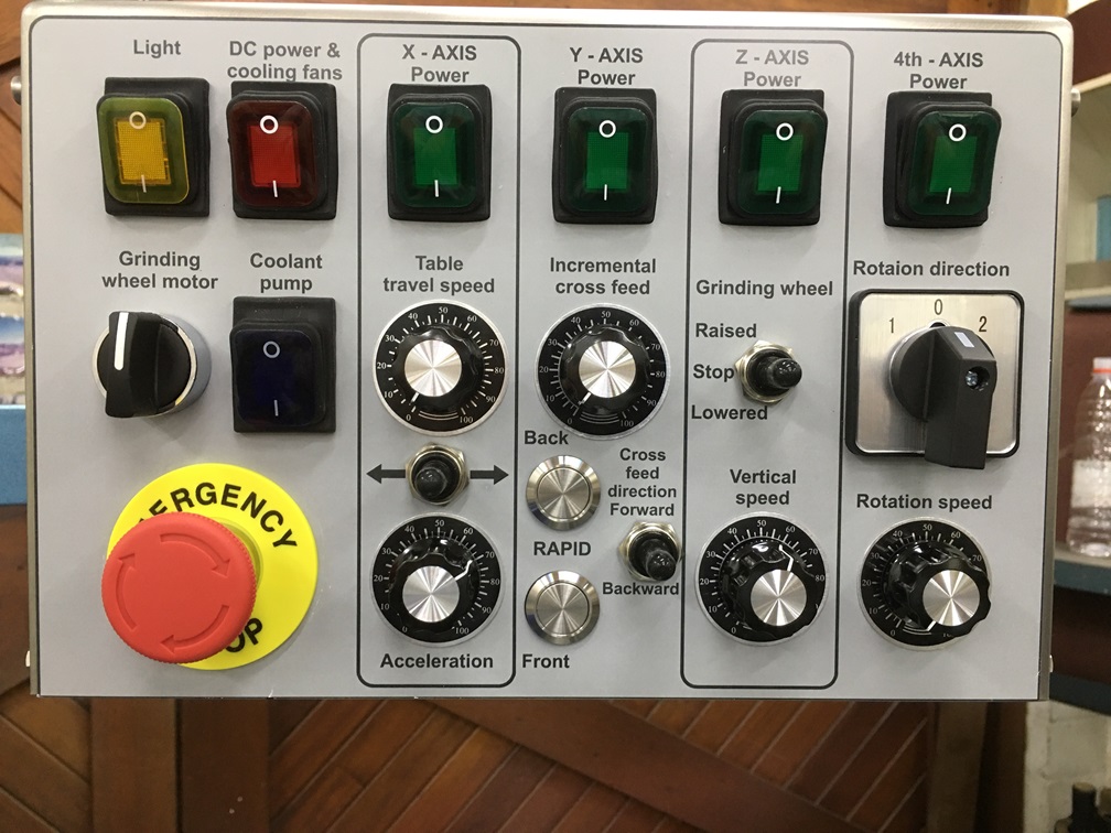

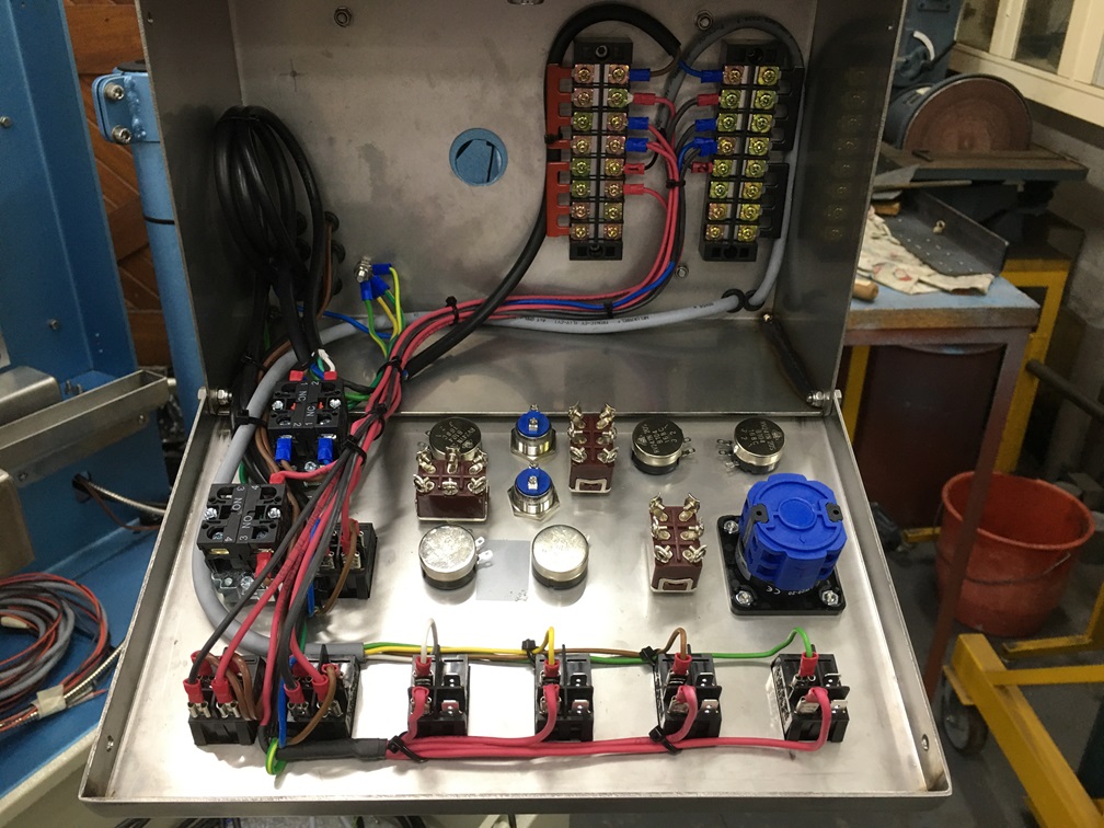

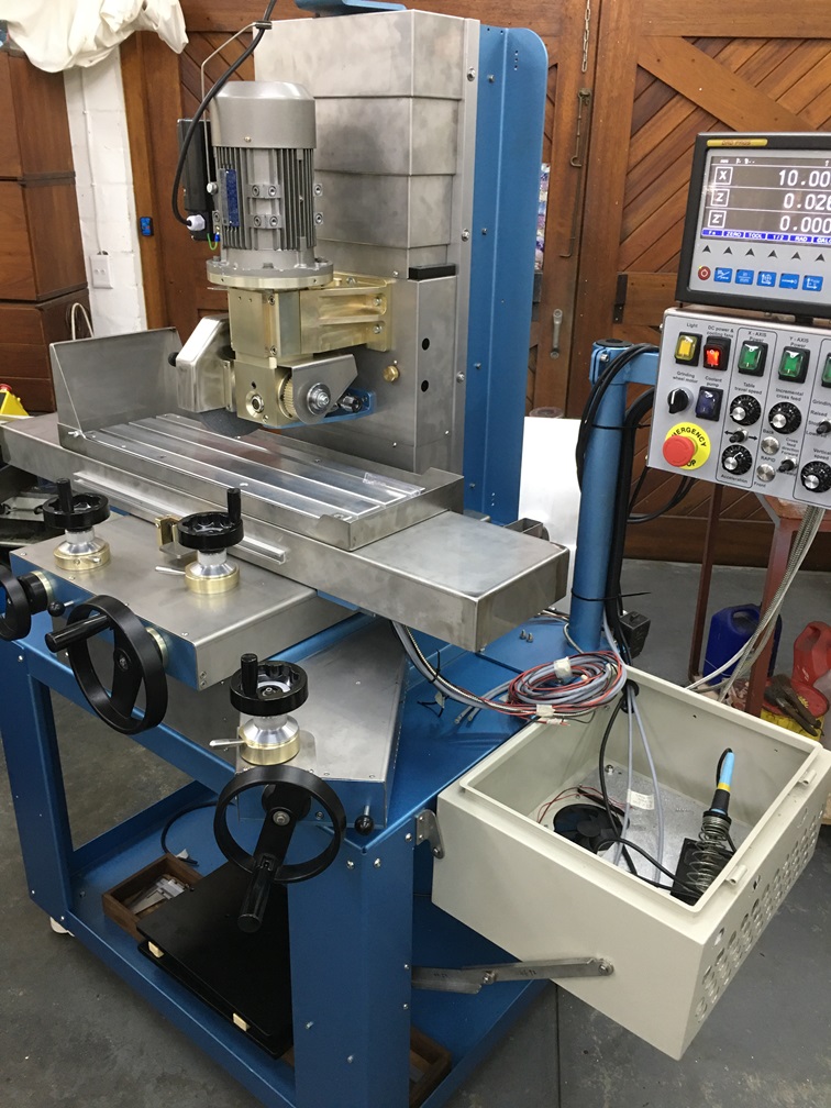

Albert: Could you post a picture of your control panel? How did you make it; anodize, engrave, silkscreen, etc? Thank you.
I drew up the panel face on CAD then had a decal made. In hindsight I should have sprayed a couple of clear coats over it before wiring it all up, as the printing wears off fairly easily if you rub it.
I made both the panel and box cabinet housing the drivers & power supply, with hinges to make working in them more comfortable.

Albert,
Considering the effort that you put into this you must be really annoyed with the mis-spelling in the 4th axis column. Many years ago I had a batch of Tee shirts made with a spelling mistake and I hated it.
On some projects I have made face panels by simply laser printing on to adhesive backed paper and sprayed a couple of coats of clear as you mentioned. Recently I have used a laser engraver but that tends to limit the colours. You need light coloured lettering on a dark coloured background. I paint the panel white to start with and then followed by black. The black absorbs the laser light and burns off, but the white reflects the light and stays intact.
