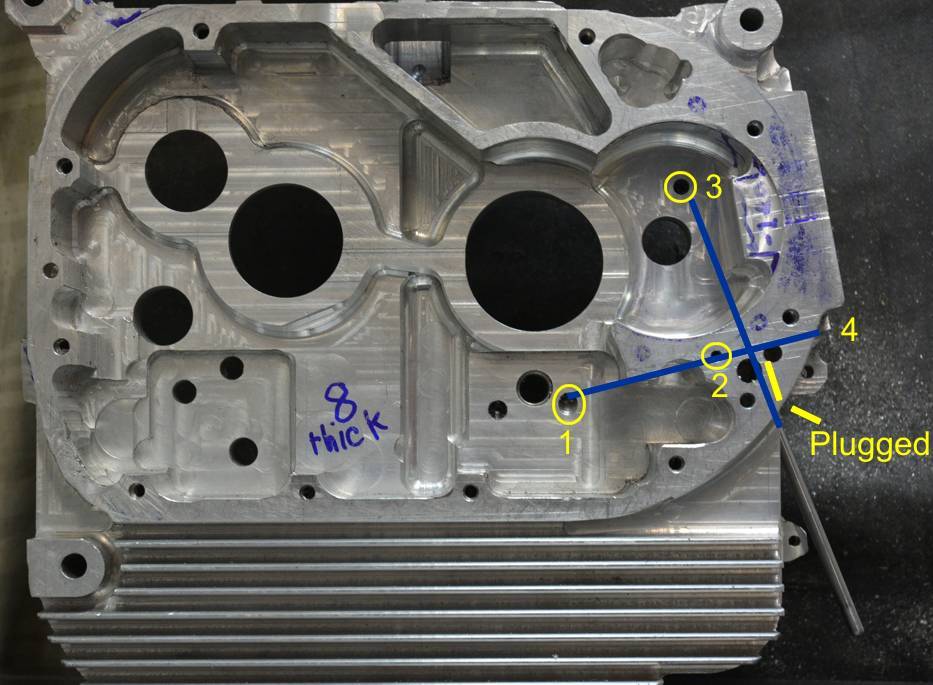

I have a CNC Bridgeport and so you would think that CAD would be essential but my stuff is either 2 or 2.5D and for simple stuff I use the MDI interface, for not so simple stuff I hand write G-code and for more complex stuff I write dedicated software that outputs the G-code. Today for example I made what I hope will be an improved design of gun for my bead blaster. It required linear and circular interpolation, boring and thread milling. That was all done via MDI and the whole job was far quicker than if I had taken the CAD/CAM route. Here is a work-in-progress example that had some roughing done manually and the CNC work was from hand coded G-code.
Attachment 46738
