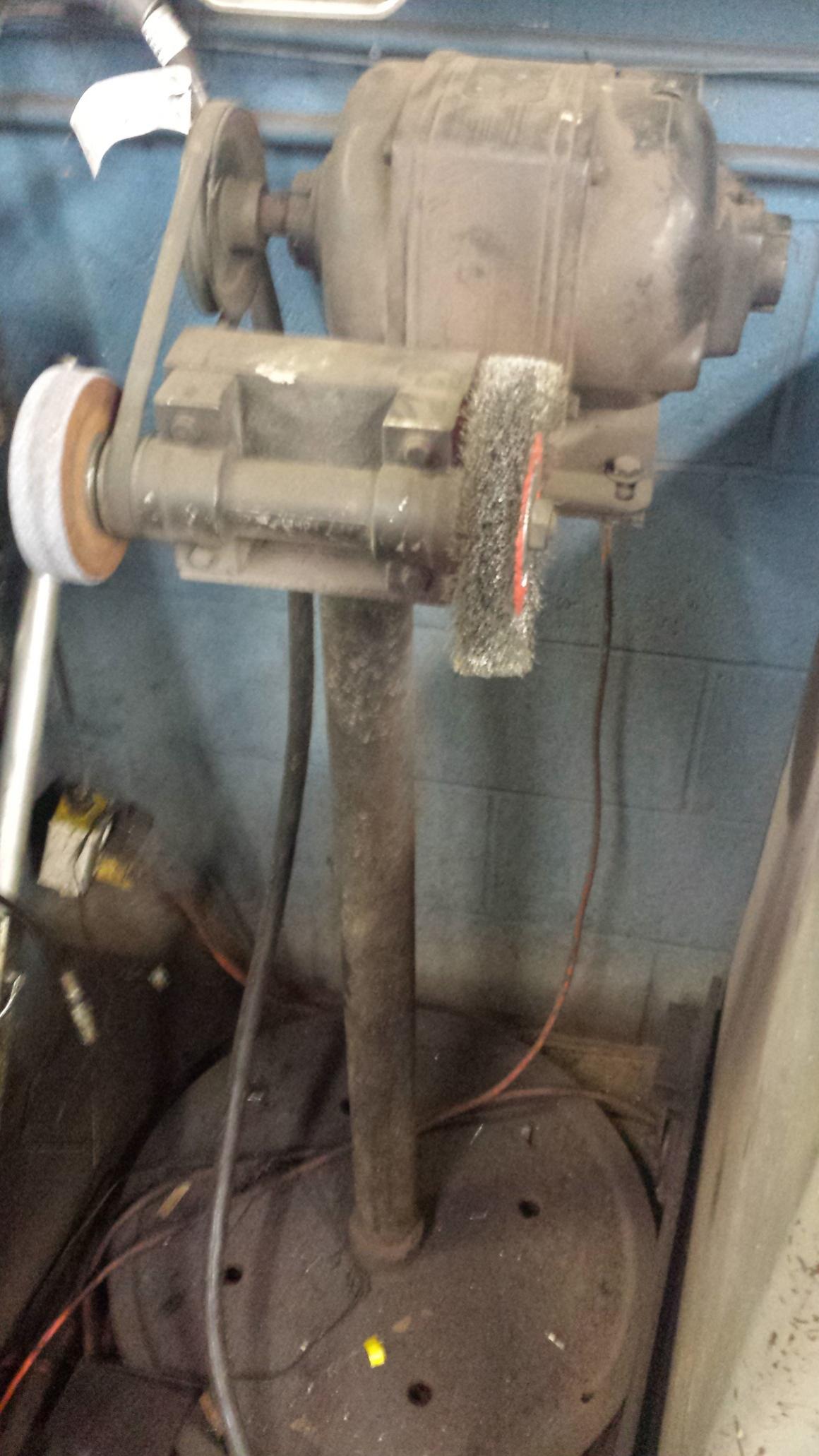

    I needed a heavy duty grinder that would not slow down when grinding pieces for welding or cleaning rust and scale off. It has a heavy old 1/2 HP electric motor. I purchased the arbor assembly from my hardware store.
    The base is a flywheel from an old buzz saw welded to a 3" pipe.
    I made it 20 years ago and have not had any problem with it.

    That thing has serious injury written all over it. You may have been lucky for 20 yrs, but it will catch up with you one day.

    I have been meaning to build a cover over the belt. The belt is short and motor is close to the arbor.
    The rpm is the same as a commercial grinder. There are no tool rests to catch your work on. I mainly use the wire wheel, the grinder gets used to smooth burrs off and to round edges. The belt is the only safety concern I would have.
    But I do appreciate your concern.
