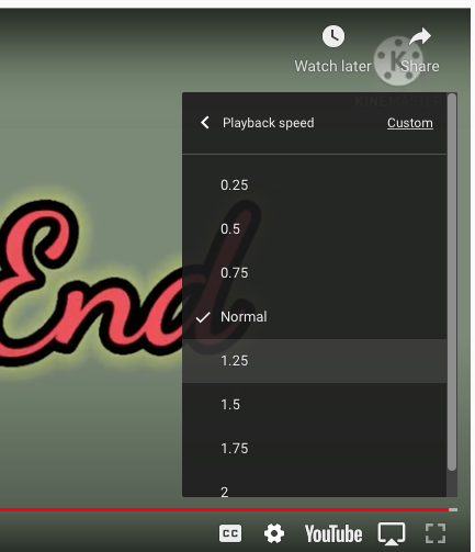

Frank, How do you speed up the video?
Ralph
Click the gear icon, select 'Playback Speed' and select your speed:
Attachment 40285

Oh, you are watching it on YouTube, on homemadetools there is no gear icon.
Ralph
