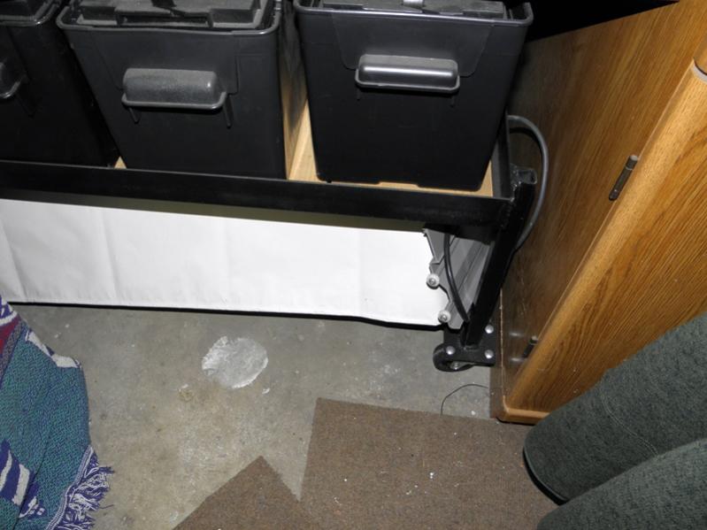

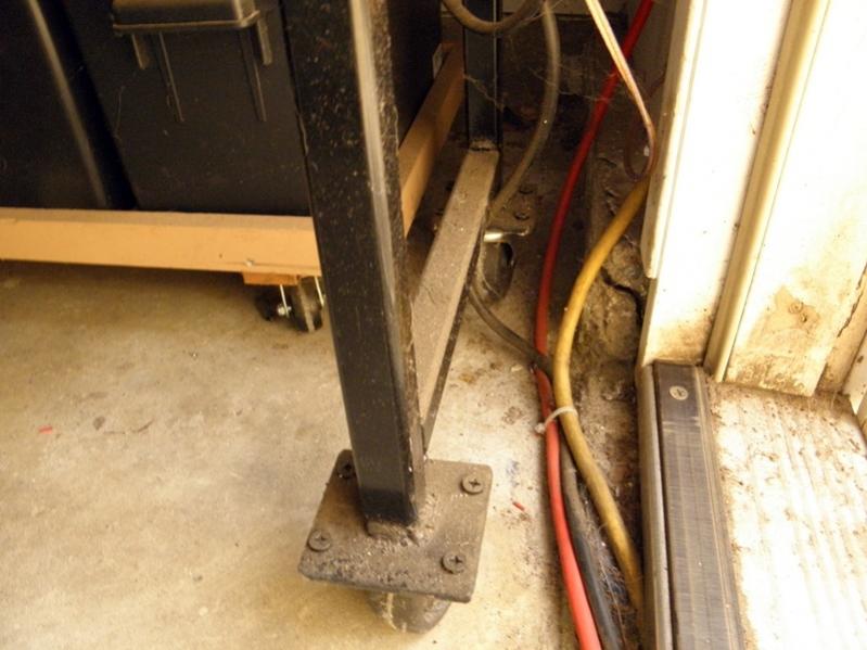

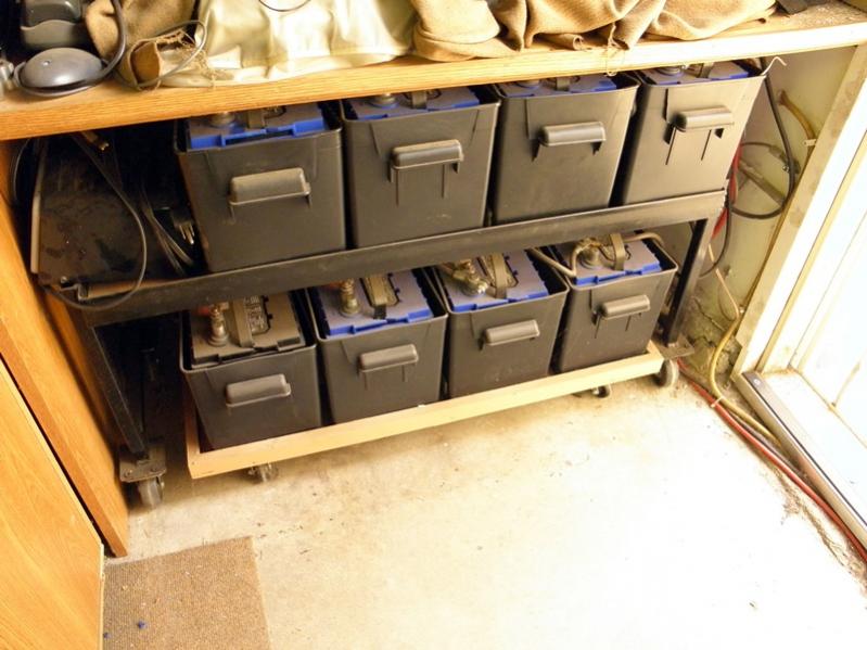

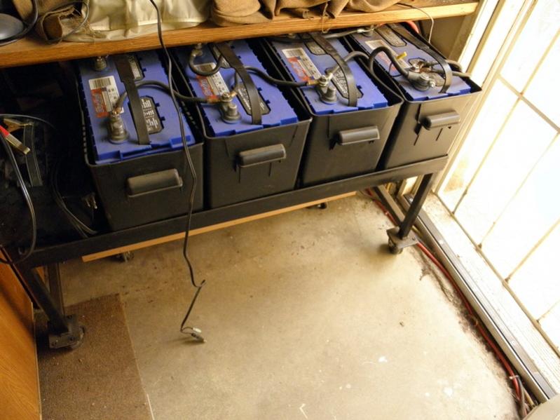

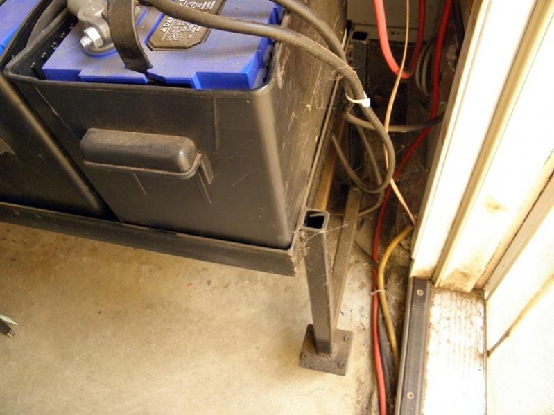

Home made moveable Solar battery racks, Constructed and welded of 1 1/2" angle steel, 1x1x1/8" square tubing 1/4" steel plate for wheel mounts. These racks hold 4 large RV battery's each.
Attachment 2333Attachment 2334Attachment 2335Attachment 2336Attachment 2337Attachment 2338
