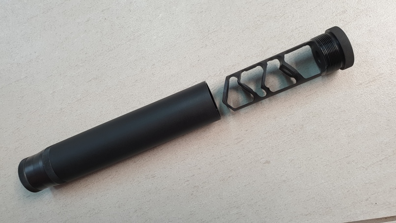

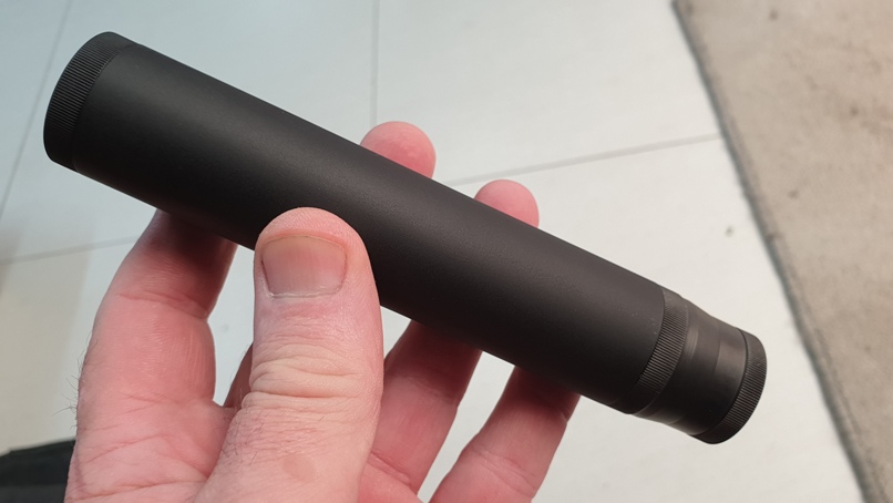

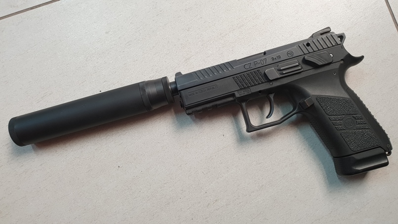

Experiment No:1 on the milling machine done. Made a monocore for my 9mm suppressor. This was done by eye with barely any measurements taken. Basically just cut 30°, 60° and 90°. Will have to go down to the range and see (or rather hear) how effective it is.
It still uses the same Nielsen Device, but does away with all the loose spacers and baffles inside, making it much easier to clean. I also shortened it a little as the first one I found to be a little long.

Ok now that all of the clap flap is over and done with.
There is one question I've not read either asked or answered.
My limited experience with various sound suppressing devices attached to a fire arm has shown some to reduce the muzzle velocity by varying amounts some to the point of a noticeable amount of additional recoil felt in the weapon also greatly reducing the foot pounds second or meter kilograms seconds in your case. greatly altering the anticipated penetration depth of a particular round.
have you had a chance or inclination to preform any tests which could offer you a determination of a round's effectiveness striking the target.
Accuracy is always a primary concern but you seem to have managed to be able to dial in a predictability to that issue. I might add in a most intriguing way I'm trying to remember if or where I had seen that method before.
Bear in mind I make no claim to be a gunsmith even a novice one even though I have repaired my fair share of fire arms.
