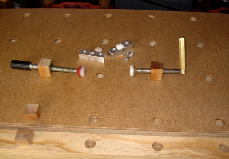

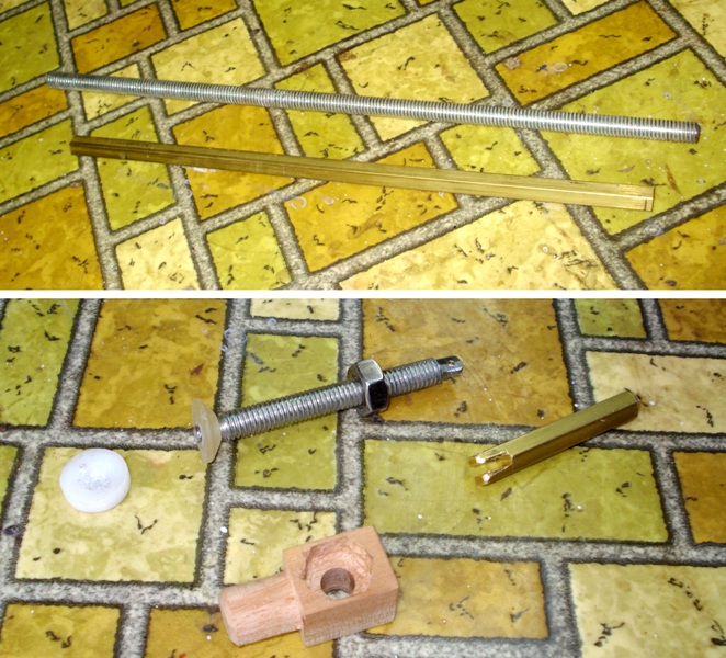

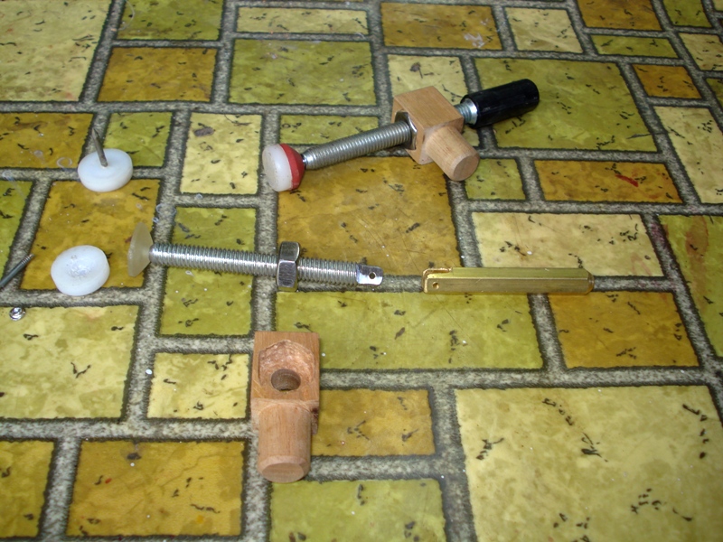

Inspired by these clamps, after I made the http://www.homemadetools.net/forum/c...ench-dog-53495, several modifications were to follow:

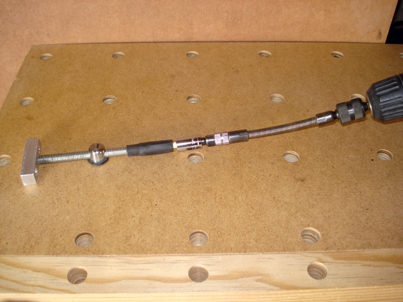

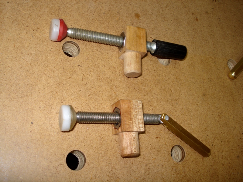

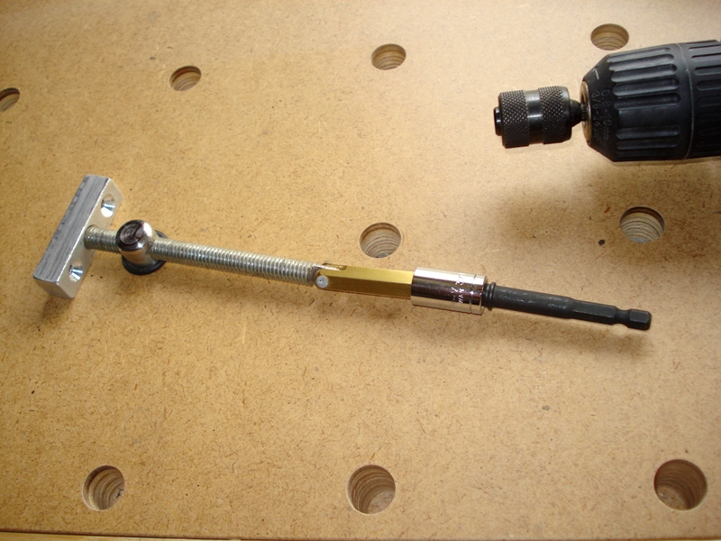

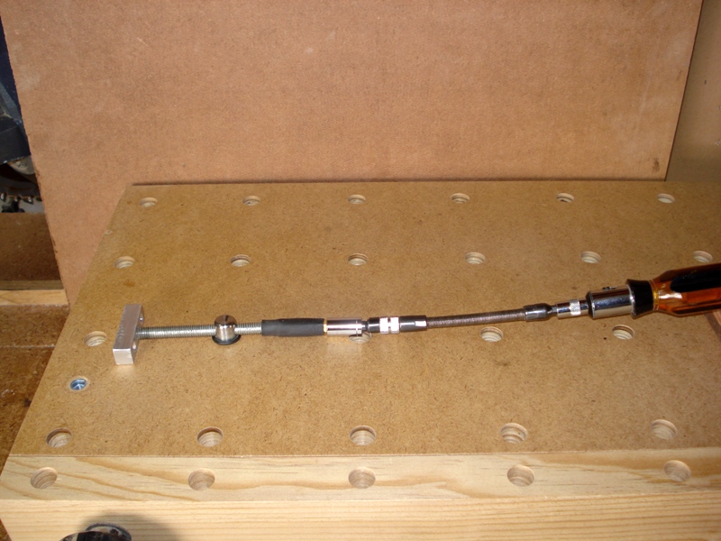

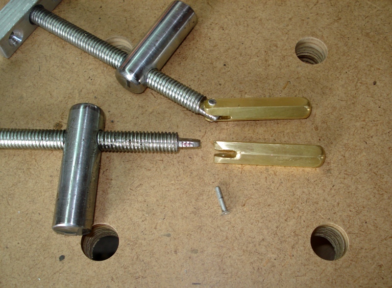

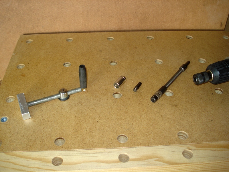

1- The first change was the addition of a swivel handle. I used 3/8” (16 TPI) threaded rod, and hexagonal brass rod.
Attachment 14786
Attachment 14787
Attachment 14788

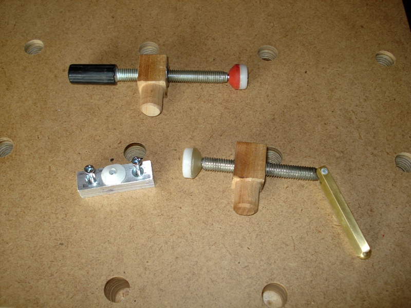

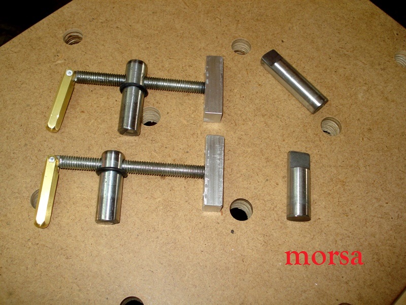

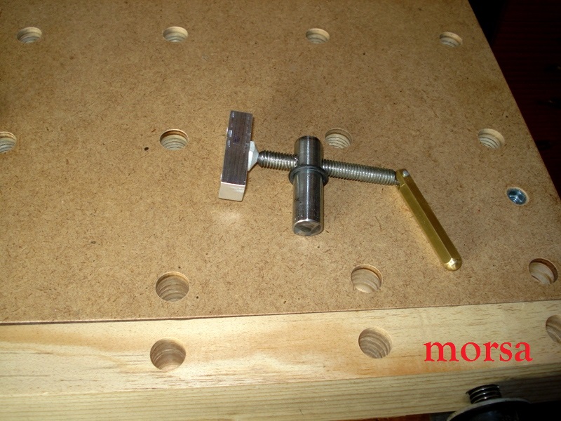

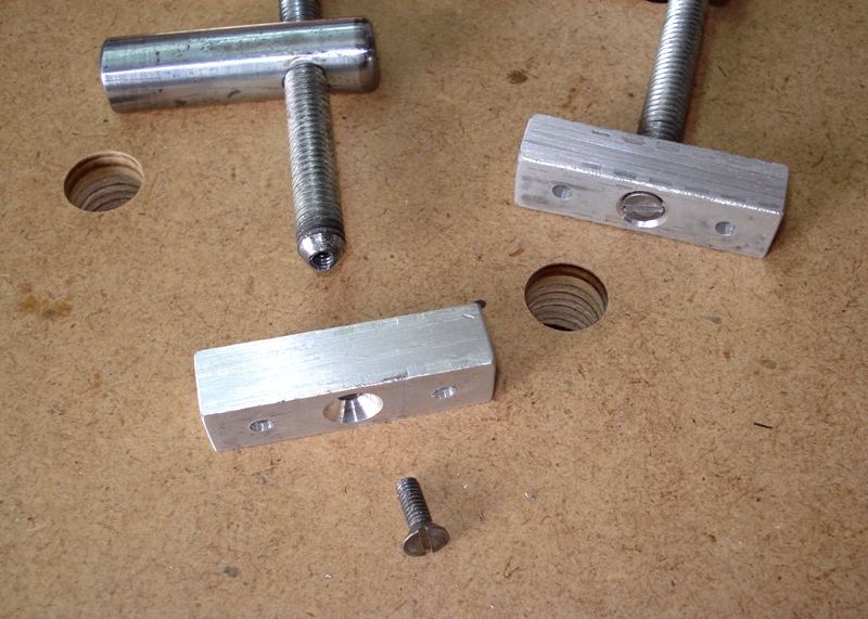

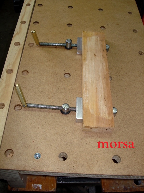

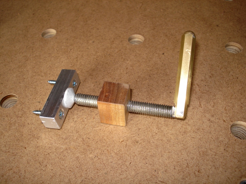

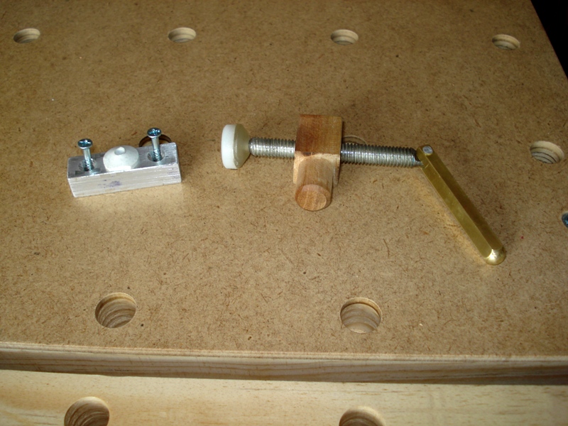

2- The second change was the addition of a rectangular aluminum head to the screw tip, in order to attach wooden cutouts, for clamping curved or irregular shapes.
Attachment 14789
Attachment 14790
Attachment 14791
Attachment 14792

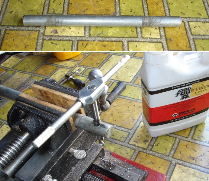

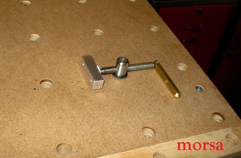

3- Last change was to make the post with rolled steel, giving the final result of my homemade version of a “wonder pup”.
Attachment 14793
Attachment 14794
Attachment 14795
Attachment 14800
Attachment 14801
Attachment 14802
Attachment 14803
