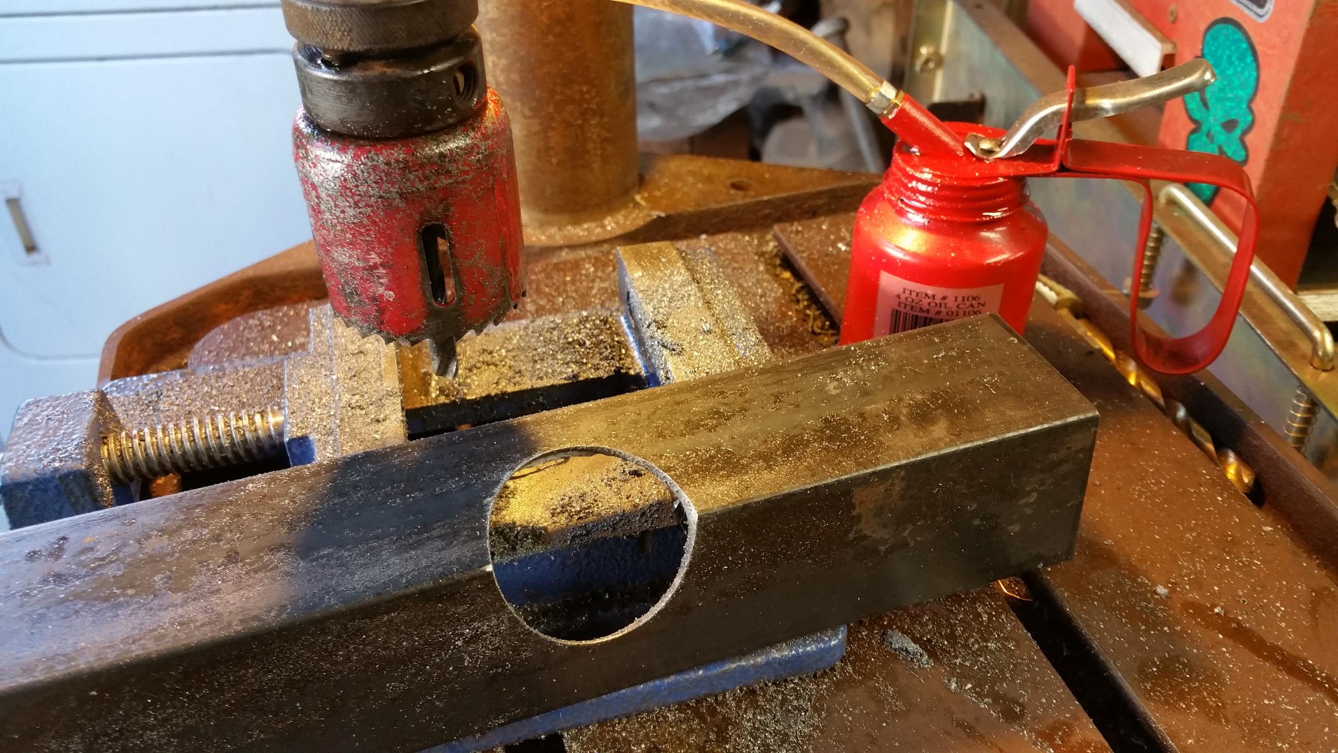

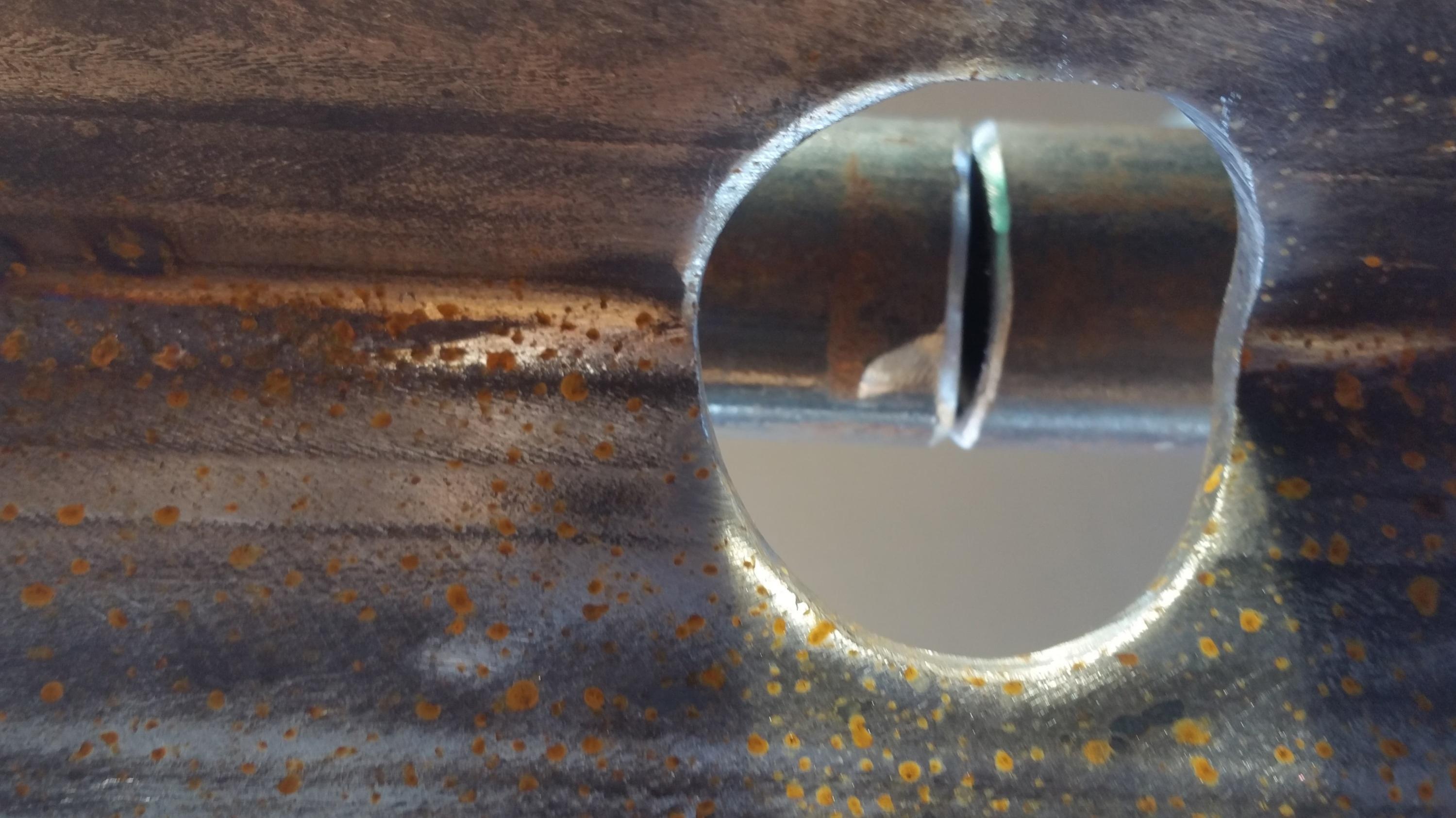

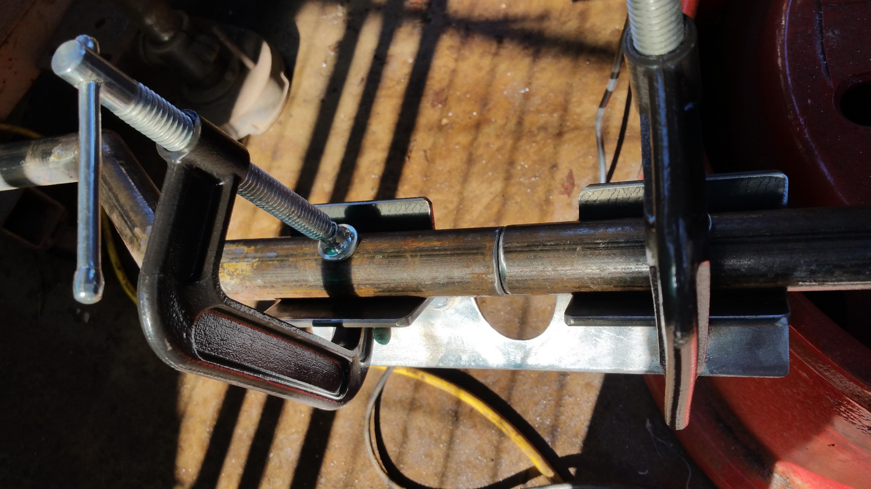

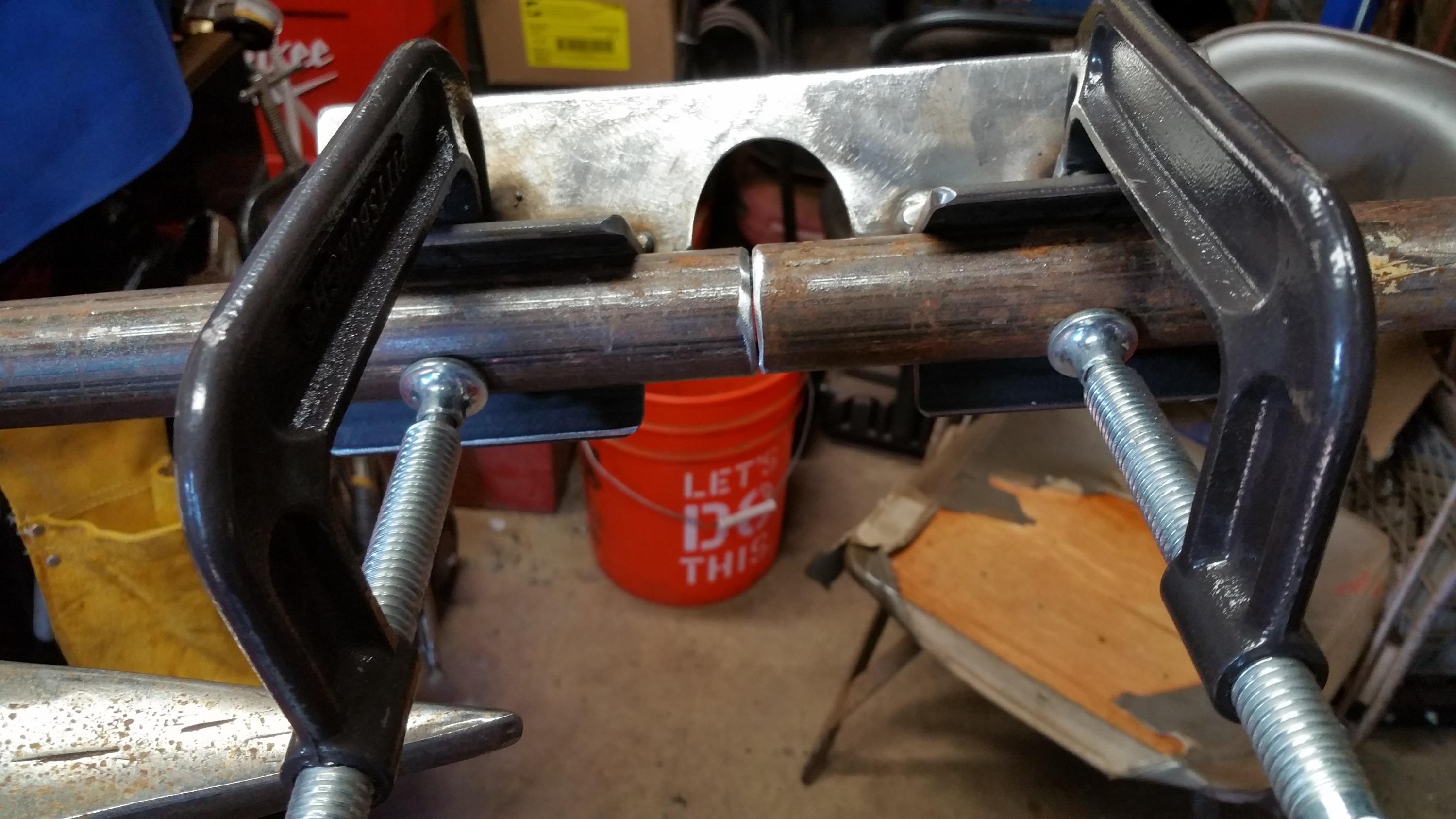

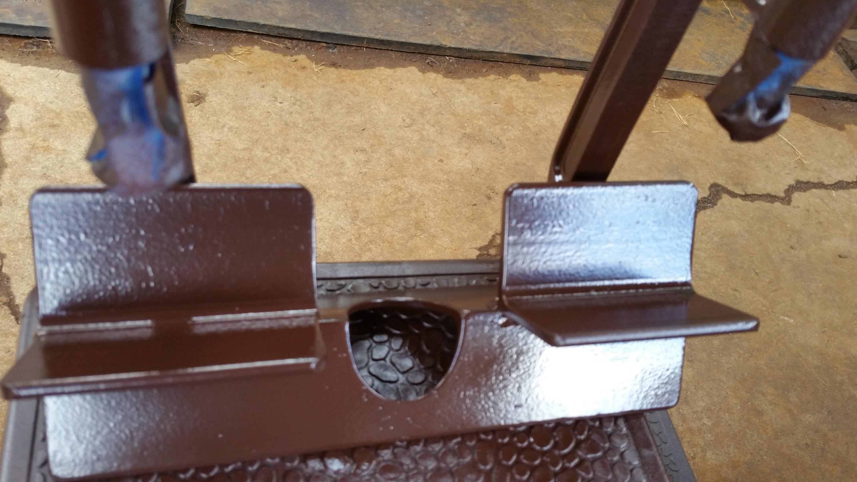

Attachment 9190Attachment 9191Attachment 9192Attachment 9193Attachment 9194 Here are a few pictures of a pair of clamps I made, I found the idea on the internet and copied it...and added the hole in the center to allow welding access from the bottom.
