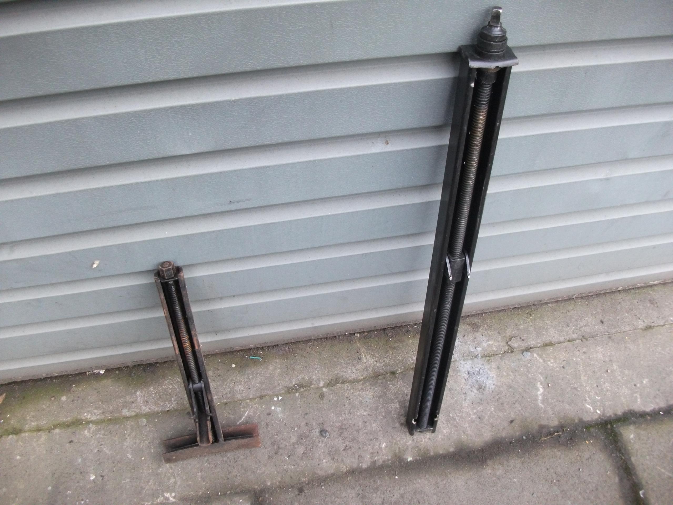

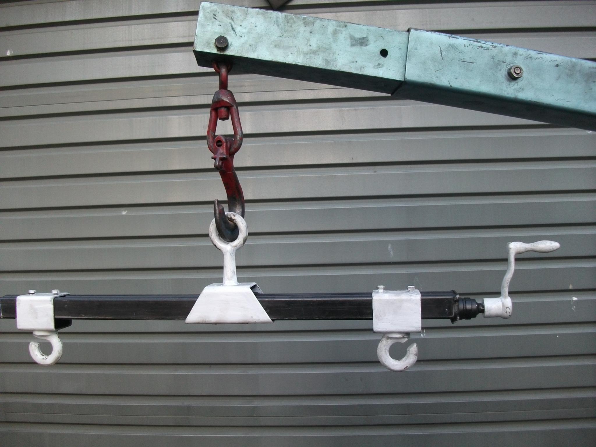

    This is a tool that most people who needed one would just go out and buy, as they are not expensive, but I'm certainly not one of those, so this engine or load leveller/tilter was made up from an old side screw jack, three hooks, three pieces of 2 inch box section and a handle from my 'junk' box !
    This is the basic screw jack (on the right) that I started with:-

    A short video was made showing the make up of it, including a demo lift, and posted on my YouTube channel :-
