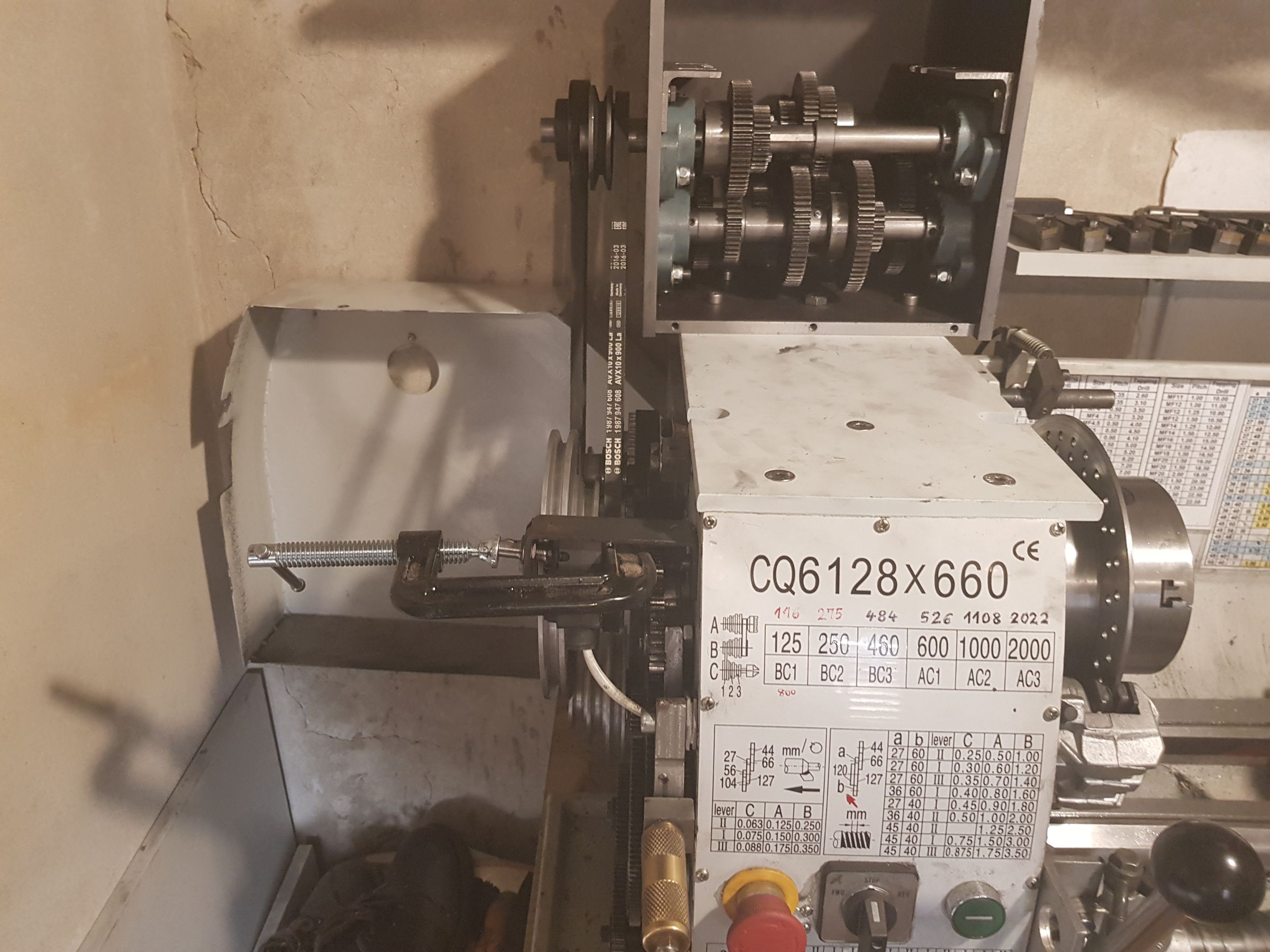

    Hi guys,
    Fabricated external lathe gearbox and finally managed to test it. I run it for very short time in order not to destroy gears. No oil in gearbox.
    As there are couple of people who couldn't wait to see it in operation (rossbotics wrote: Looks great, cant' wait to see the finished product)
    I posted it now before it is completely finished.
    I would assemble it completely in a day or two and fill oil inside (ISO 46 hydraulic oil) and buy 925 mm v-belt (presently 900 mm v-belt is outside pulley groove), but I received an urgent call from crewing manager and had to pack my luggage and join the vessel very urgently. So that has to wait until I am back home again. Then I will post video of assembling gearbox and with fully completed gearbox (painted as well) in use.
    Poor design of belt change and bad choice of spindle speeds made me to do something about it. Whoever has this type of lathe knows exactly what I am talking about. I was thinking about this project for a couple of years already and during my last contract I spent more than 3 months calculating speeds and what gears to buy. I made so many calculations and I made more than 500 different drawings always changing something. There was also an idea to have 18 speeds, but that would be overkill. Still there is possibility to install two additional gears (55 and 33 teeth) and get additional 6 spindle speeds: 125, 250, 375, 500, 750 and 1500. It can happen. I am in China again and gears (google translated it from Chinese as precision spur gears #45 steel tooth surface induction hardened) are very cheap here. Chinese gears for Chinese lathe.
    Total weight of gearbox is close to 50 kilograms and that's the reason why it sits on very strong support. It is also placed far away from the chuck so it is not in the way of chuck key.
    Once I was happy with my calculations and drawings, I bought all that stuff which can be seen in attached pictures.
    What can't be seen in video is that I also installed drain plug at the bottom of gearbox (smaller oil eye glass) and glued rare earth magnet inside in order to collect steel particles.
    Materials used:
    mild steel, SS 316 and SS 304
    I estimate that I spent little bit less than 100 dollars for all material, but now I have fully functional and user friendly lathe. Needless to say that I spent plenty hours of my vacation time for fabrication of this gearbox.

    That is one awesome piece of engineering I must say, I bet you laid awake in bed at night thinking about that project !, It looks and functions just like a geared head lathe, I can understand what you meant by changing your designs so many times until you finally got what you were looking for, I been there and done that as well, congratulations on a superb and beautiful job, I give you two thumbs up on this one and my vote for tool of the month, excellent work !

    Superb design and build, I particularly like the selector mechanism, a recirculating oil pump would really top it off. You have made a superb lathe with your many modifications and this one certainly deserves an award.

    Thanks for the comments. Recirculating oil pump would be very nice addition to this project, but I wanted to make it simple. There are plenty lathes with oil bath system and they are working just fine.
  11. #8
    5,355
    7,074
    Thanked 3,572 Times in 2,210 Posts
    Quote Originally Posted by LMMasterMariner View Post
    Your gearbox, entire development, and presentation gets my vote for "Tool of the Week". Forever!
    Benefits from recirculating oil are probably suited to equipment with long run cycles, where baths aerate lubricants to unhappy plain bearings.
    Bath oiling works perfectly satisfactory. Suits many gear forms including hypoid and spherical or roller bearings.
    I've noticed some work better, where the engineering provides 'paths' for oil to reach components above the fluid level.
    Rotating gears transfer oil upward readily, even at slow speeds. Slingers [oil knives] are common in small engines.
    Shafts grooved with a shallow long pitched helix generate lengthwise travel. Most are rounded, not vee'd grooves.
    Oil wicks [capillaries] are very effective; cotton cord or pipe cleaners wrapped loosely around light gauge stiff wire. Position these over oil ports of bearing housings. About the first boxed gear train I worked on included small balconies; reservoirs to better feed remote capillaries.

    Great job I might have only one suggestion
    I have used those adjustable pillow block bearing several times in the past. I found that in time no matter how Tight I thought I had them they would move just enough to cause a miss match My solution was to drill and tap a small piece of metal then weld one on each side to the adjustment then use a grub screw to hold the housing in place. It is a lot of work having to use two grubs on each bearing since you have 8 of them but it may pay off in the long run.
    Again great job
