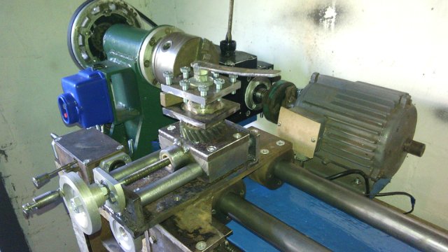

    Great ingenuity in the design of the gear box and shifter for changing speeds. Thank you for the photos and video.

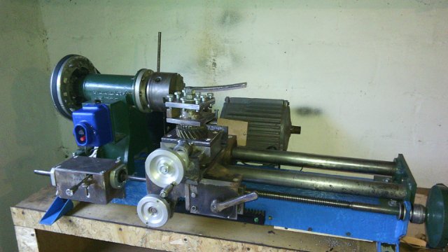

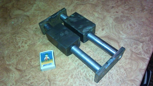

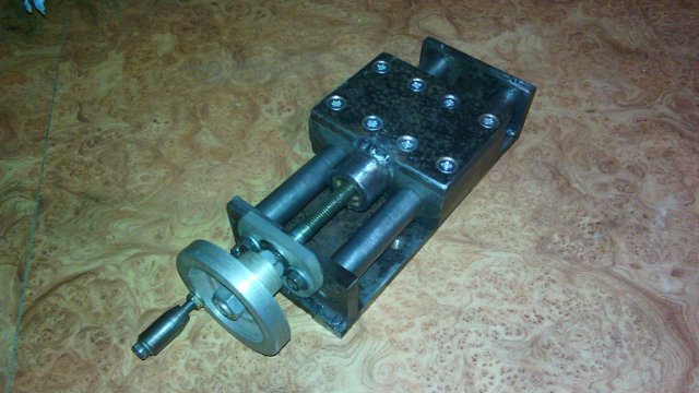

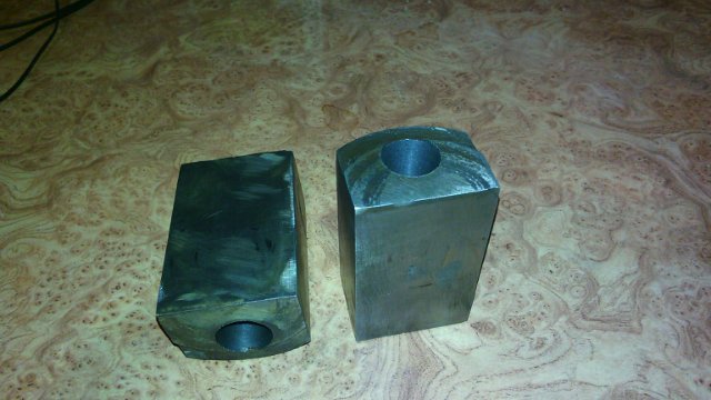

    Thank.

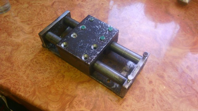

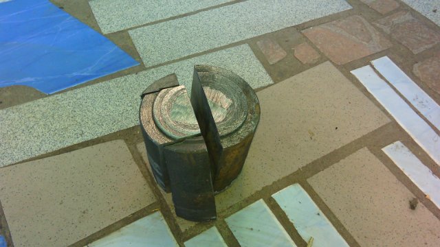

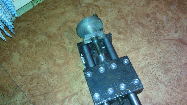

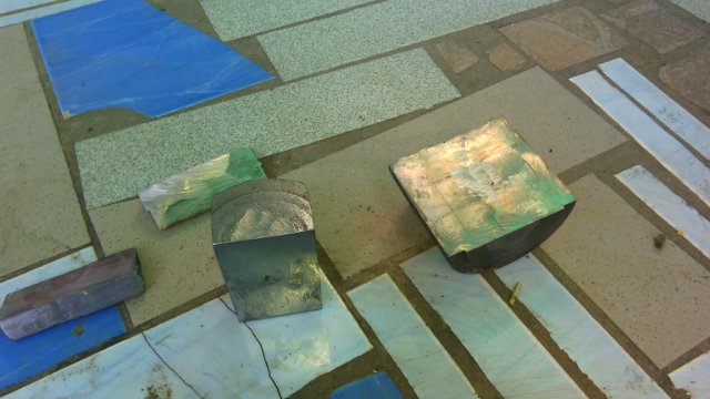

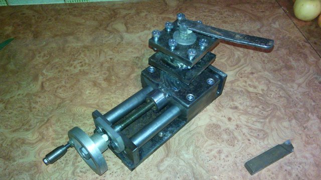

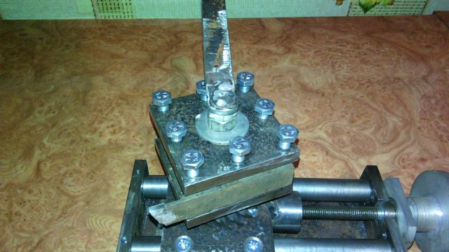

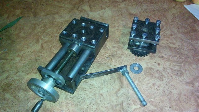

    Caliper with Tool carriers. Steel rods have a diameter of 22 mm, bushings are made of cast iron.

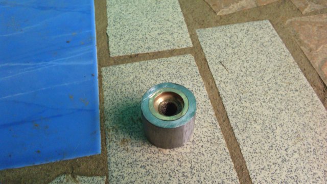

    bronze nut
