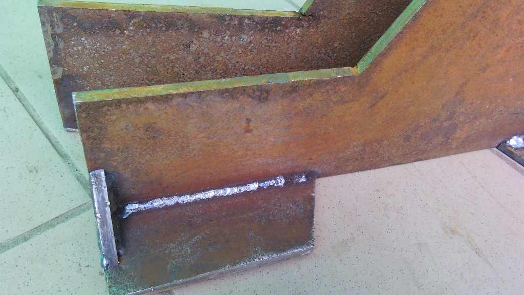

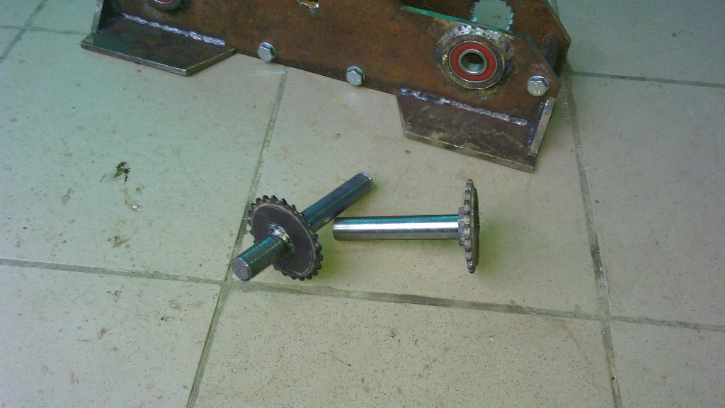

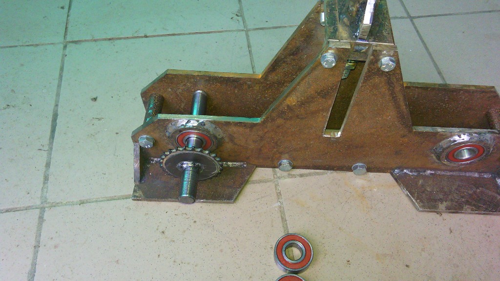

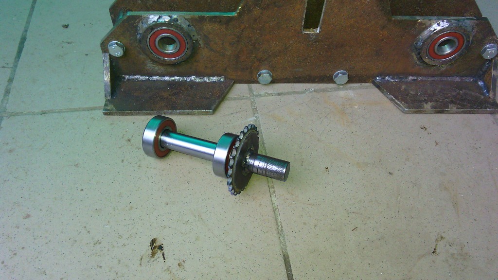

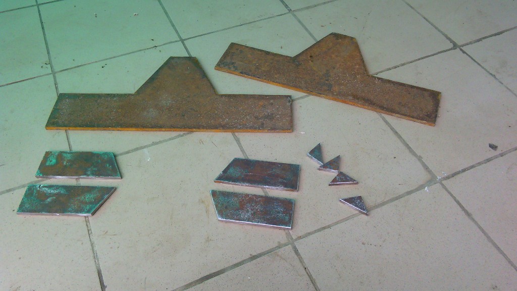

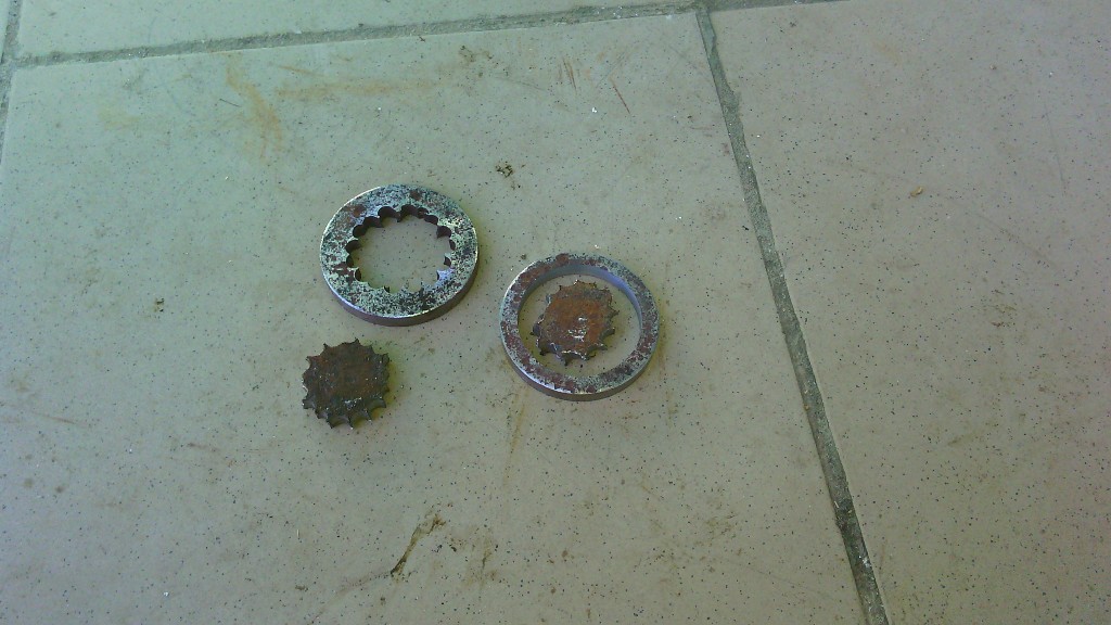

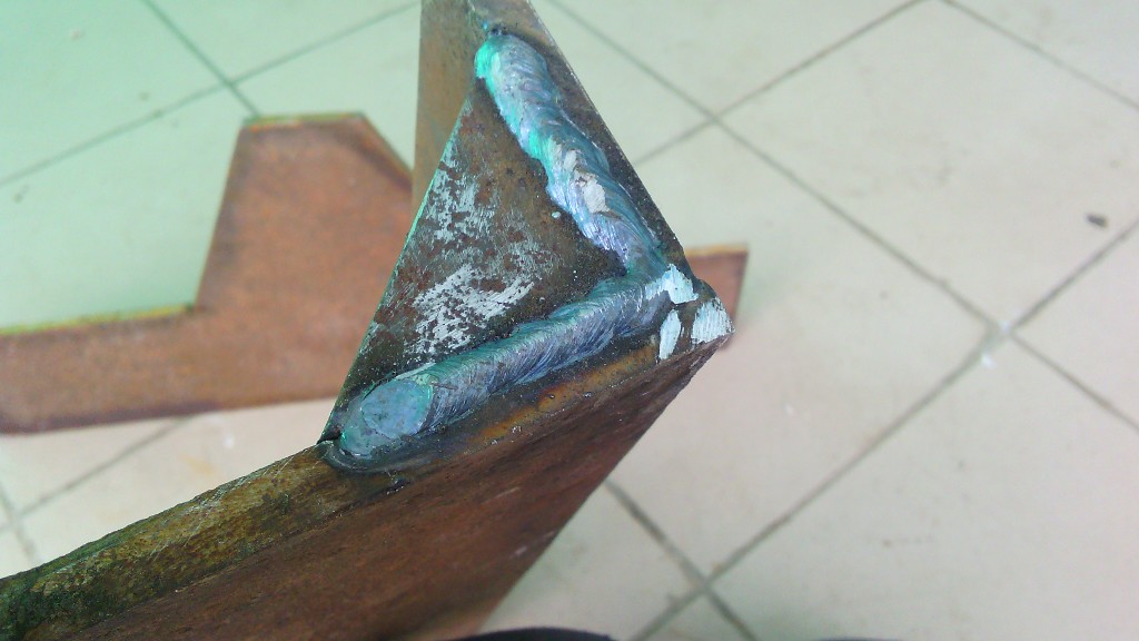

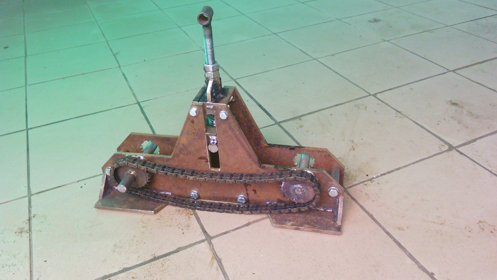

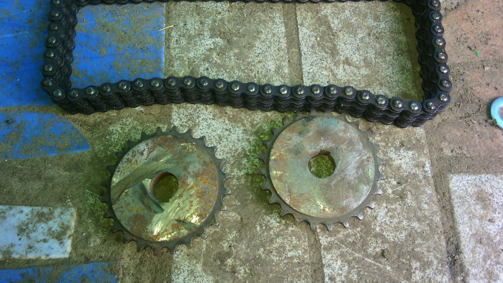

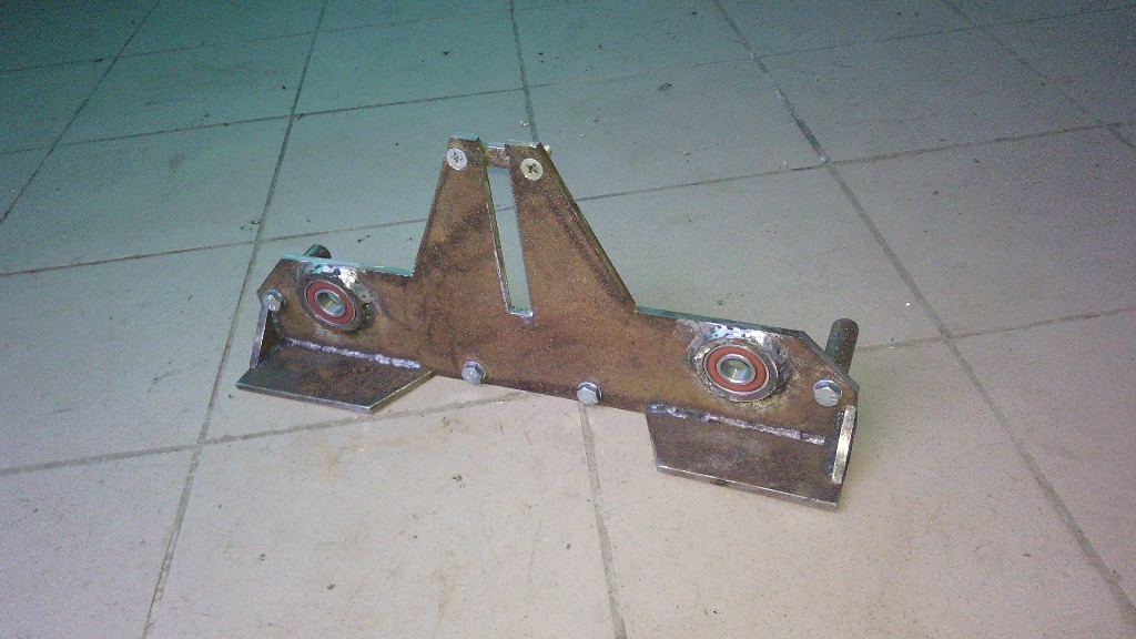

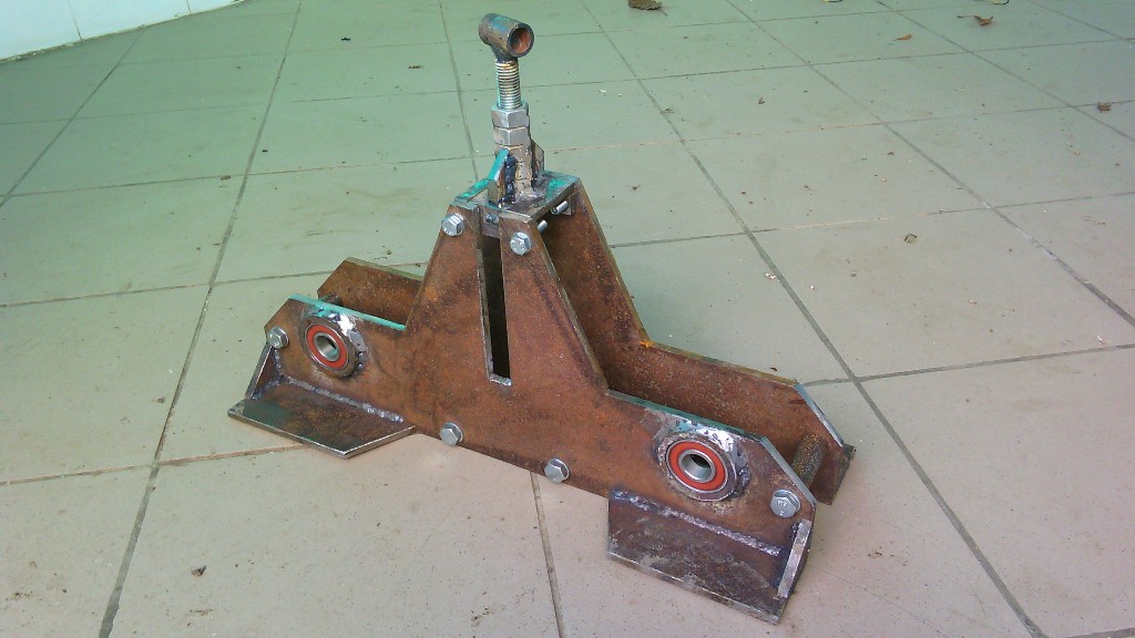

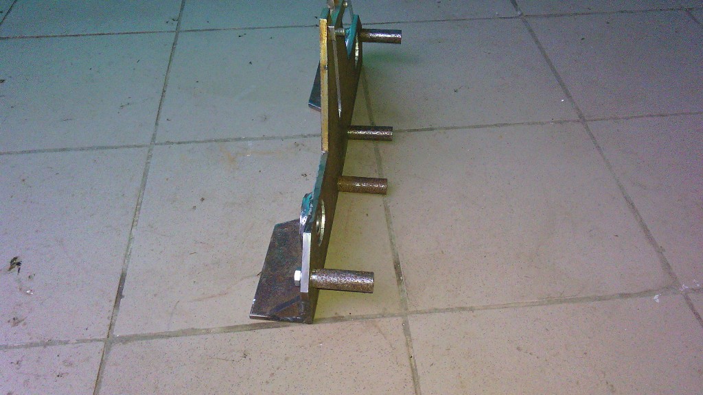

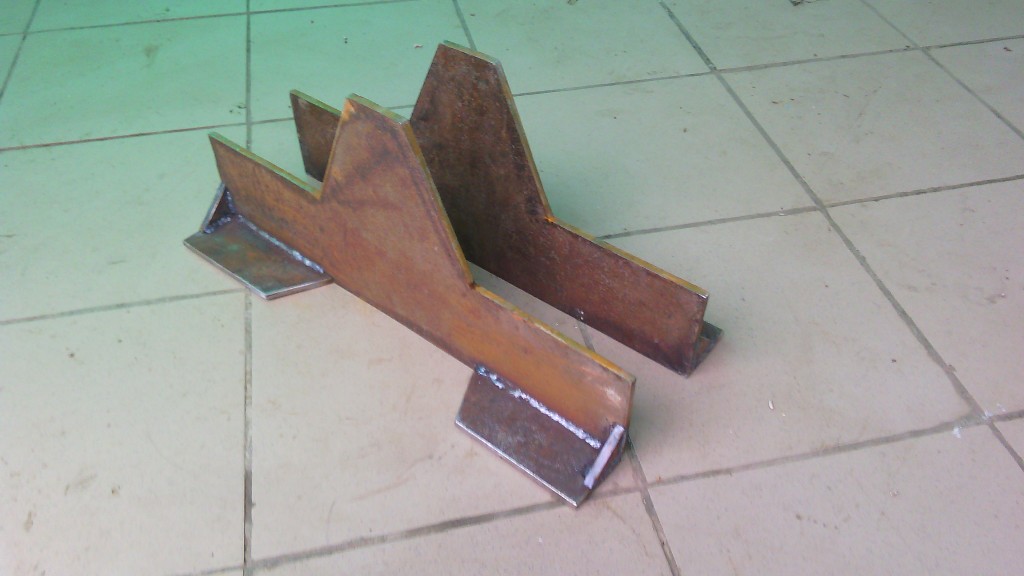

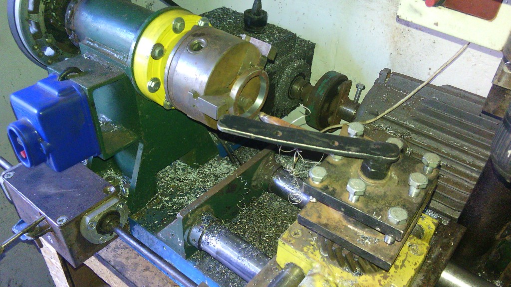

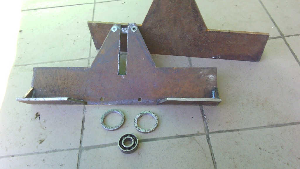

    Hi! My homemade metal bender. Made of metal sheet thickness of 10mm.
    Homemade Metal Bender-img_20161115_131942.jpg Homemade Metal Bender-img_20161115_143730.jpg Homemade Metal Bender-img_20161115_143849.jpg Homemade Metal Bender-img_20161115_144020.jpg Homemade Metal Bender-img_20161116_142428.jpg Homemade Metal Bender-img_20161118_131408.jpg Homemade Metal Bender-img_20161118_132650.jpg Homemade Metal Bender-img_20161118_133522.jpg Homemade Metal Bender-img_20161122_152726.jpg Homemade Metal Bender-img_20161122_152739.jpg Homemade Metal Bender-img_20161123_123738.jpg Homemade Metal Bender-img_20161123_144802.jpg Homemade Metal Bender-img_20161123_144822.jpg Homemade Metal Bender-img_20161124_144413.jpg Homemade Metal Bender-img_20161124_144630.jpg Homemade Metal Bender-img_20161125_123302.jpg Homemade Metal Bender-img_20161125_123356.jpg Homemade Metal Bender-img_20161209_103009.jpg Homemade Metal Bender-img_20170110_151415.jpg Homemade Metal Bender-img_20170110_151433.jpg

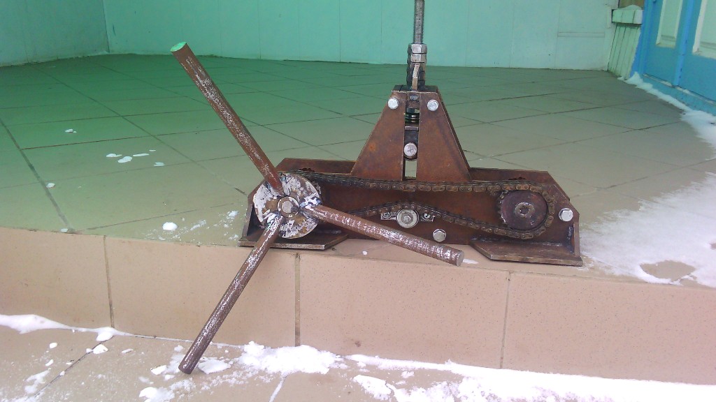

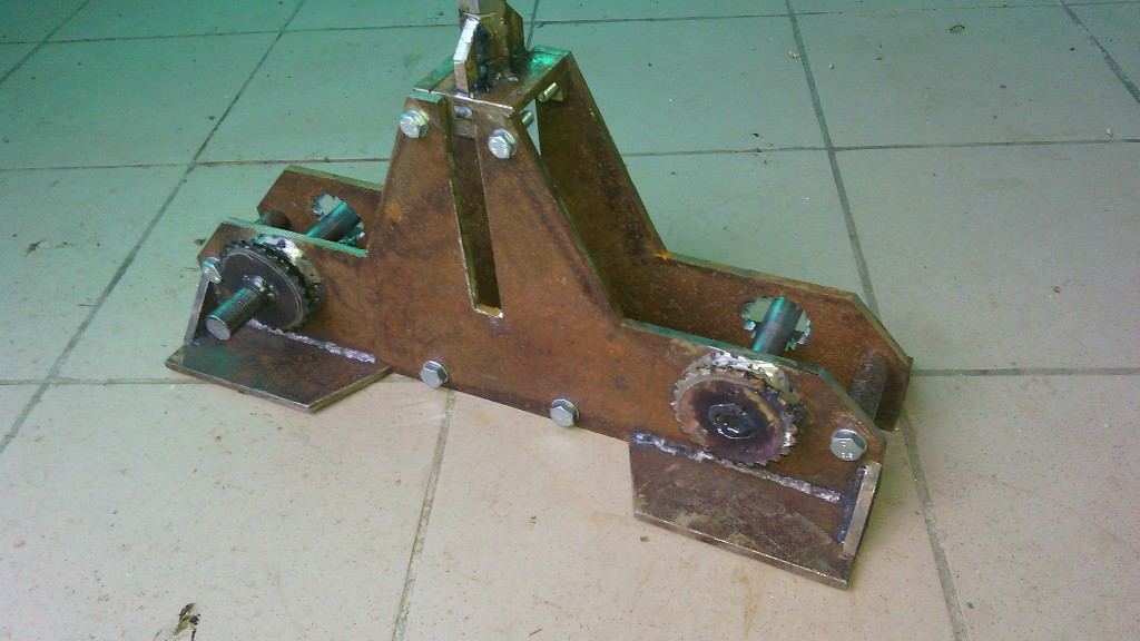

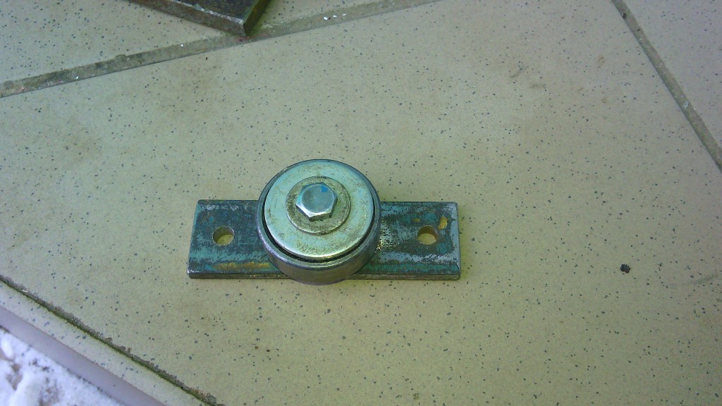

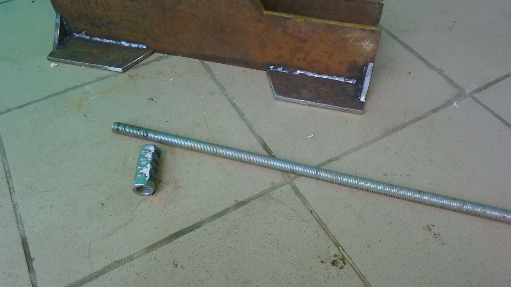

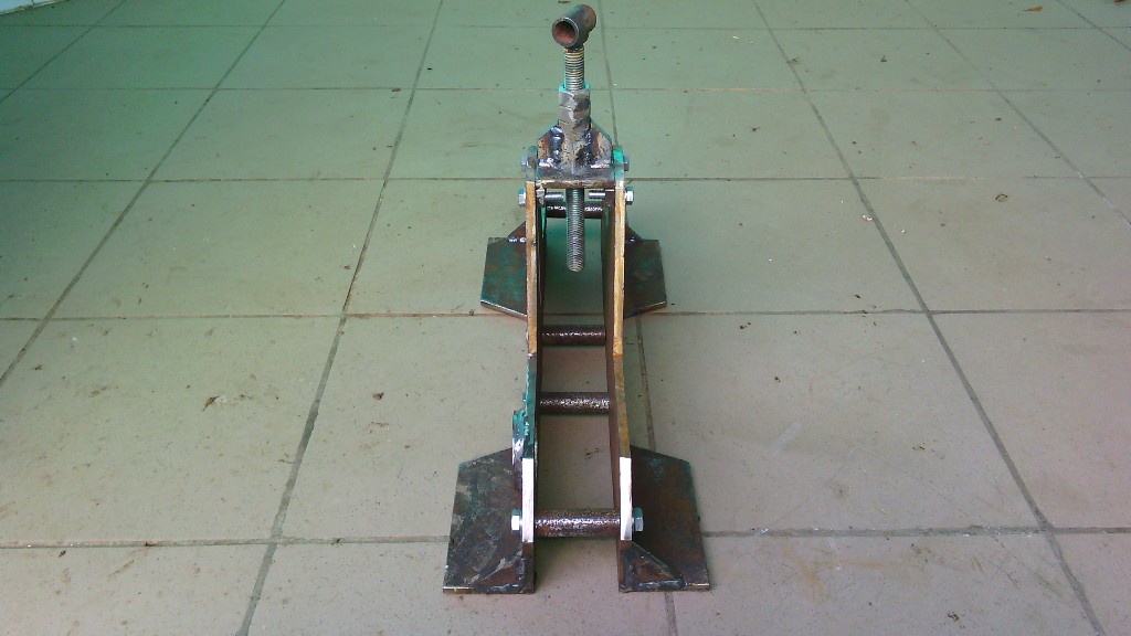

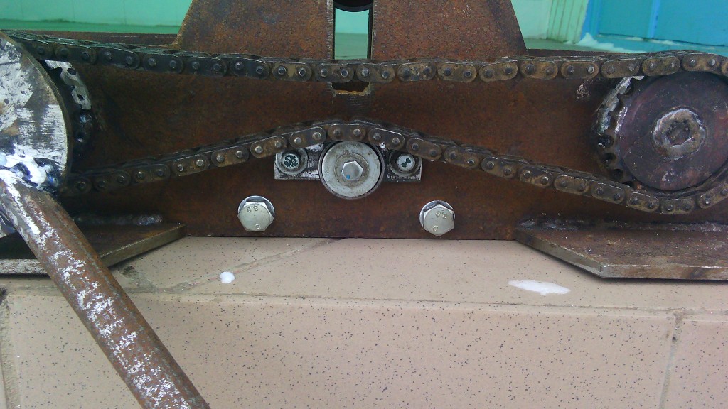

    Homemade Metal Bender-img_20170110_151444.jpg Homemade Metal Bender-img_20170110_151519.jpg Homemade Metal Bender-img_20170111_110935.jpg Homemade Metal Bender-img_20170111_111338.jpg

    Later paint and produce rolls for shafts

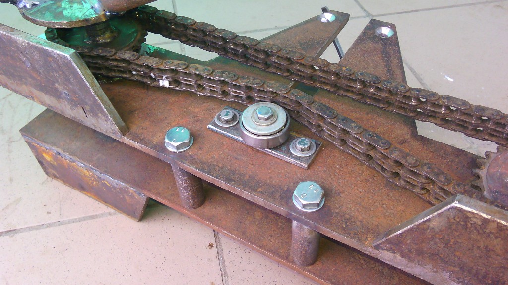

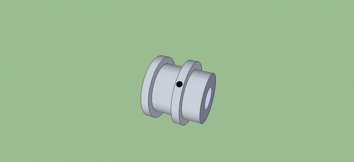

    Roller for square tubes, washers movement can change the width

    When you make your rollers I believe you will find that stacking the washers to take up the entire open area will be better than trying to set screw them in place
    Vyacheslav.Nevolya, I agree with Frank S that stacking washers or parting off sets of tubing would be more effective. Best might be a spacer AND a free-spinning washer to reduce galling the materials edge; bending will cause it to widen somewhat.

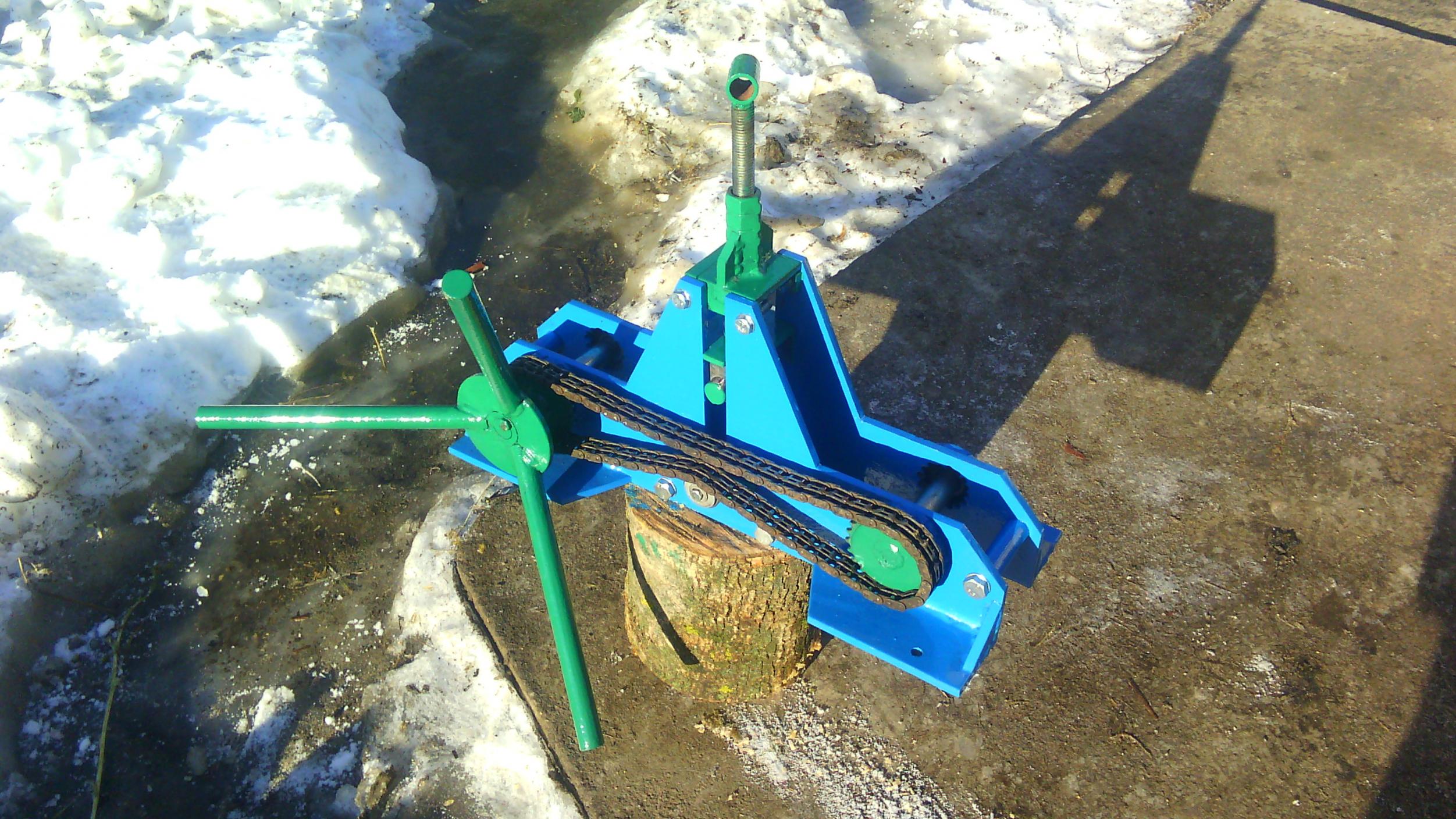

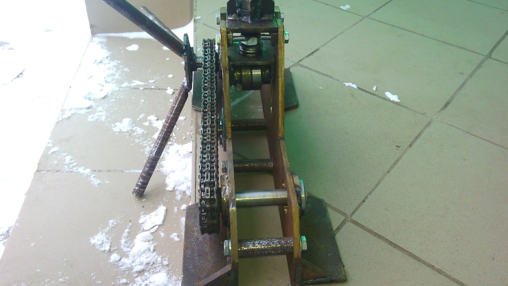

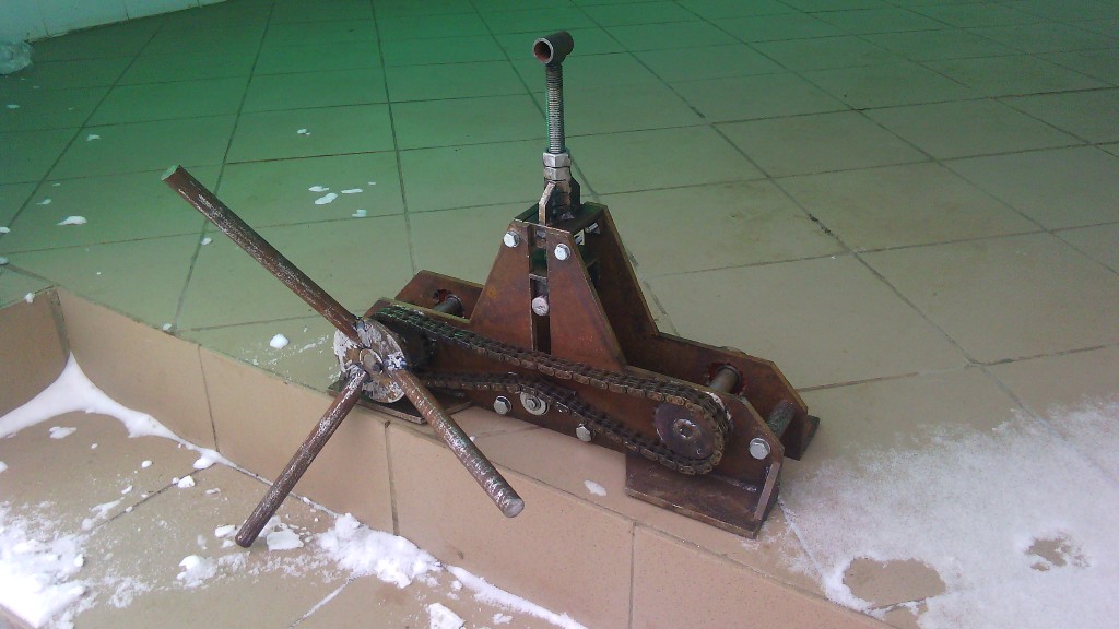

    After painting
