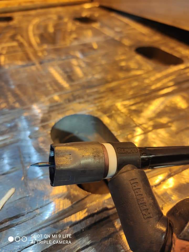

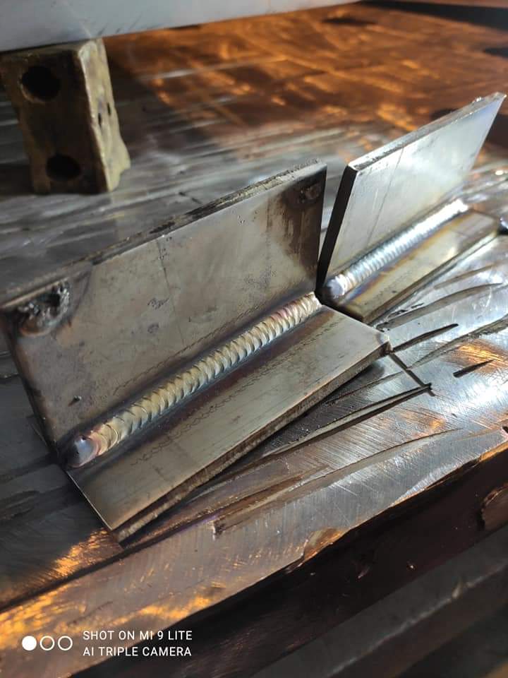

Btw. While welding it, i got an idea about simple aid that makes easier to learn " walking the cup " with tig.
Simple octagon shaped cup.
Its easier to " walk " with the edged, than round shape.
Short clip shows the use:

Note that camera is on the way, so i need to feed additive over it.
It would be better to feed it in lower angle.

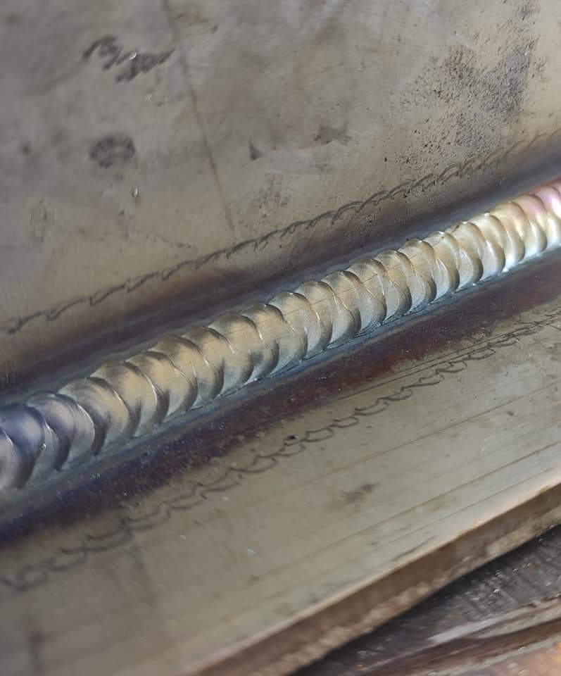

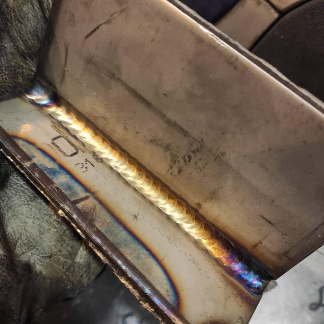

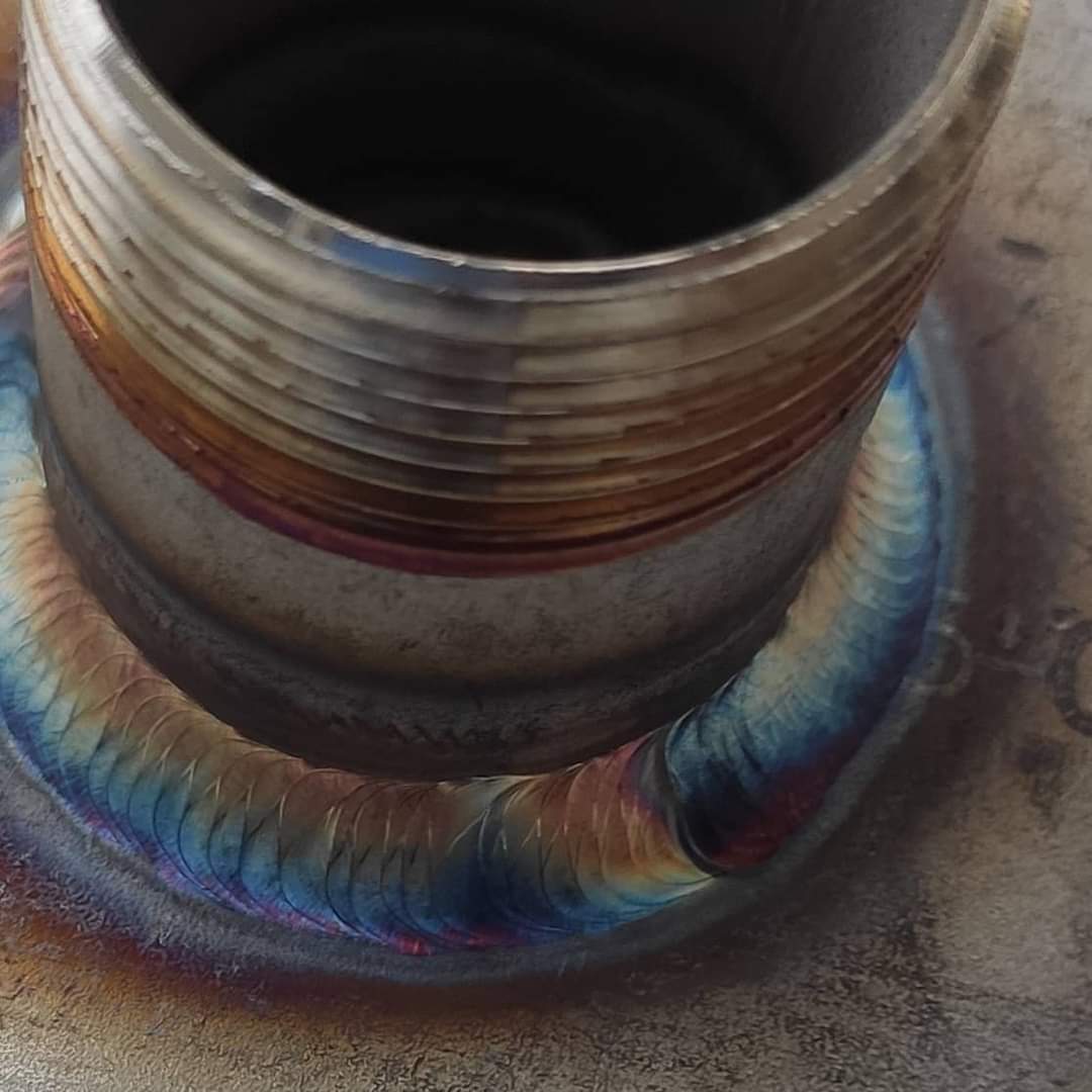

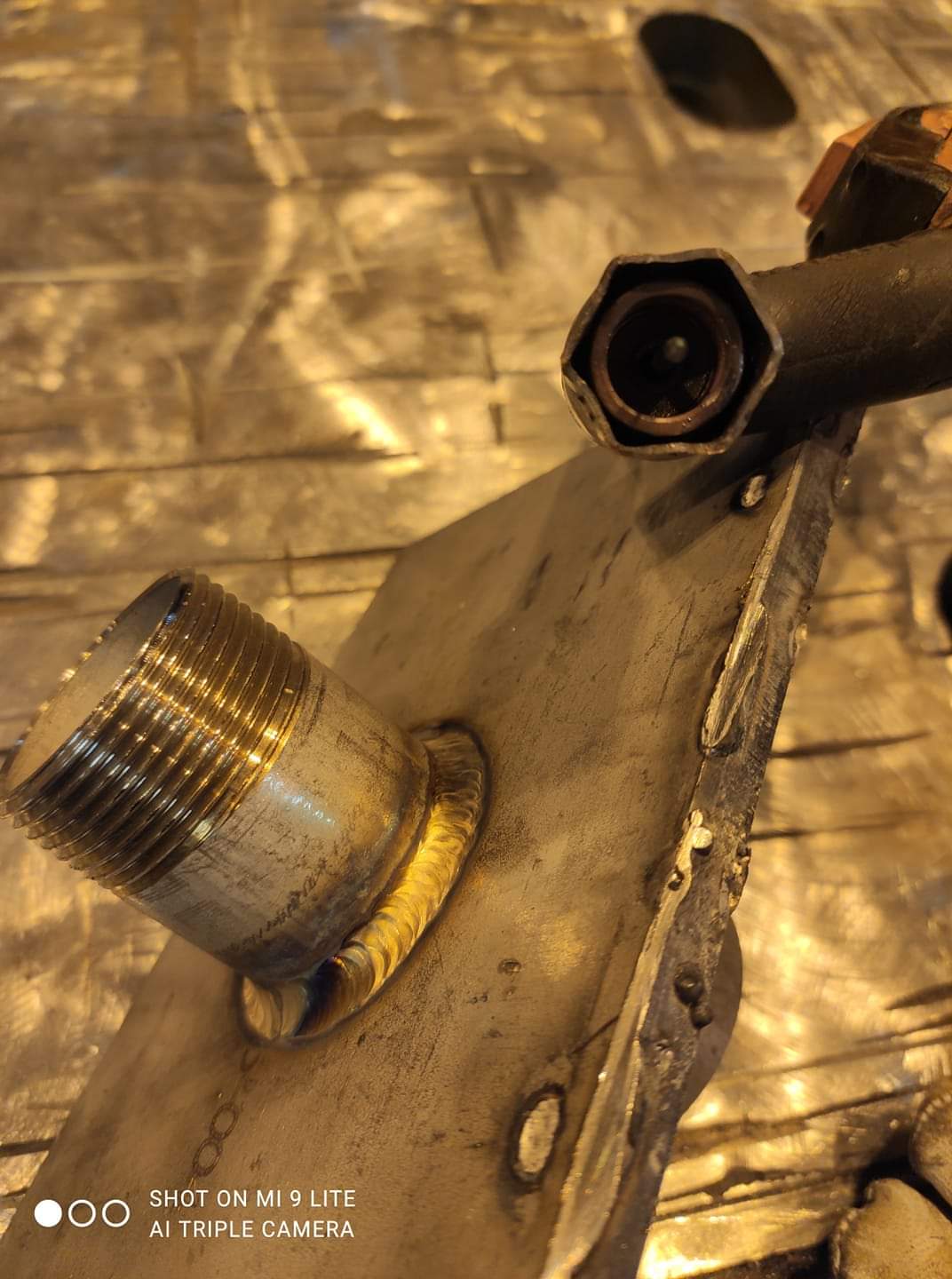

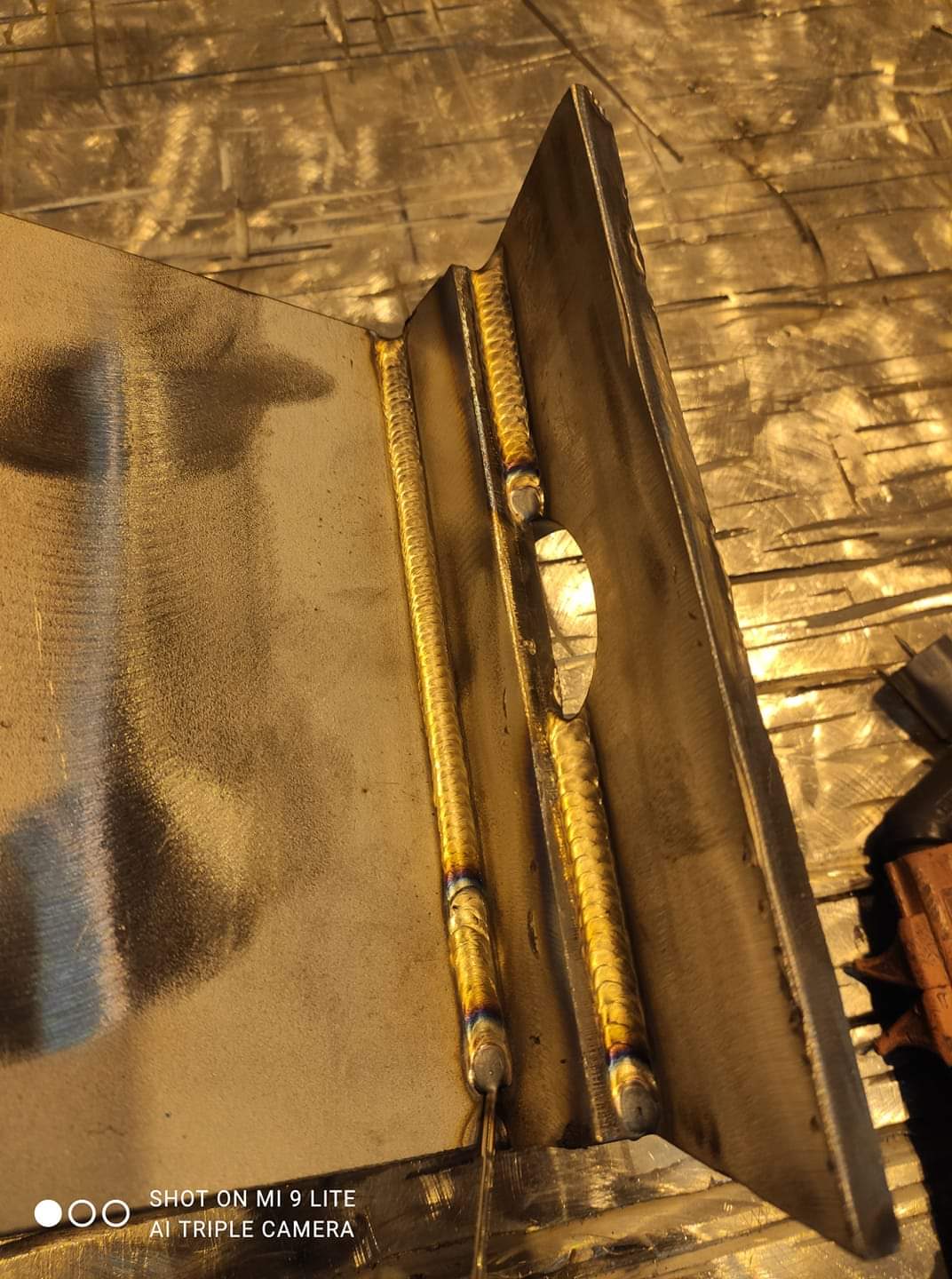

Results:
Attachment 38118
Attachment 38119
Attachment 38120
Attachment 38121
Attachment 38122Attachment 38123
I haven't used that method earlier, just the " traditional " way.
Actual cup is a shaped copper pipe on top of the size 6 ceramic cup.
Attachment 38124
Octagon shape is made by pressing pipe around suitable sized nut head.
Helped me to learn the method.
