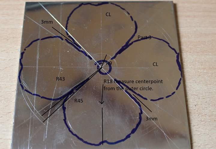

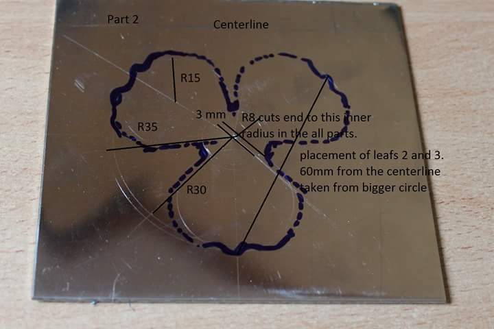

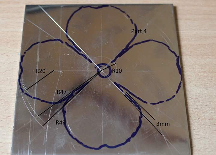

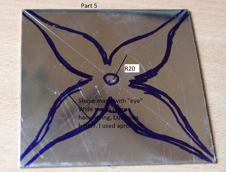

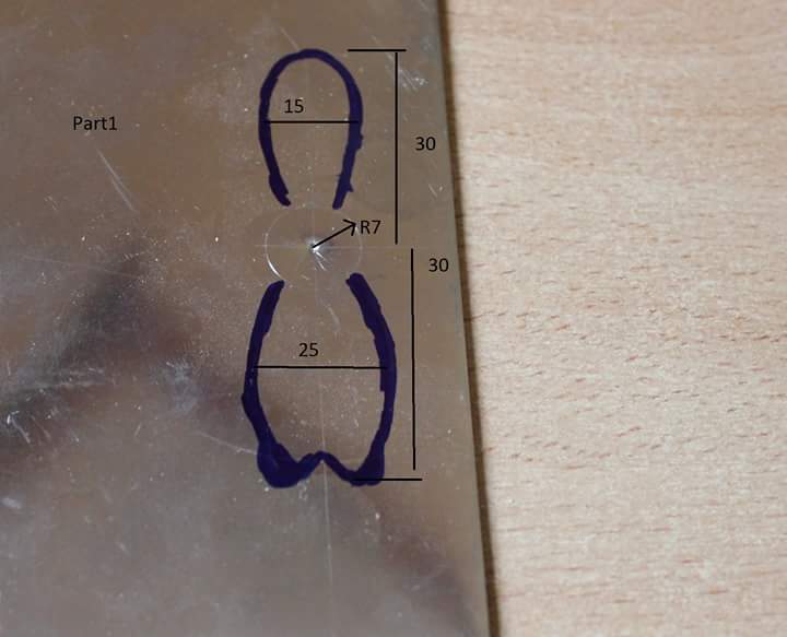

    Hi.

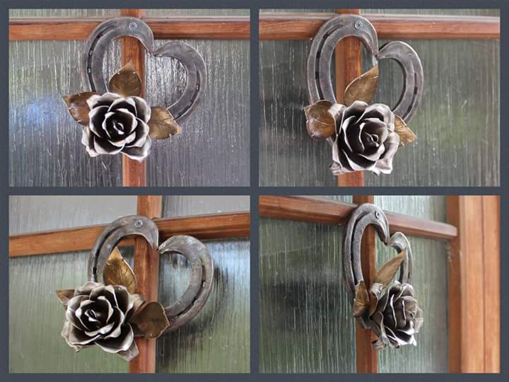

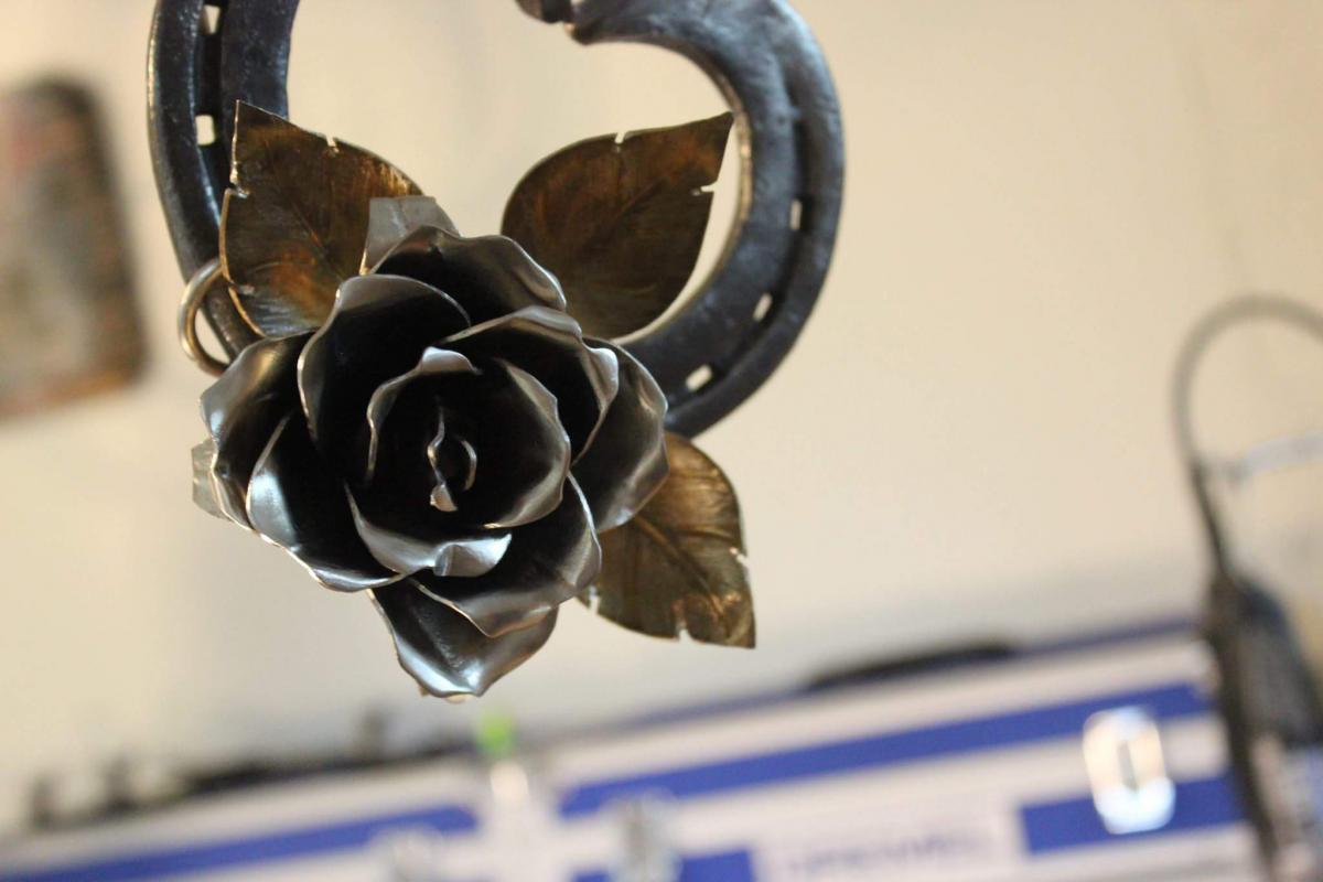

    This is my homemade rose. Made from 1.5 mm thick stainless steel.
    Here is the part one:
    Second part is coming soon.
    I tried to find simple way to make it.
    My solution is made from five parts.
