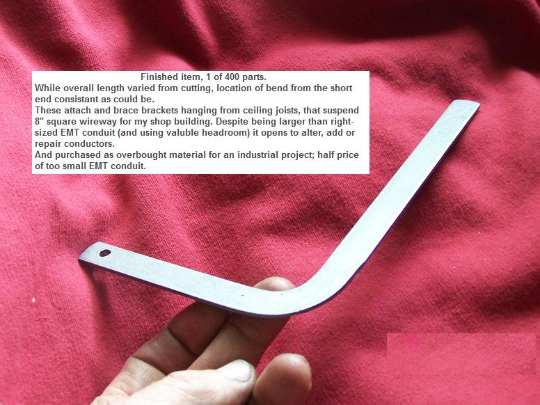

So, wireway is being suspended with door flap perpendicular to floor, not on top as usual. Commercial hangers, couplers, tees and ells not ideally designed for that either.
So what? Instead designed complete system to suit the installation. More importantly it presents a clean-looking install that passes a full Electrical Inspection.

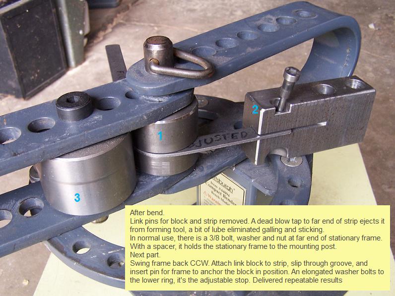

A] Drew up hanger and support for max headroom [no pun]. It gets everything plumb and level, directed over each of the machine aisles.

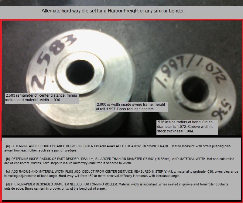

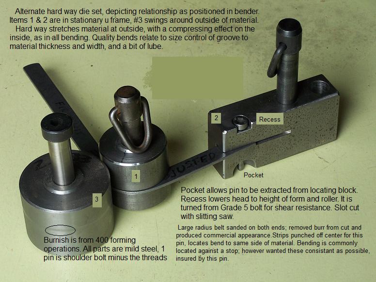

This post is about manufacturing the hanger brace.
I can answer mechanical/ machining questions on the tool modification. Have inserted most everything needed so readers can duplicate or alter as needed. Click the pix, text is embedded already. Apologetically, withholding on the full bracket and other components until install is done, as solution is patentable.

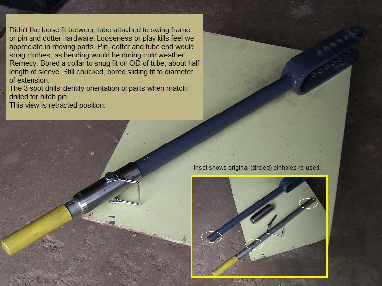

1 Attachment(s)
Harbor Freight Bender handle mod.
Getting the bender hardway dies ready, impression of unit was sound, a little loose, but not from scrimping on material, just tolerances.
Handle did not impart the feel desired of operating a tool. Most if not all came from fit of main tube to extension handle, even when retracted. Now it does.
Like my roof mentioned earlier, it won't need more attention later.
Like Rome, brick by brick.
Attachment 10030
