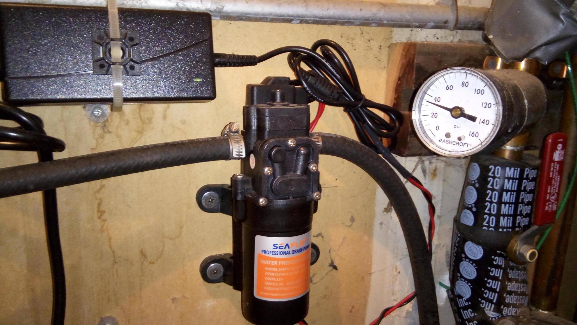

So, what to do? The system doesn't want a lot of pressure and I didn't want to do any fancy plumbing. ** IDEA **
I used a 12V pump intended for marine/RV water systems. It has a built-in pressure switch, it turns on at about 30psi and off at 35.

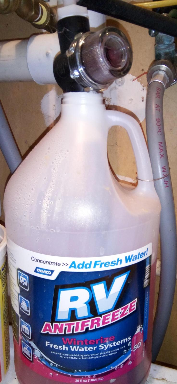

The suction side has a filter screen to a hose stuck through the lid of a 1 gallon anti-freeze mix bottle.
Hook it to a 12V AC adapter and it works! Been there a couple of years, still working on the same jug of anti-freeze but the system has never lost pressure since!
Here's pictures of the pump, pressure gauge, and the anti-freeze bottle with filter screen.
