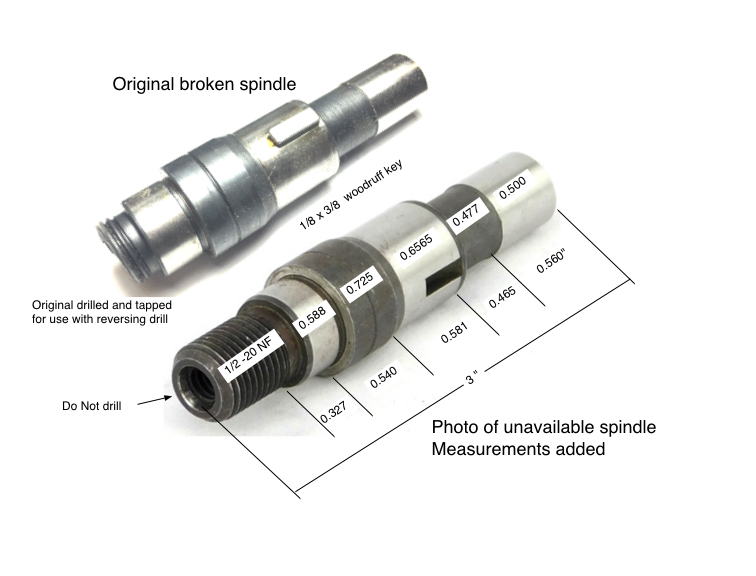

    I got an old Hougen magnetic base portable drill press with a broken spindle. The part is obsolete. I have searched extensively online for a replacement with no luck.
    It is just a shaft with a couple of different diameters, 1 threaded end and a Woodruff key seat. It has a couple of precision ground spots that run in needle bearings. Those will be the most challenging for me. I am game to try it with my tool post grinder. The original is drilled and taped as you would use on a reversing drill, but this one does not reverse. Since the original broke in the threads, I am planning to leave the threaded end of the spindle solid for additional strength. The original is broken clean, very fine grain with no distortion. I am sure it was heat treated.
    From what I have read so far, A-2 tool steel appears to be and appropriate material. I assume the original was heat treated, but I have no idea how much to temper it.
    I have confidence I can do all of the required machine operations. I plan to turn the rough sizes, maybe +0.005" then heat treat and finish the critical sizes by grinding.
    I have basic treating capability which I have used for chisels and cutting tools etc. I am thinking the most critical heat treat operation will be how much to temper the part.
    Any heads up will be appreciated.

    I think that air hardening tool steel will be too hard, and like glass, so very brittle. Improper tempering may be the cause of the failure.
    I made a repair many years ago of a 3/4" shaft that had needle bearings running on that surface. This was in a reduction gear box on my Gehl 2500 skid steer.
    Oil hardening tool steel is what I used. I tempered it back in an oil bath using a camping stove (didn't want oil at that temp on the stove inside the house). Tempering temp was 400F for 15 minutes. I happen to have a heat treat furnace (purchase because of that project). Your part is rather large. So heating evenly to the critical temp needs to be addressed.

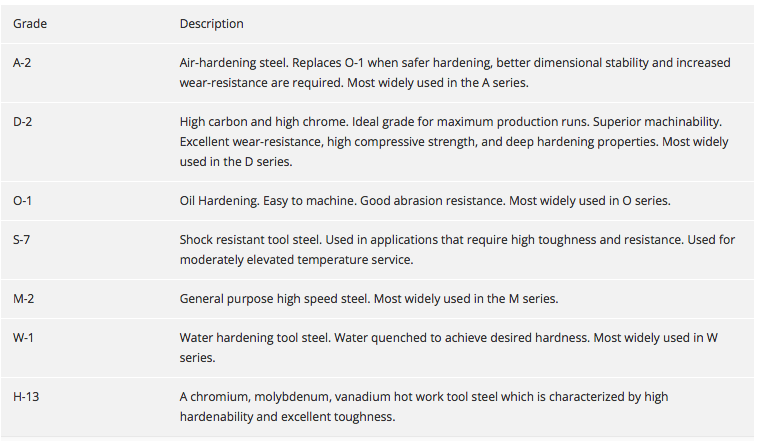

    From my experience tempering is the easiest part of the process to get right if you know the desired temperature desired. From my research it seems that 950˚f is about right. It seems that most parts that are ruined the damage occurs during hardening when quenching.
    I actually have a piece of 0-1 tool steel, but it is only 0.625 diameter. If I have to buy something, I may as well buy the correct material.
    There is so much information available it is just a bit over whelming to digest it all. This for example appears to be a good general explanation for types of tool steel.
    This chart is a summary at the end of the above link.
    Another site gives specific temperatures for various types of tool steel. I see this for A-2;
    "TEMPERING
    The tempering temperature may be varied according to the desired hardness. If maximum hardness is desired, tempering should be in the range of 300-400F, but if a lower hardness is acceptable, tempering at 950F will give the optimum combination of hardness and toughness."

    Sent PM with my spin and contact info..........the above suggestions are correct. "A-2" is primarily steel for punches and dies on lesser abrasive materials, "D" is very abrasion resistant, including grinding or resharpening a dieset. They like staying straight, can't picture them suitable for keyed or thread-relieved rotating parts. Chrome Moly Cr would be my choice; good enough for racing axles, so...... and machines nicely. Unsure regarding torque of a mag-drill and bigger annular cutters, some calculations x cross section might allow Stress Proof.
    While different companies give the steels various 'names' the SAE-ASTM standards make the products very comparable. Most listings incorporate a conversion.
