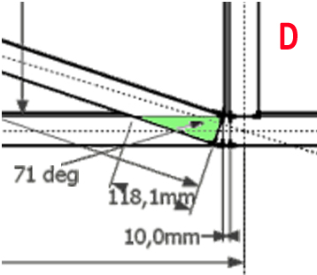

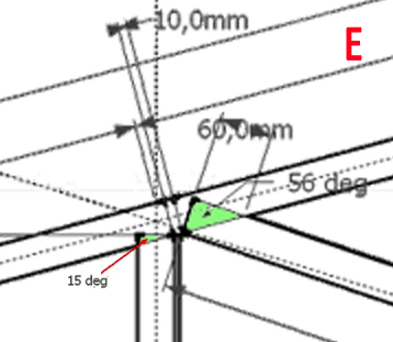

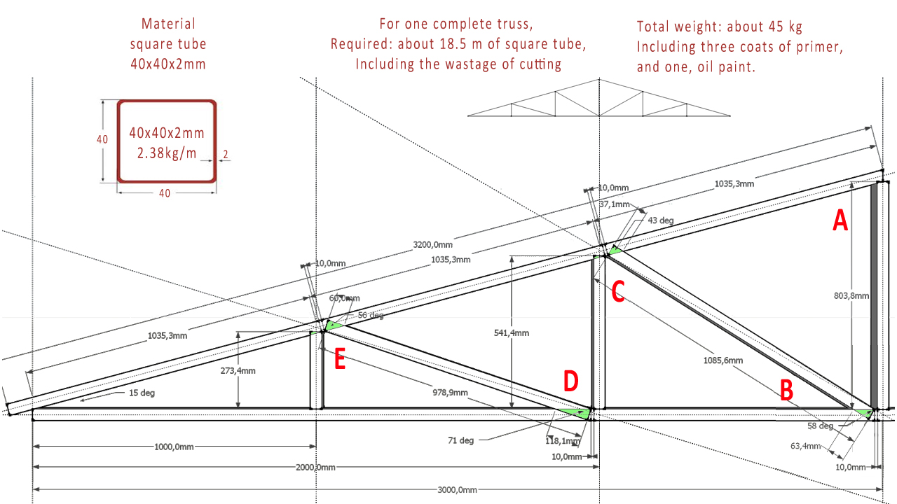

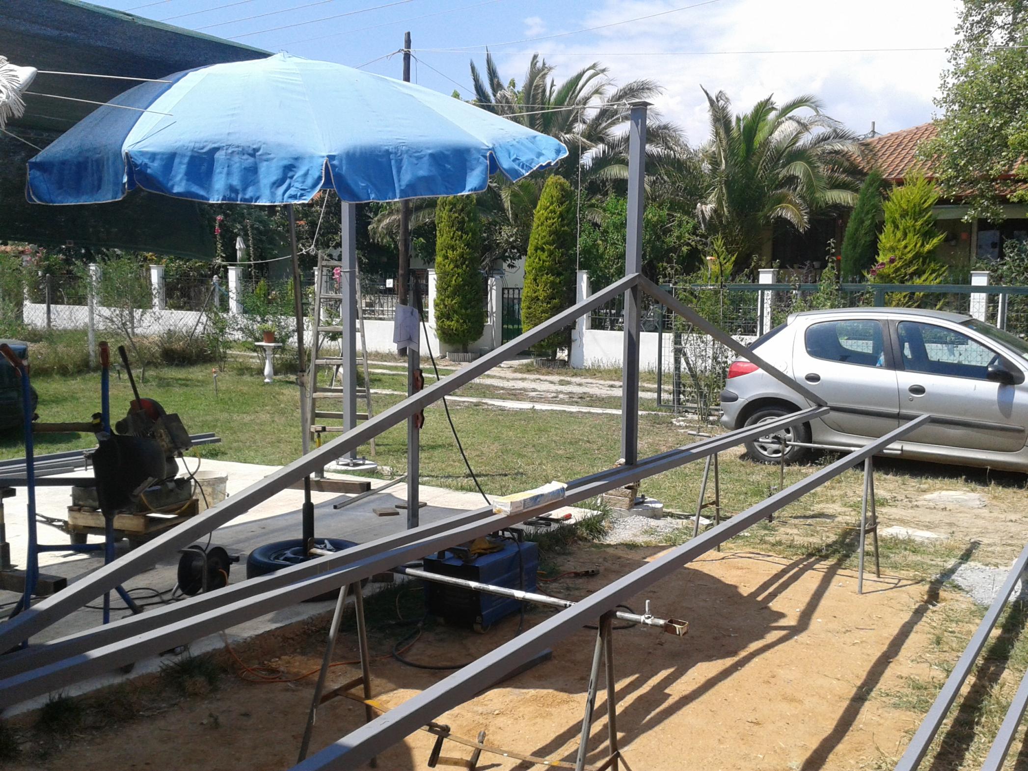

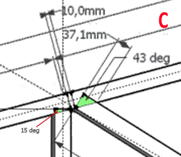

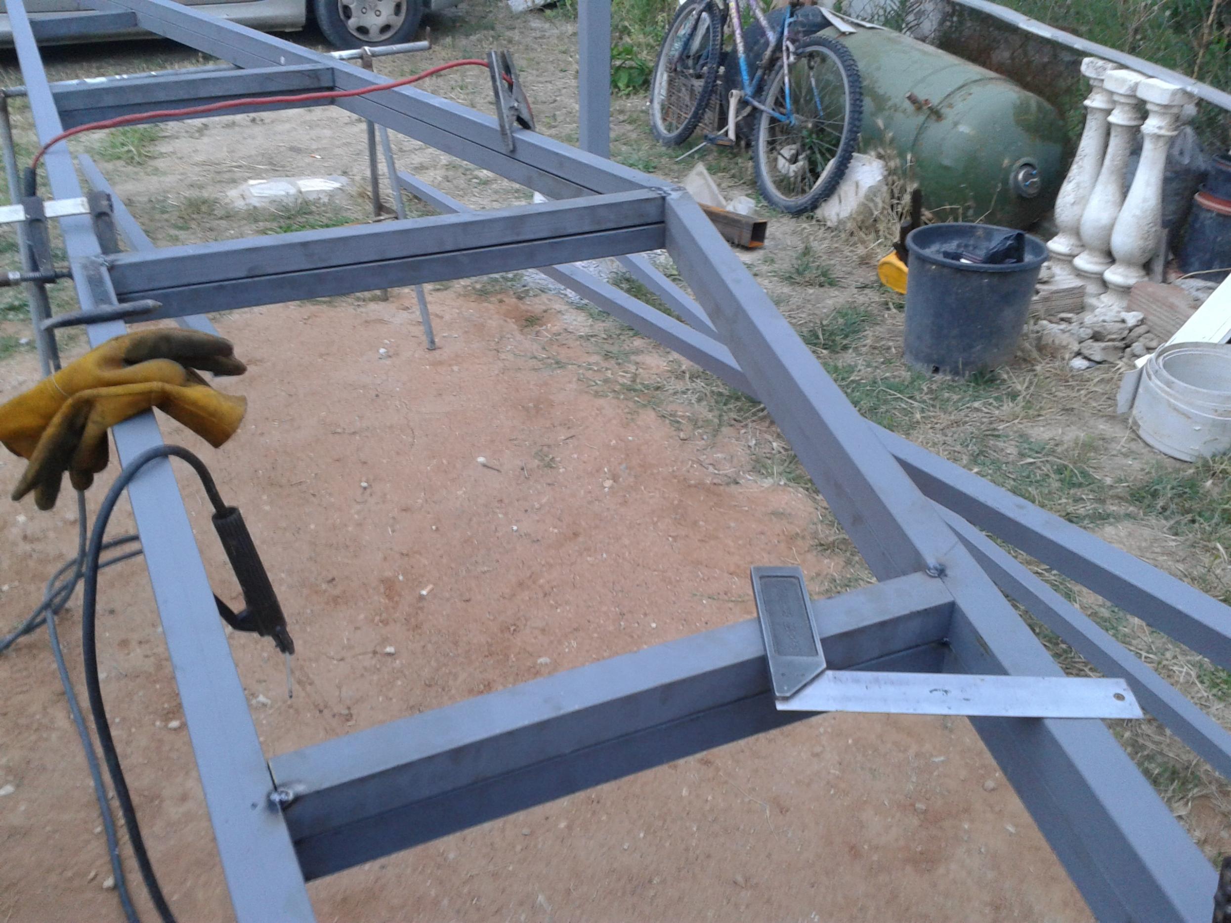

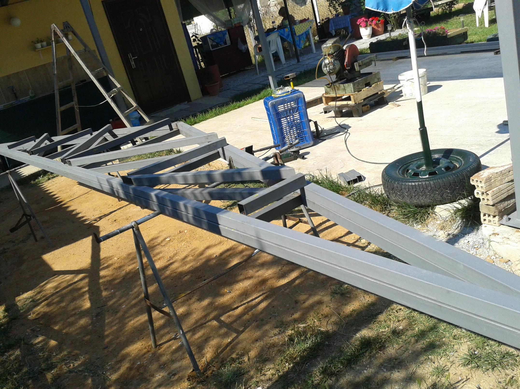

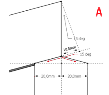

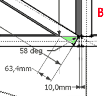

Roof truss assembly.
Full plan of trusses with all dimensions.
