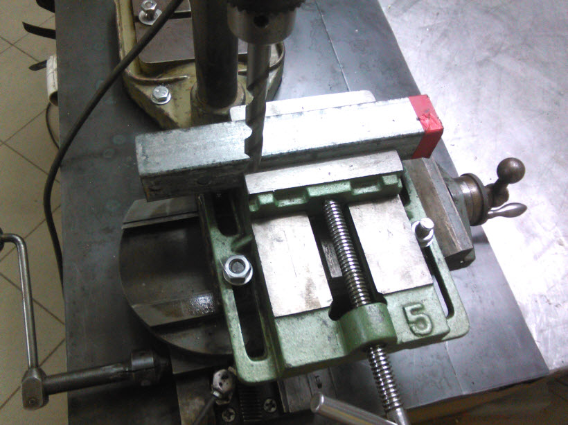

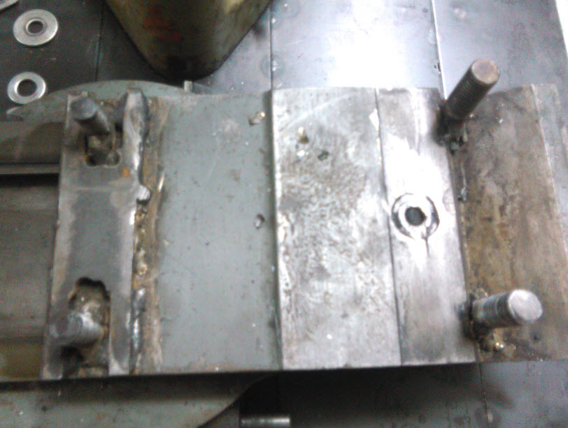

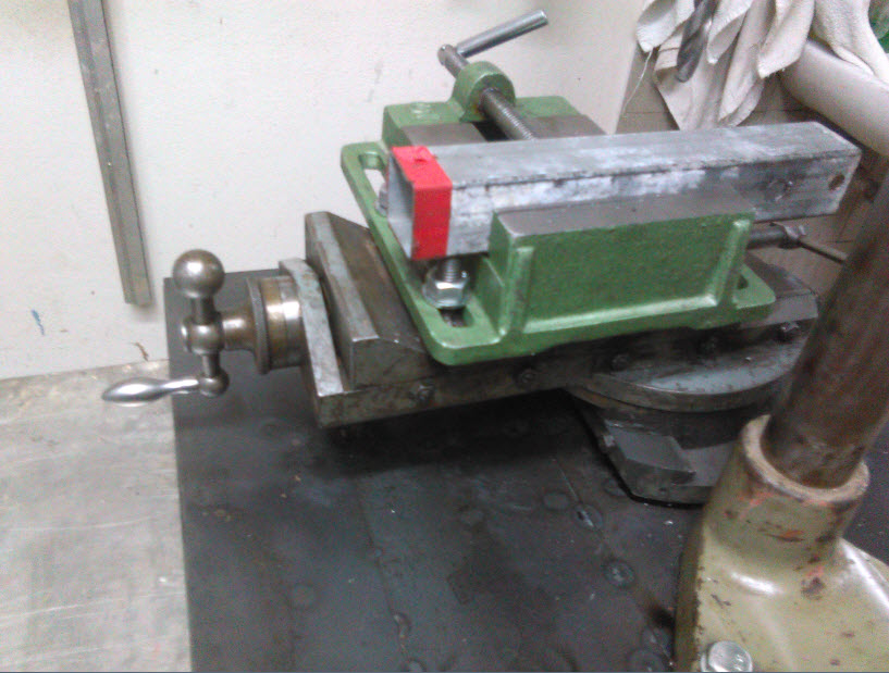

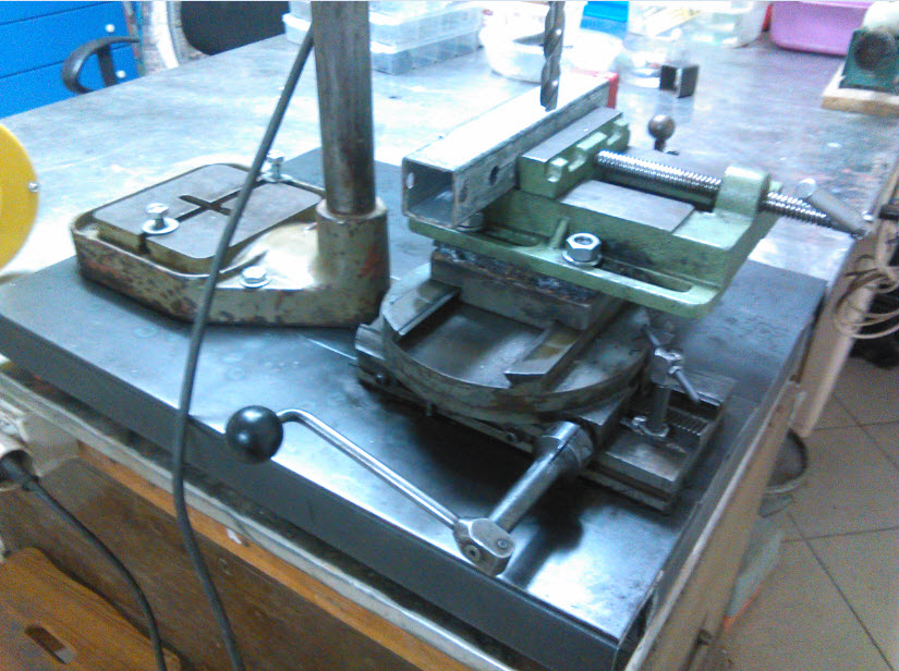

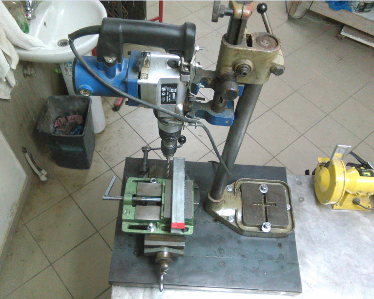

    HOW TO CONNECT A XY TABLE TO YOUR DRILL
    In this video you can learn how to connect a XY table to your cheap drill with a little money. With the XY table we can work very fast and with very good precision. Please pay attention. Do not use it as a milling machine. You will destroy your drill very quickly. You can buy a middle quality XY table from E-Bay from about 150 E . If you have a small drill for modeling you can find more cheap from about 45 E.
    YOU CAN WATCH THE CONSTRUCTION AND THE USE HERE:
