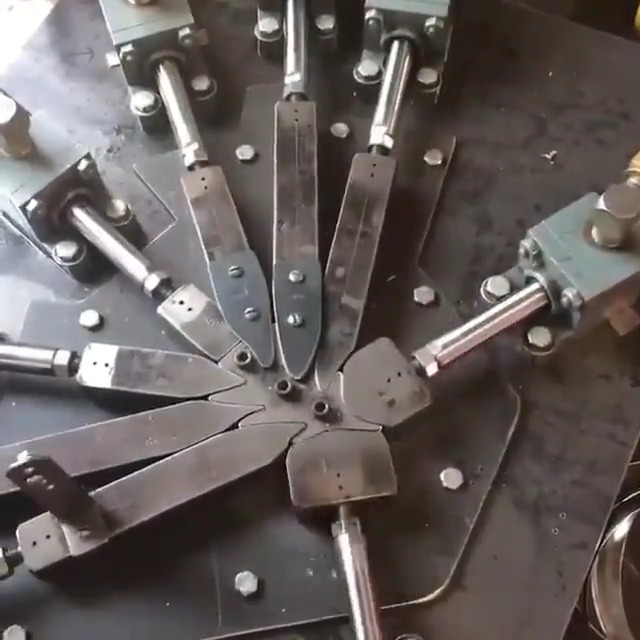

Good one Jon! Ok, same folks different dies and difference sequences with more pneumatics. Were are you finding these? Note the stabilizing top plates on 2 sequential rams and they started at the seam. Also the peak of the tree being the last op and if you look carefully (in the top view sequence) there does seem to be a bit of excess material folding over a bit at the crown. Can't seem to single frame a Gif...do you know how?

Was able to pause and get a jpg...
Attachment 25509

Interesting to see the similar setup in manual style with Over-center clamps (Not Destaco, but maybe very old ones, imho)...wonder if the this is the Proto, Proto for the previous. Mainly because it not made from a ring and to test the sequencing and will need Crimping or maybe a spot weld. I do believe this could definitely be done in a home shop.

Could be straight line toggles De-Sta-co model 603
https://www.travers.com/straight-lin.../p/61-190-130/
