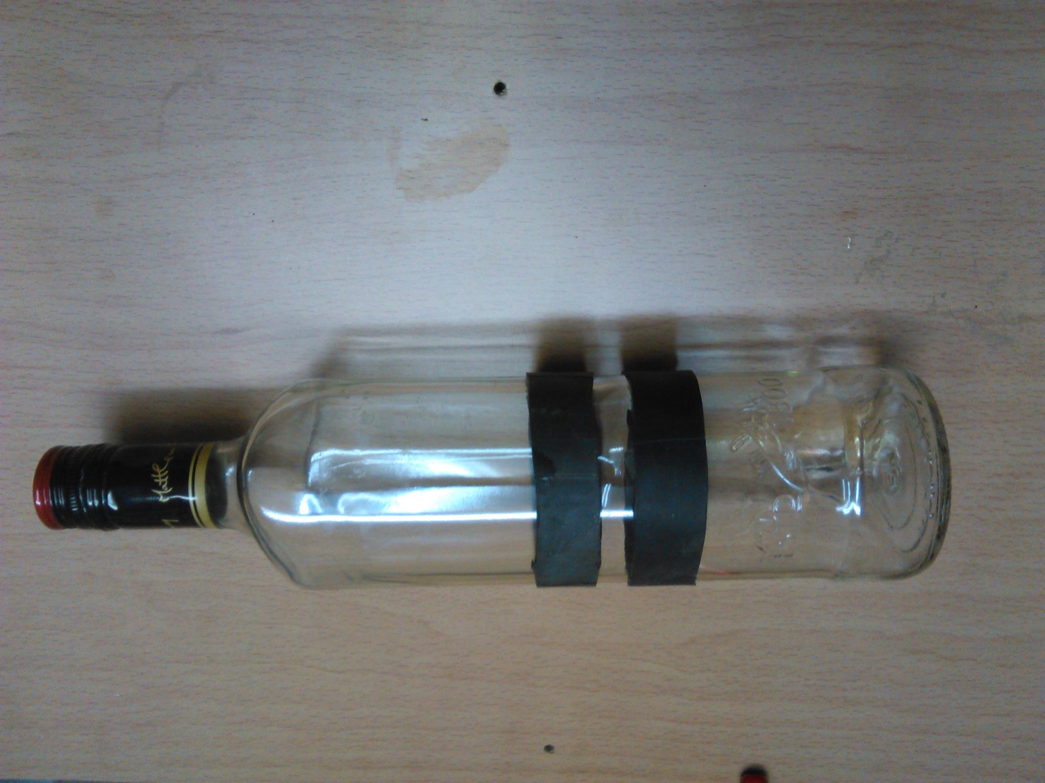

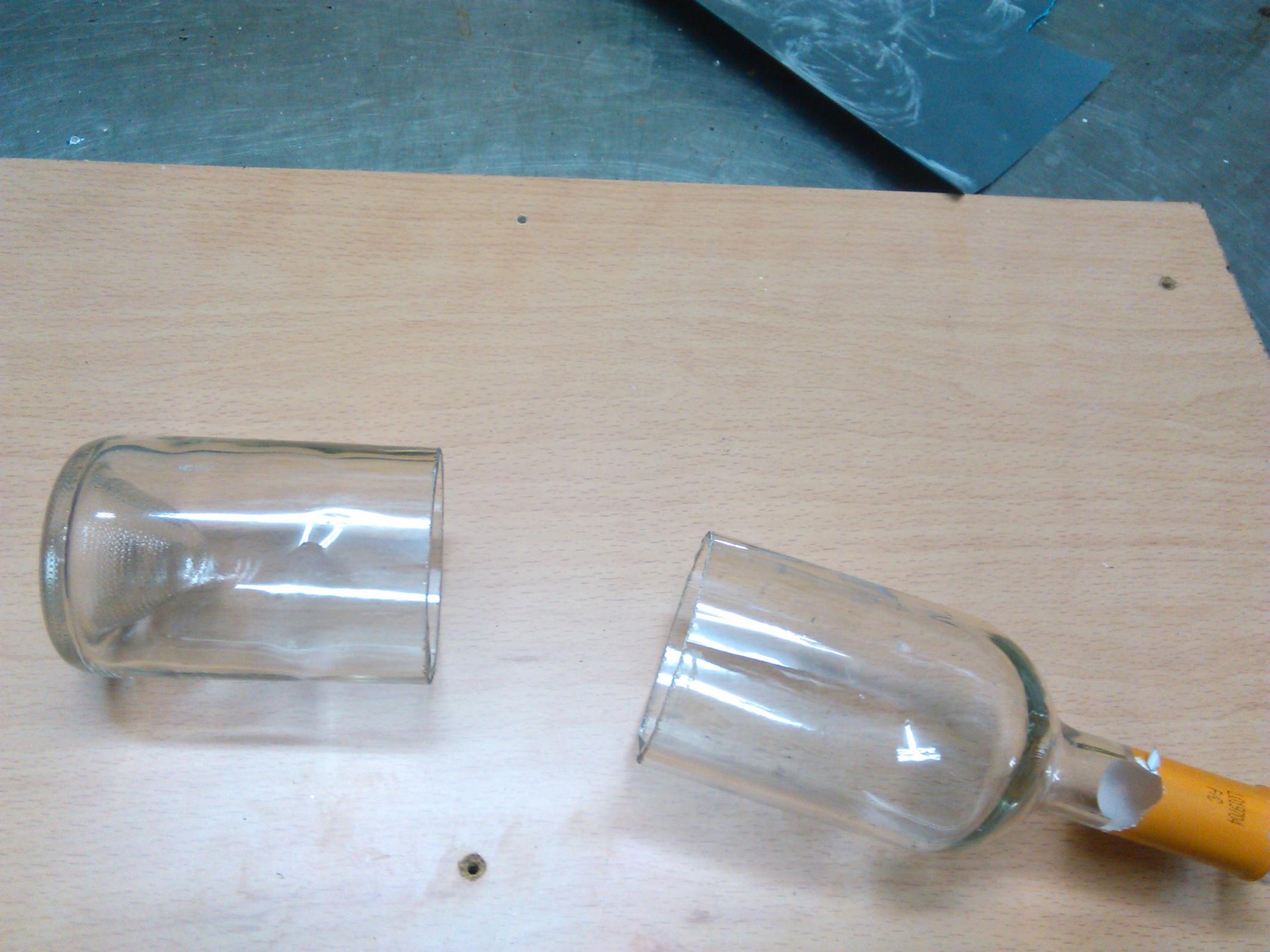

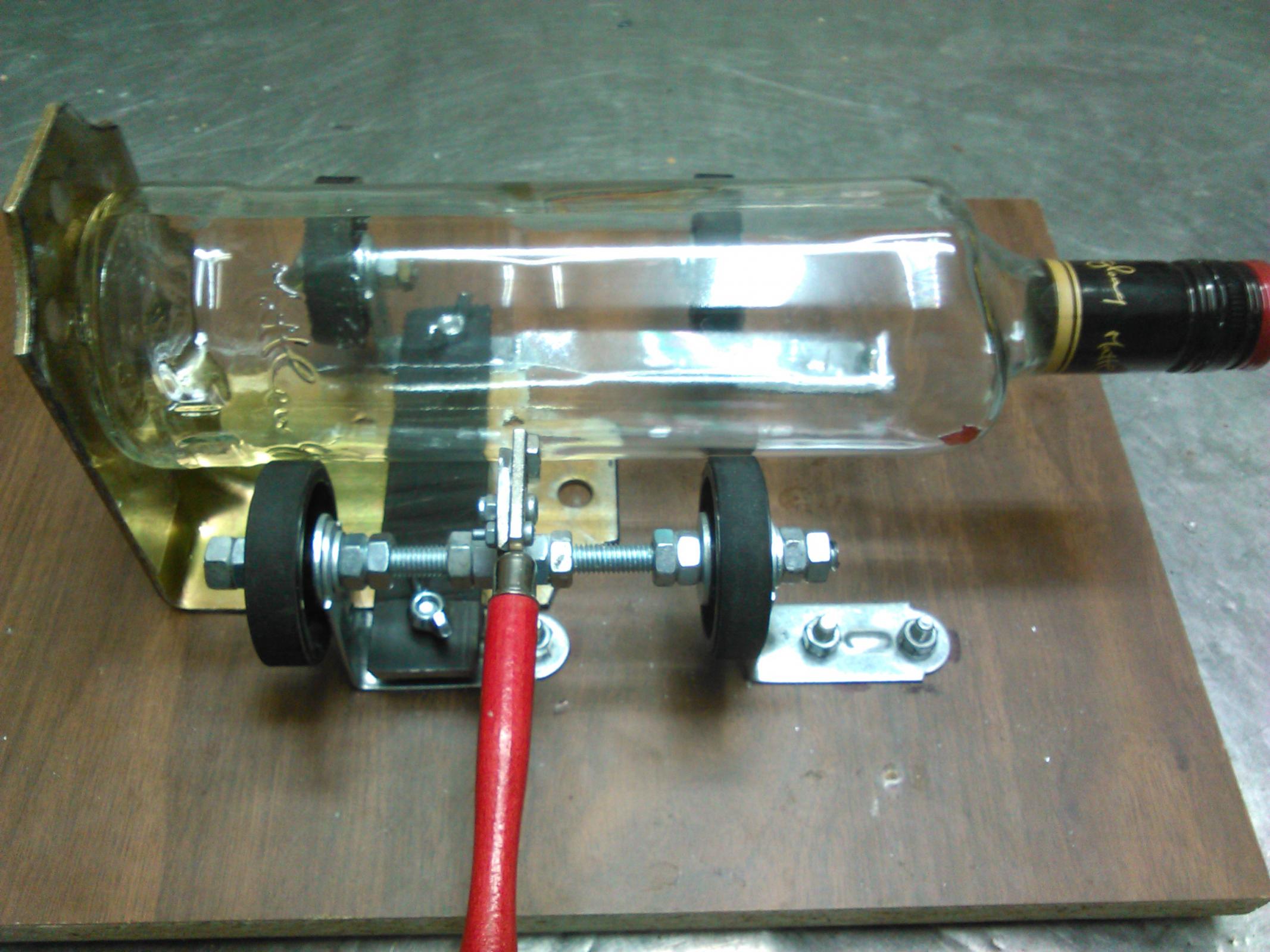

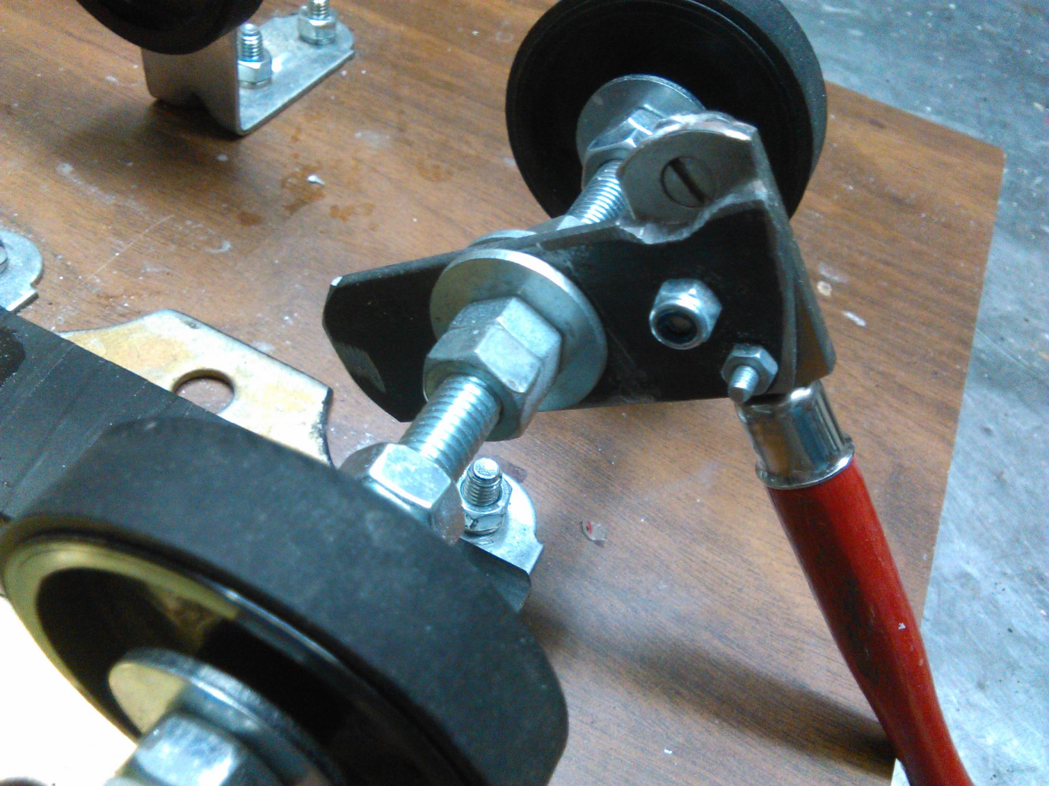

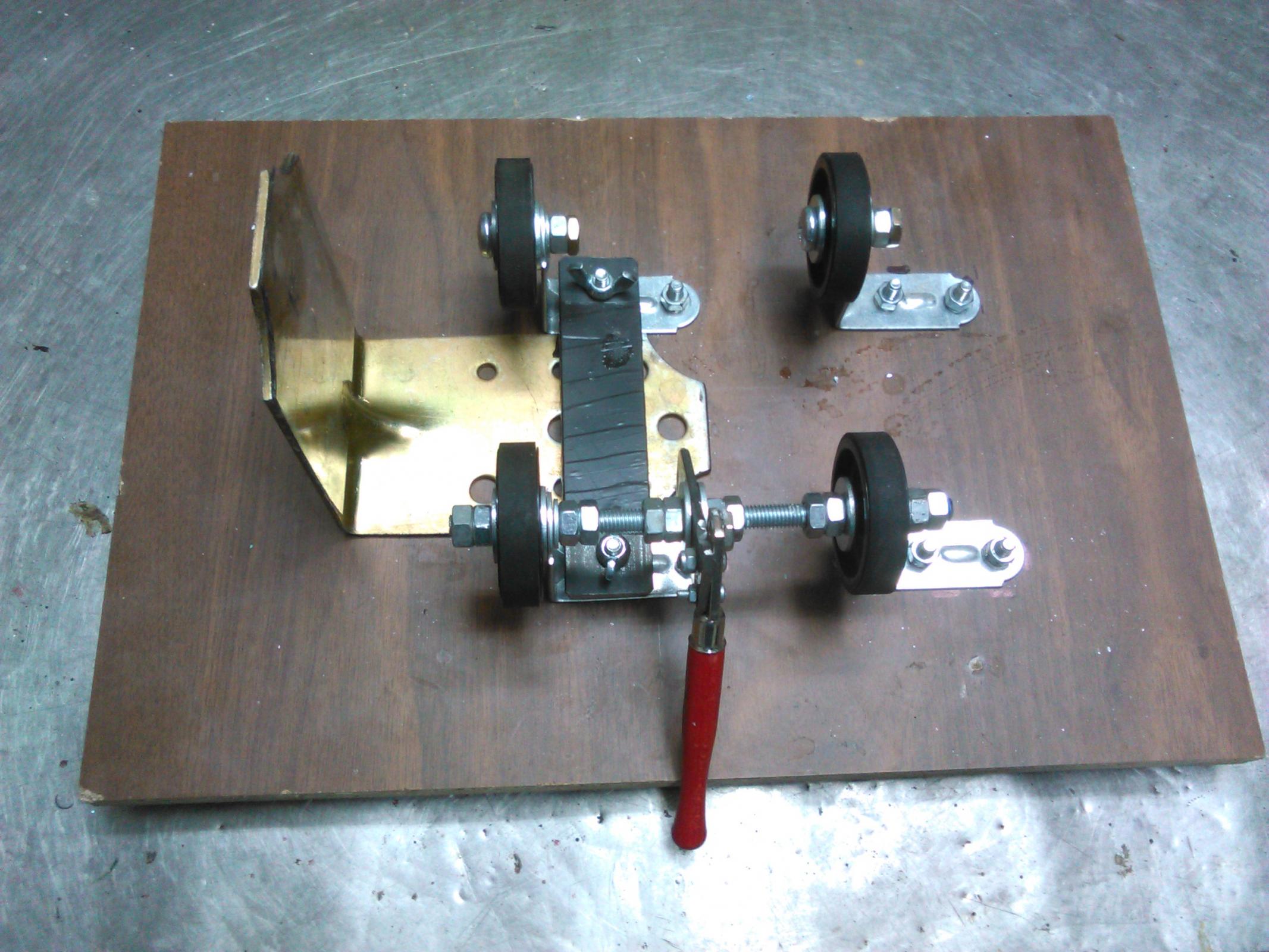

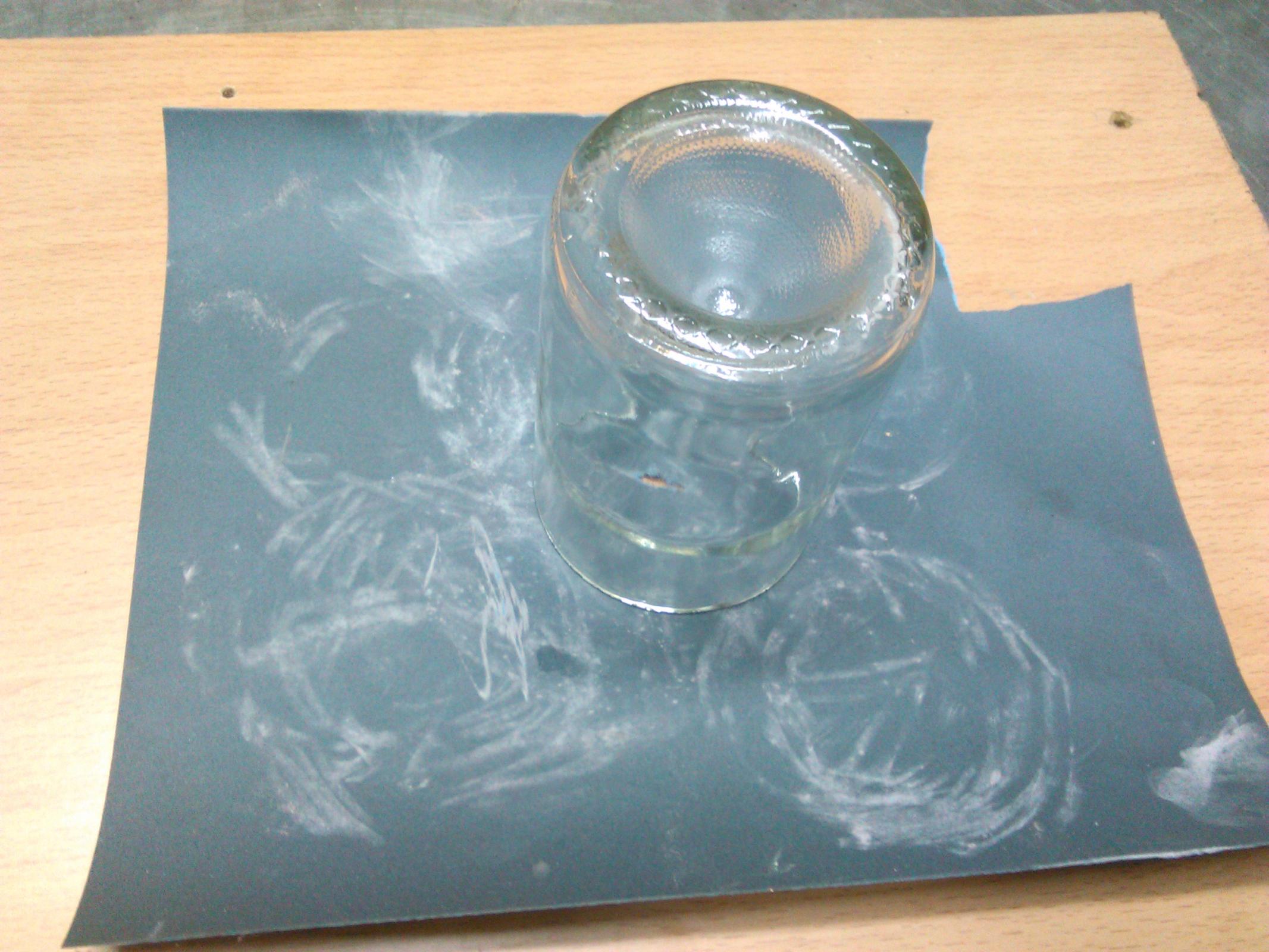

    After destroying several bottles i found the right way to use this homemade tool. First we cut a line around the bottle by turning it two rounds.Then we put along the line hot water and then icy water.We repeat 2 or three times and the item is
    ready. You can see here how this tool works. When you are surfing the internet you can find a lot of constructions witch are made from professionals.I made this tool in two hours but I spend alot of time to find the right way to cut the bottle.The last two photos are works that are made from proffesionals (not mine) with similar tool.
