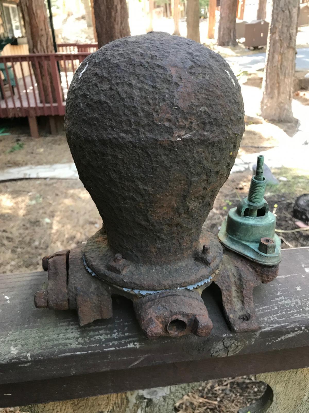

Great build. I think mine is over a hundred years old...
Attachment 39444
