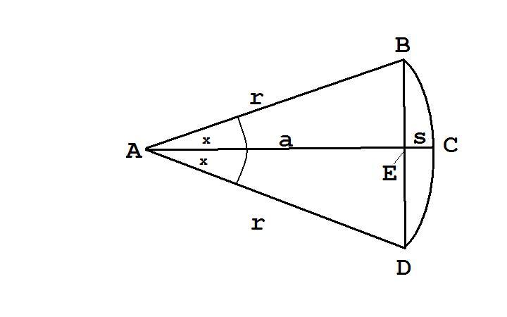

    A great many machining problems mathematically involve a circular segment. The components of a circular segment are shown in the diagram below...
    r = AB = AC = AD = a + s = radius of the circle
    x = angle/2 = half-angle of the segment
    angle = 2 * x = segment angle
    BED = chord of the segment
    a = AE = apothem
    s = EC = saggita
    arc = BCD = r * angle = circular arc of segment
    If two of these elements are known, it's possible to solve for the rest. The material below shows how to do this...
    NB: Note that when 'angle' is used in a computation, e.g. arc=r*angle, it must be expressed in radians, not degrees.

    The two cases (chord & arc) and (s and arc) occur very infrequently. I know of no closed solution form as above; however the program on my page will solve these cases with a convergent search algorithm.
