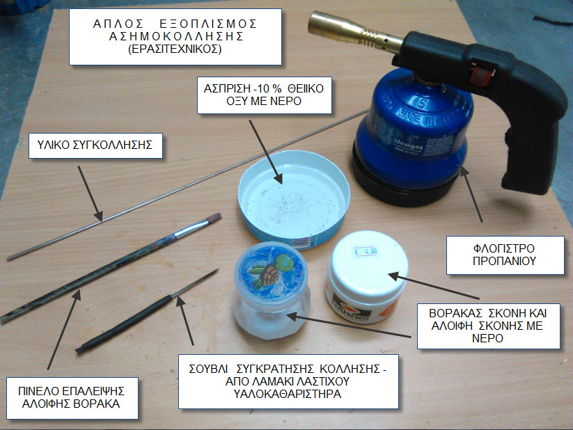

    HOW WE MAKE SILVER SOLDERING VERY EASY WITHOUT SPECIAL TOOLS

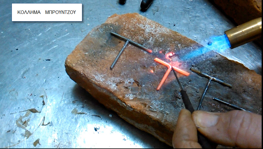

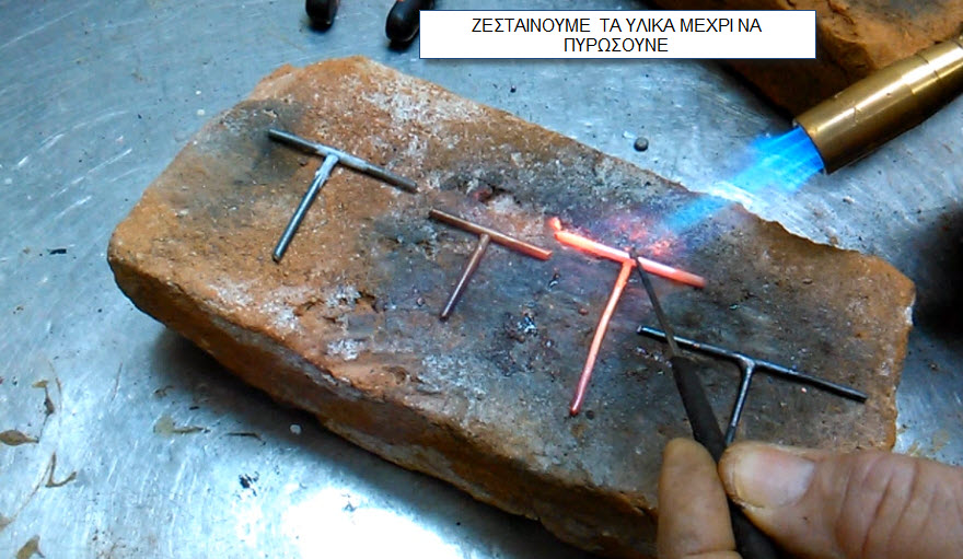

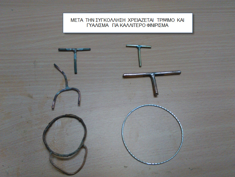

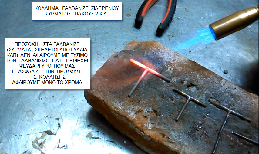

    We need a propane map gaz , borax,a piece of steel and a wire of silver soldering that is very cheap.We cut the wire in small pieces.We first heat the pieces to solder just to be orange and we heat small piecew of yhe wire over the two piecew for soldering.The piecew are connected very strong.Can solder copper with copper , copper - bronze , bronze - bronze and only galvanized iron wires. Very useful to the jewelry. You can watch this video and you can try to do the same. It'w very simple and you don't need special tools.
