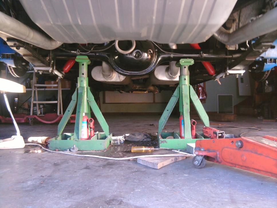

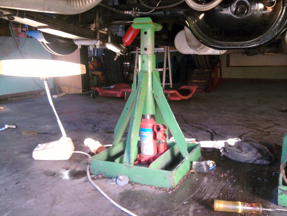

Having hit my head several times while shooting around on the creeper i decided to make some elevating jack stands to give me extra clearance without compromising stability of the car. This is what i came up with using angle iron and some 1 tonne bottle jacke.Attachment 104Attachment 105
