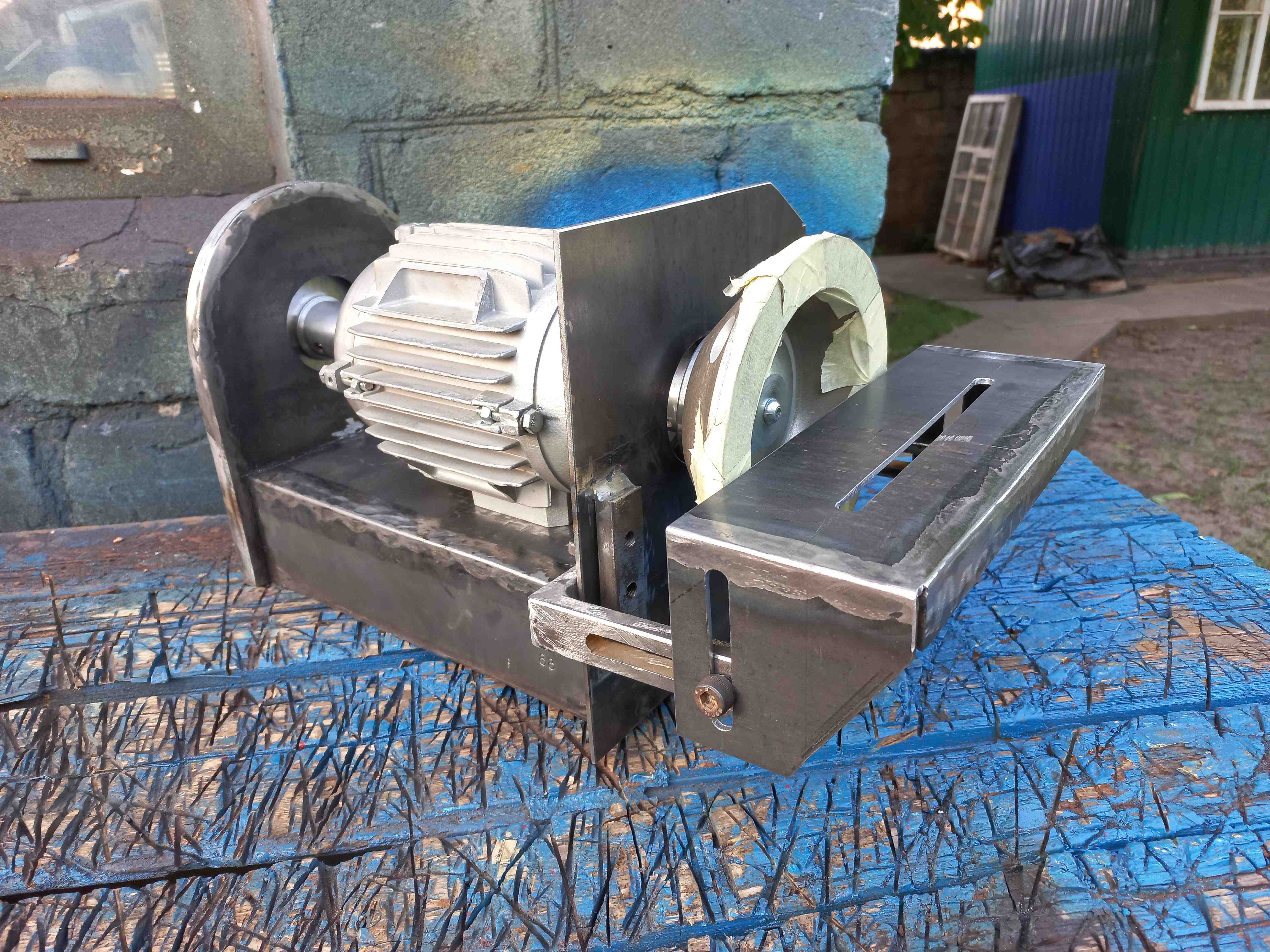

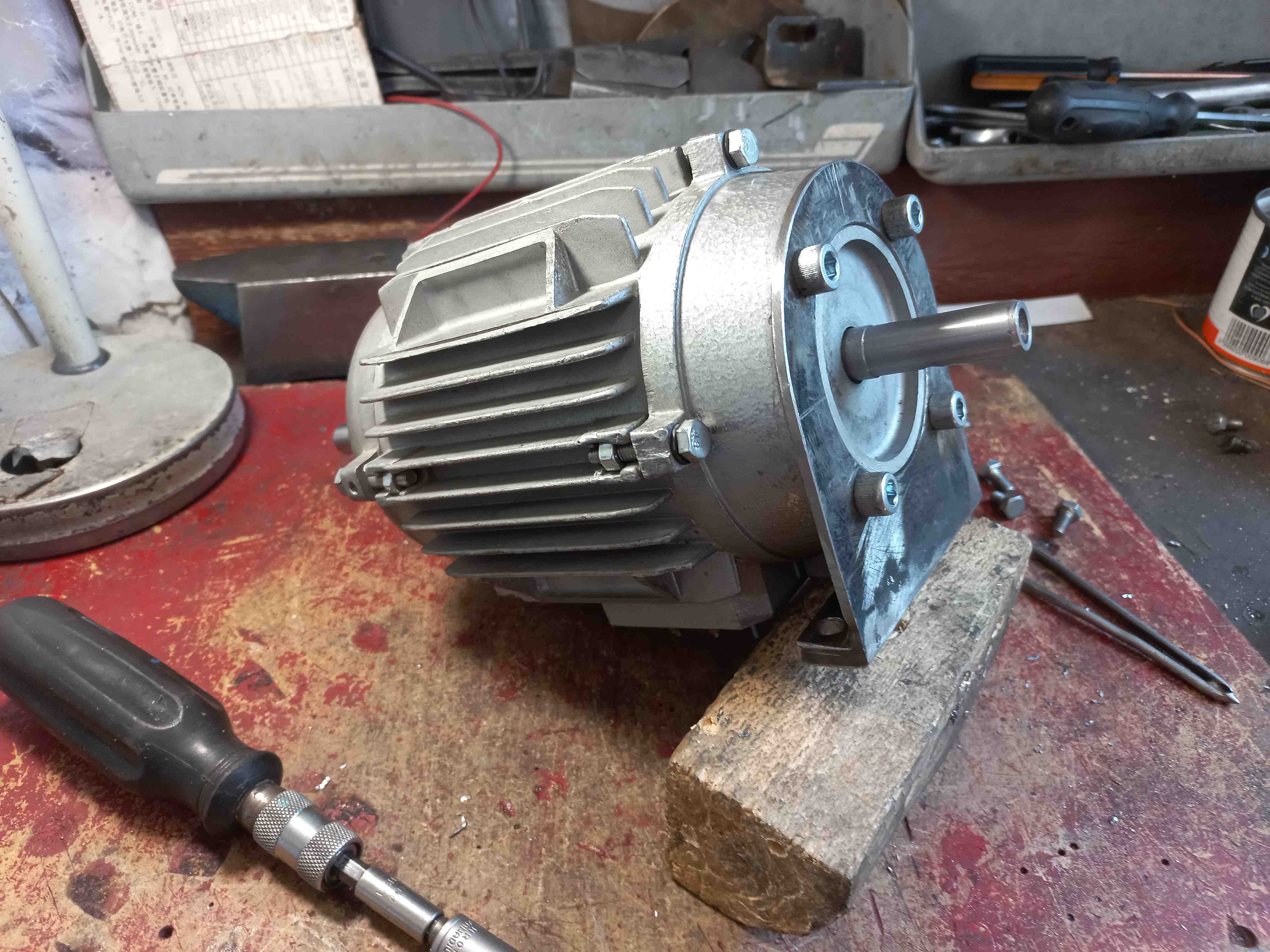

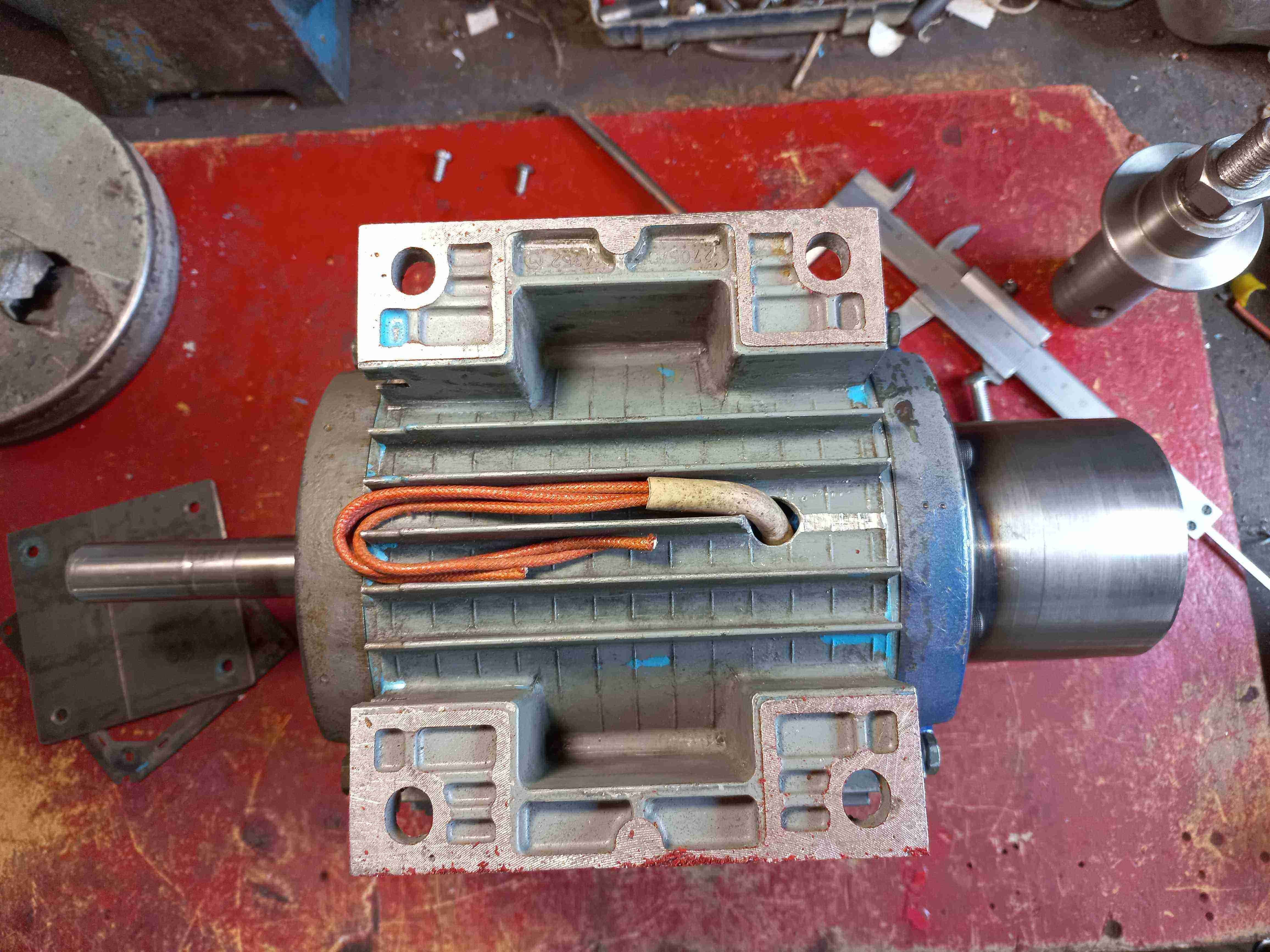

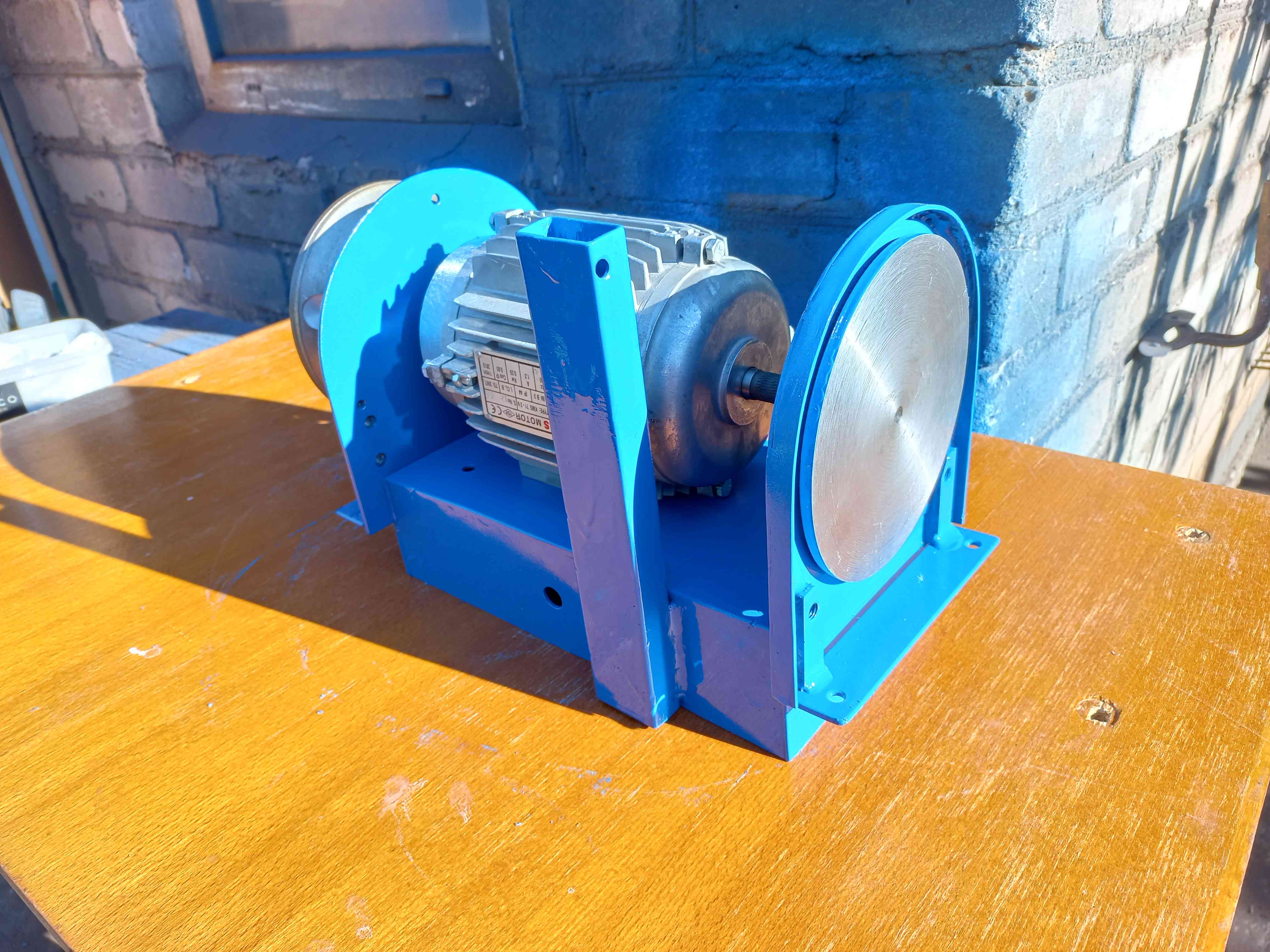

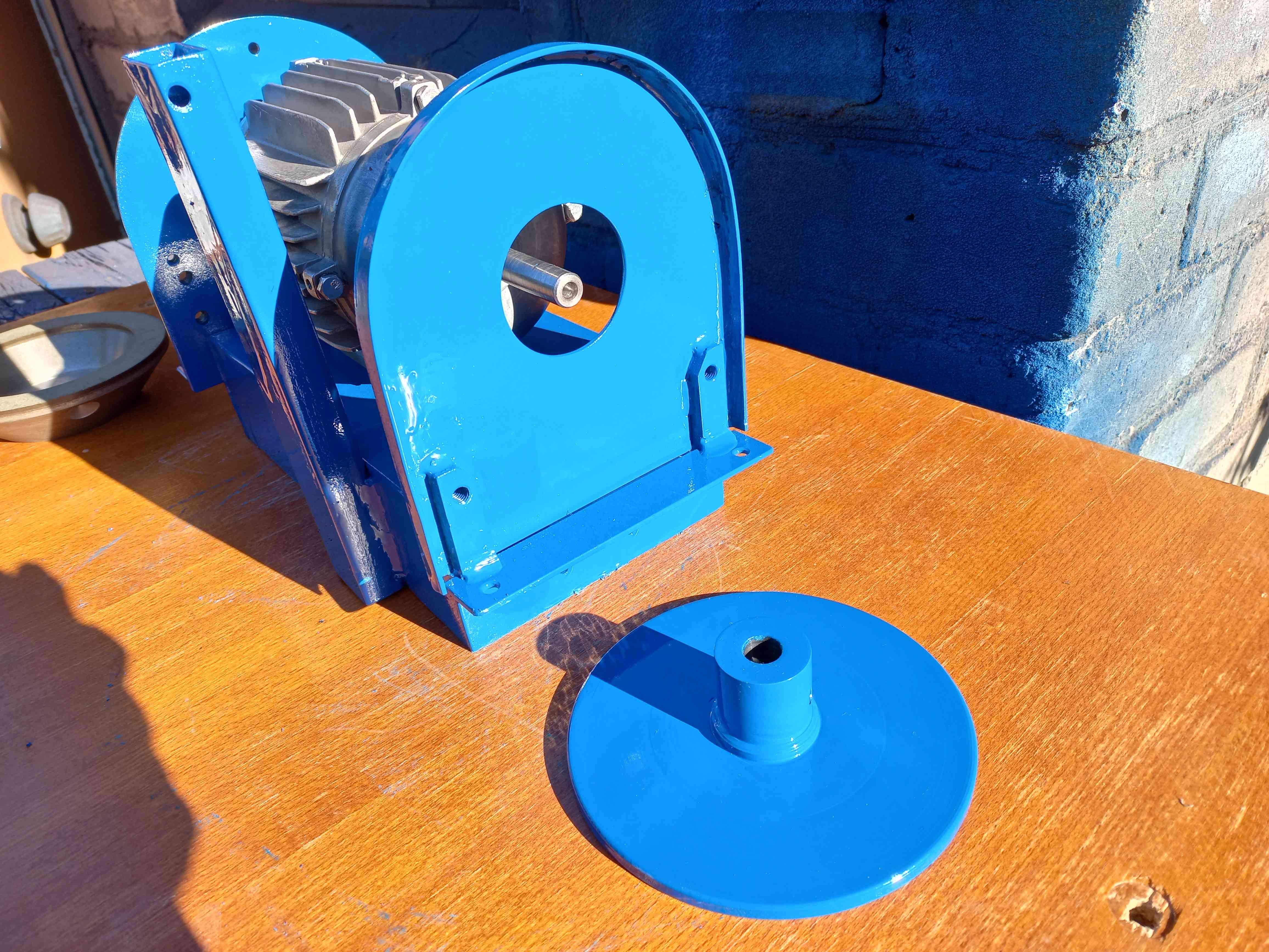

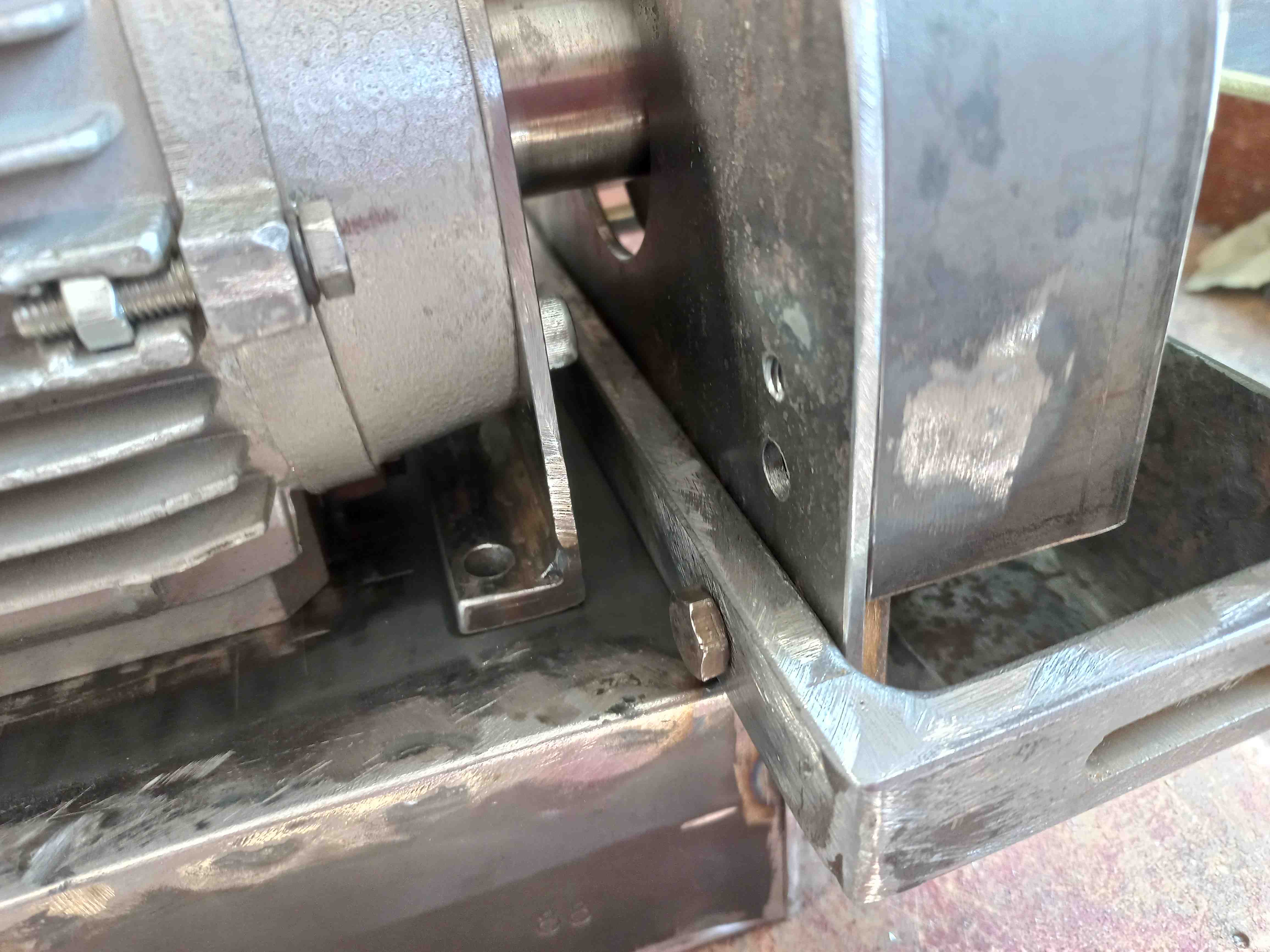

Always impressed by the variety, which I'm guessing hangs on motor you find; single or double end. Most (all?) are footed, so making one left handed like this considers rotation. The double ended with extended shafts, still favorite, being so well balanced to run vibration free. That's serious craftsmanship.
Thank you.

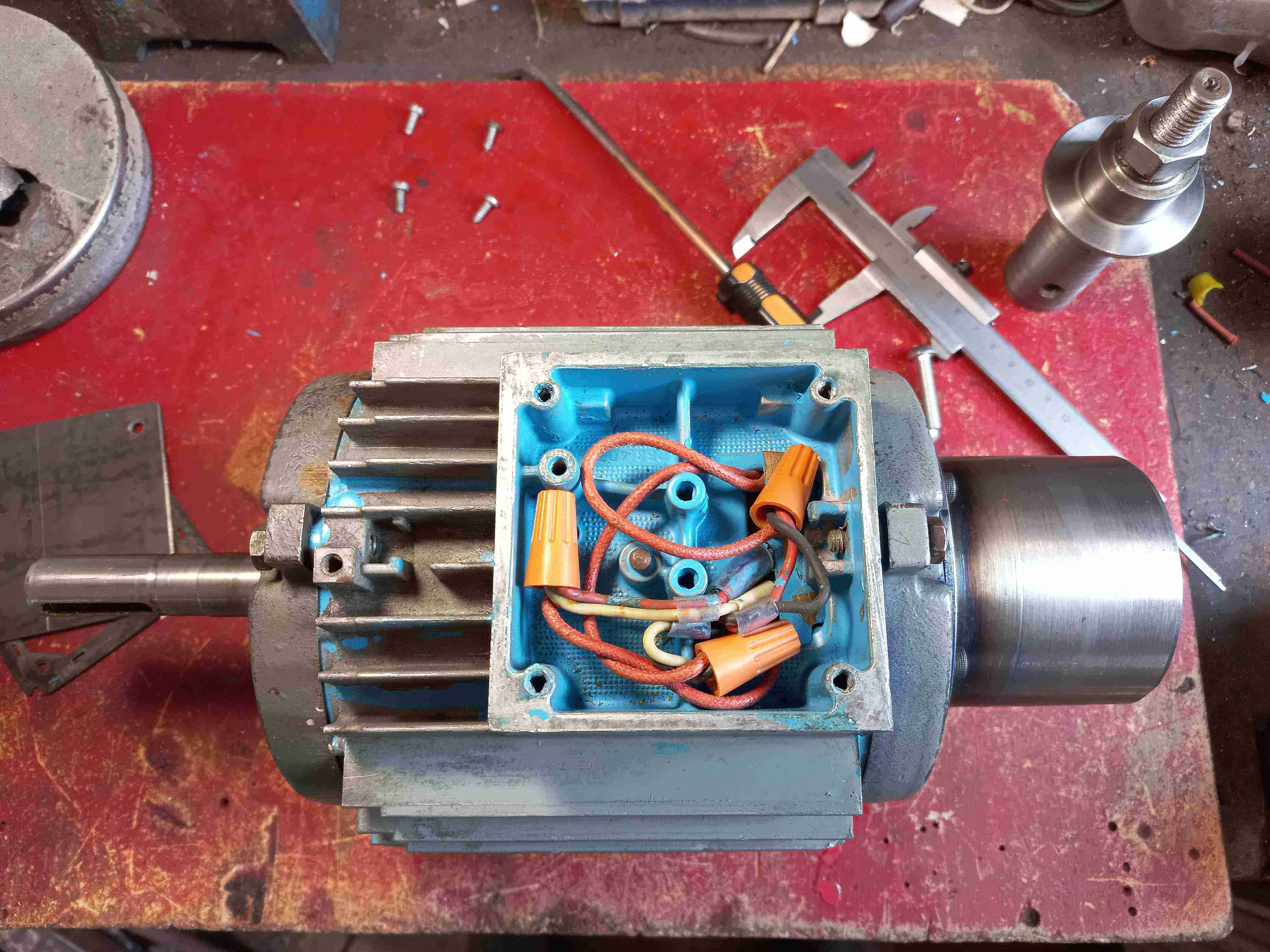

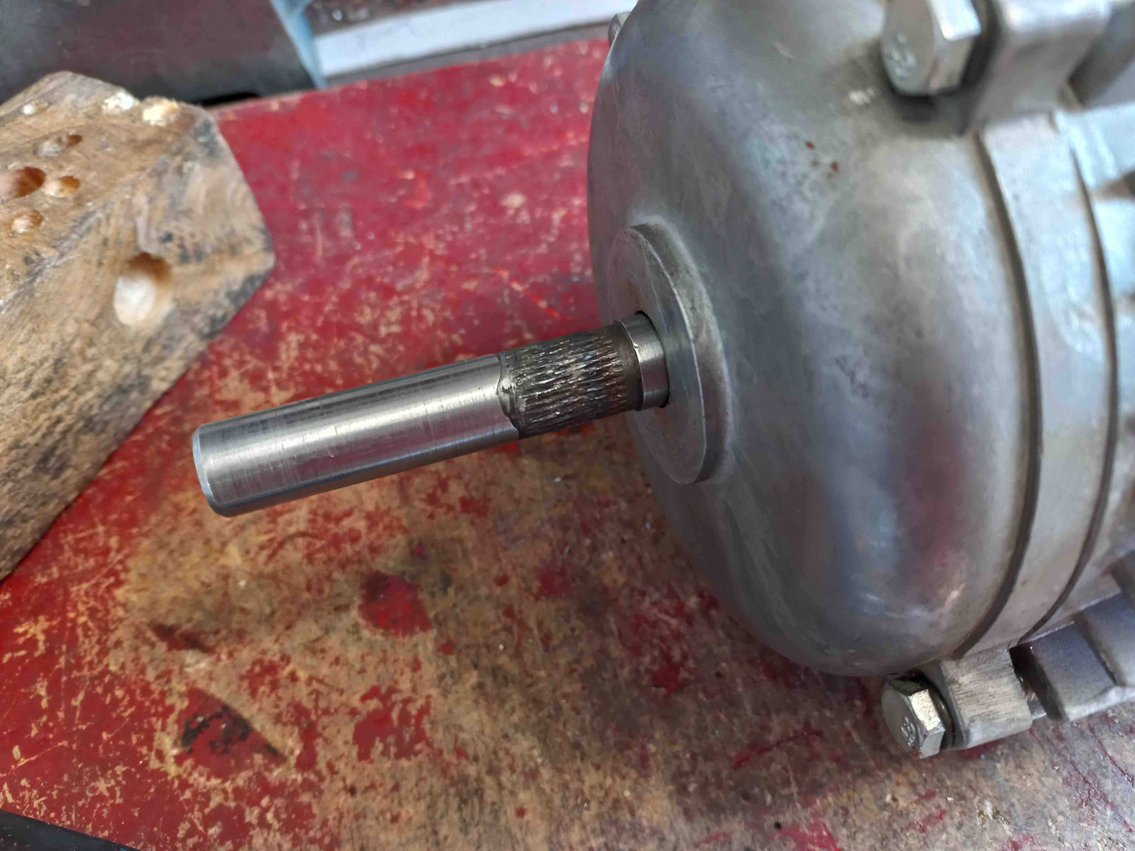

I don’t always have electric motors with shafts on two sides. As a rule, if there is no way to extend the shaft, then I add it. We weld it with electrodes of brand 13-55 LB52U
Then on a lathe I make it to the size I need. Soon there will be a machine for a diamond cup.
When I do it, I'll post a photo of it here on the forum.

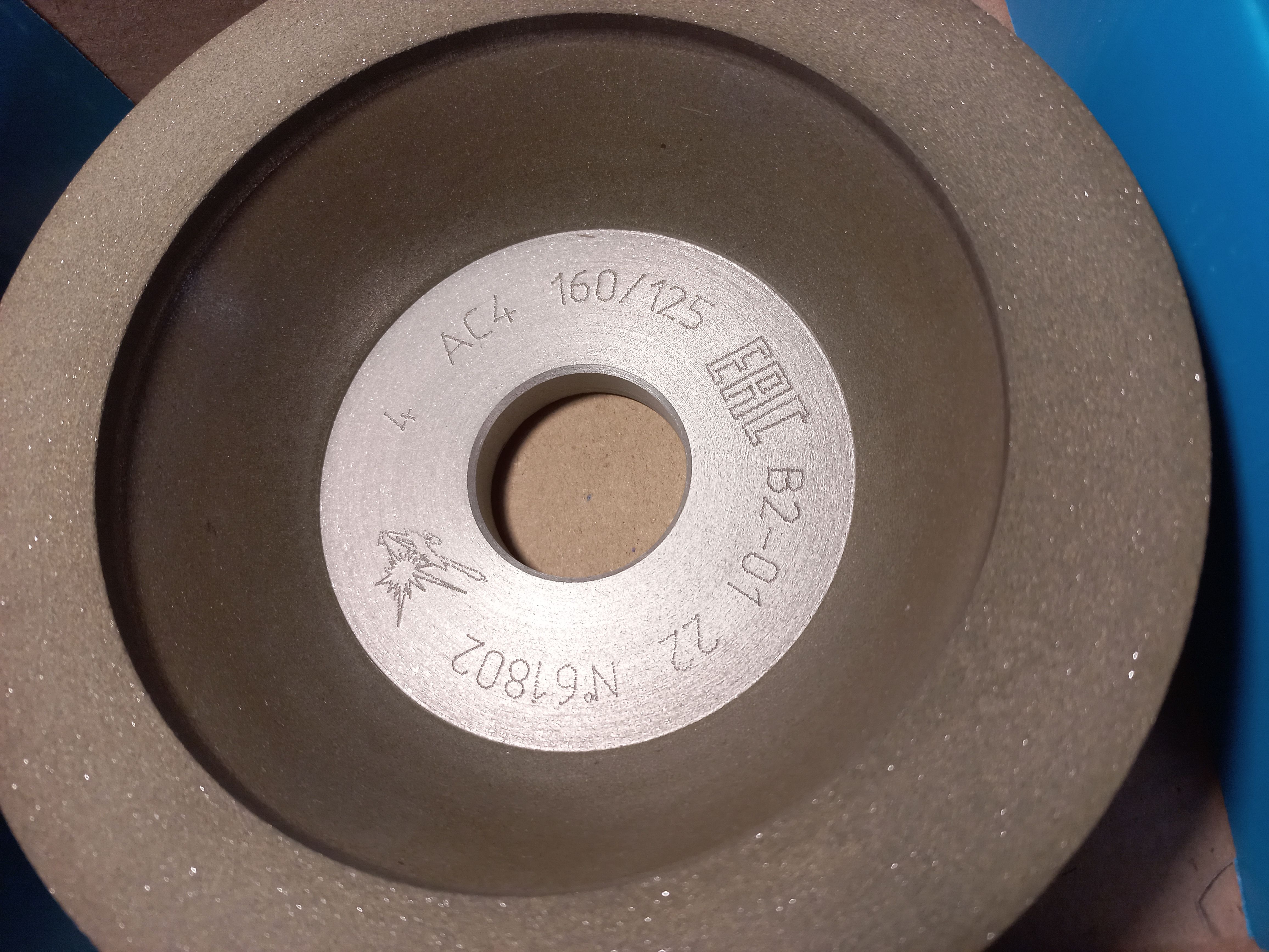

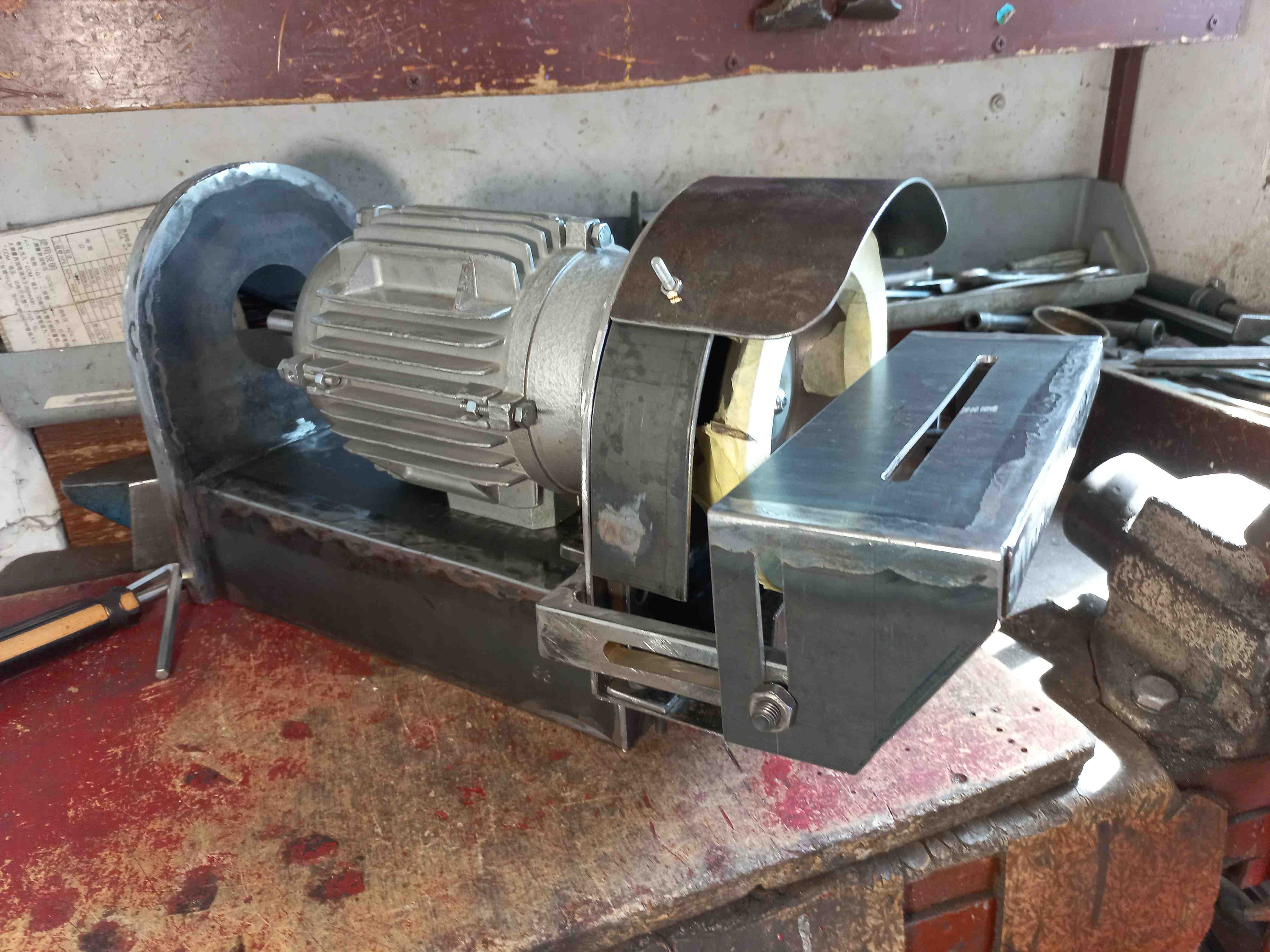

That 13-55 LB52U prompted me to go look. It's in the carbonaceous low alloy range, sounds ideal for motor shafting. also found a 24 page PDF on unfamiliar rod designations at https://www.kobelco.co.jp/english/we...nd_edition.pdf
Cup wheels are my most frequent consumables, grinding wise. That will be interesting. I'm set up to re-sharp ends and flutes of straight, tapered & ball end cutters, having one dedicated to a single operation would be advantageous.
This is a machine that I make for one person.

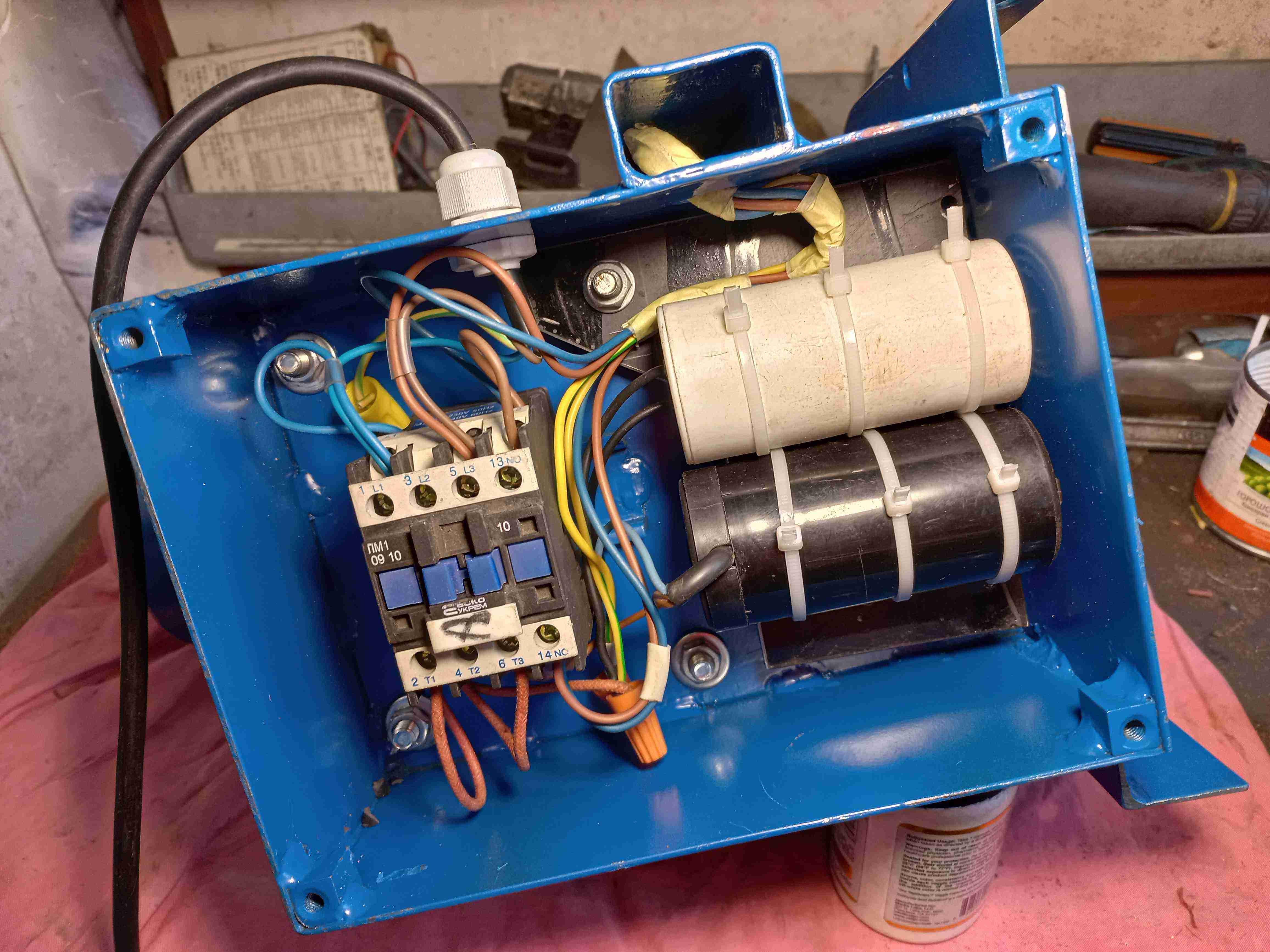

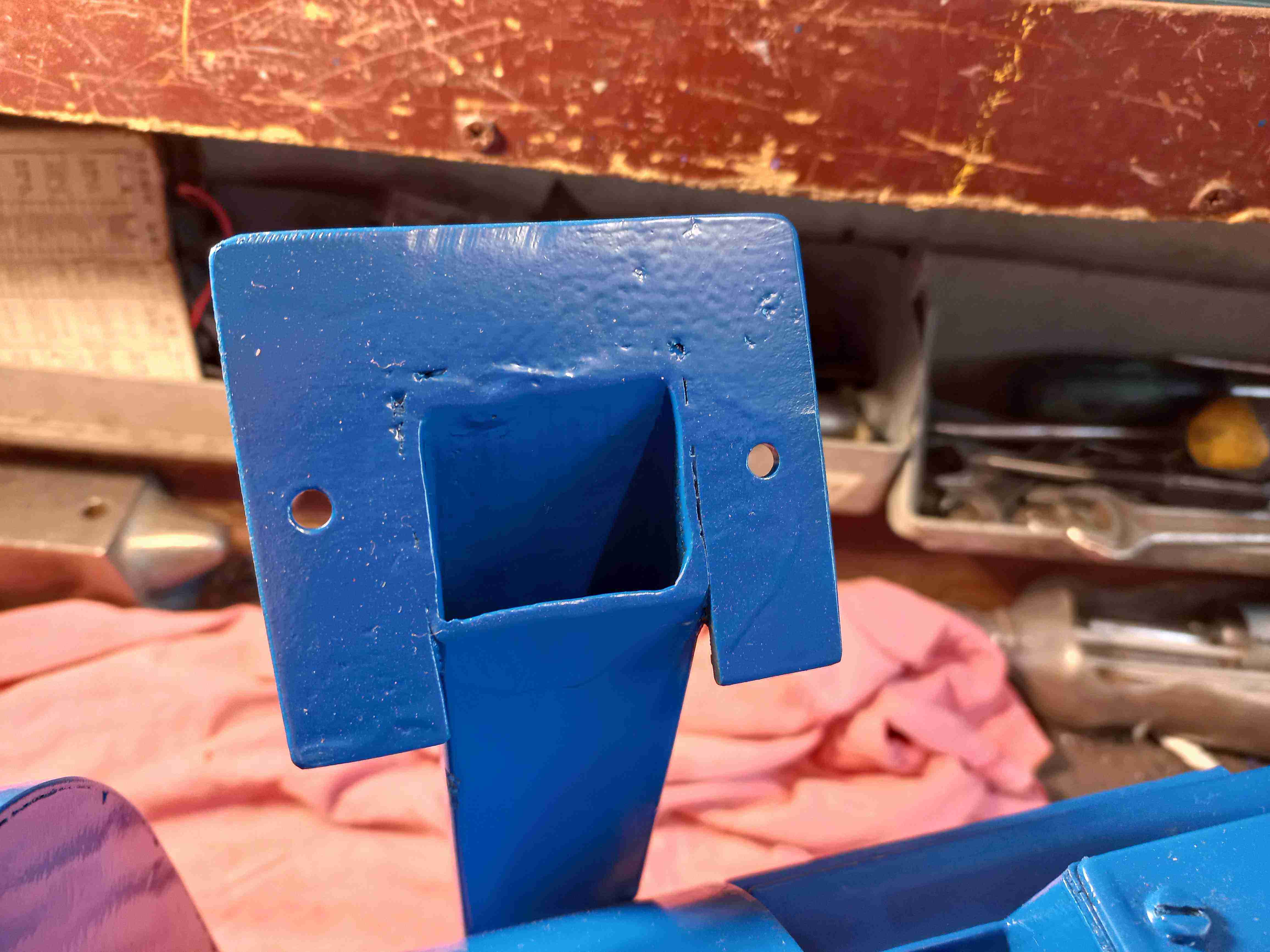

Attachment 43631Attachment 43632Attachment 43633Attachment 43634Attachment 43635Attachment 43636Attachment 43637

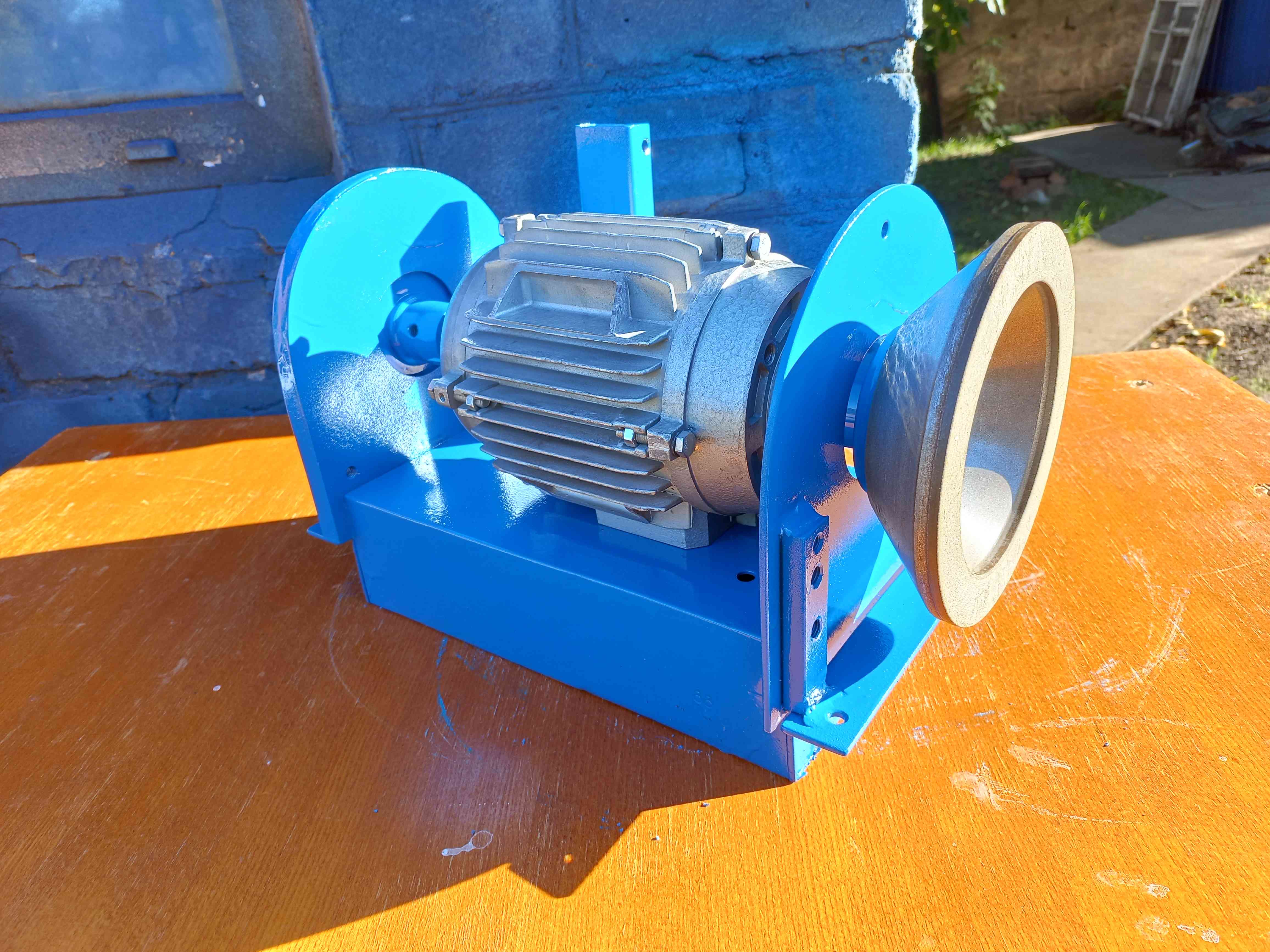

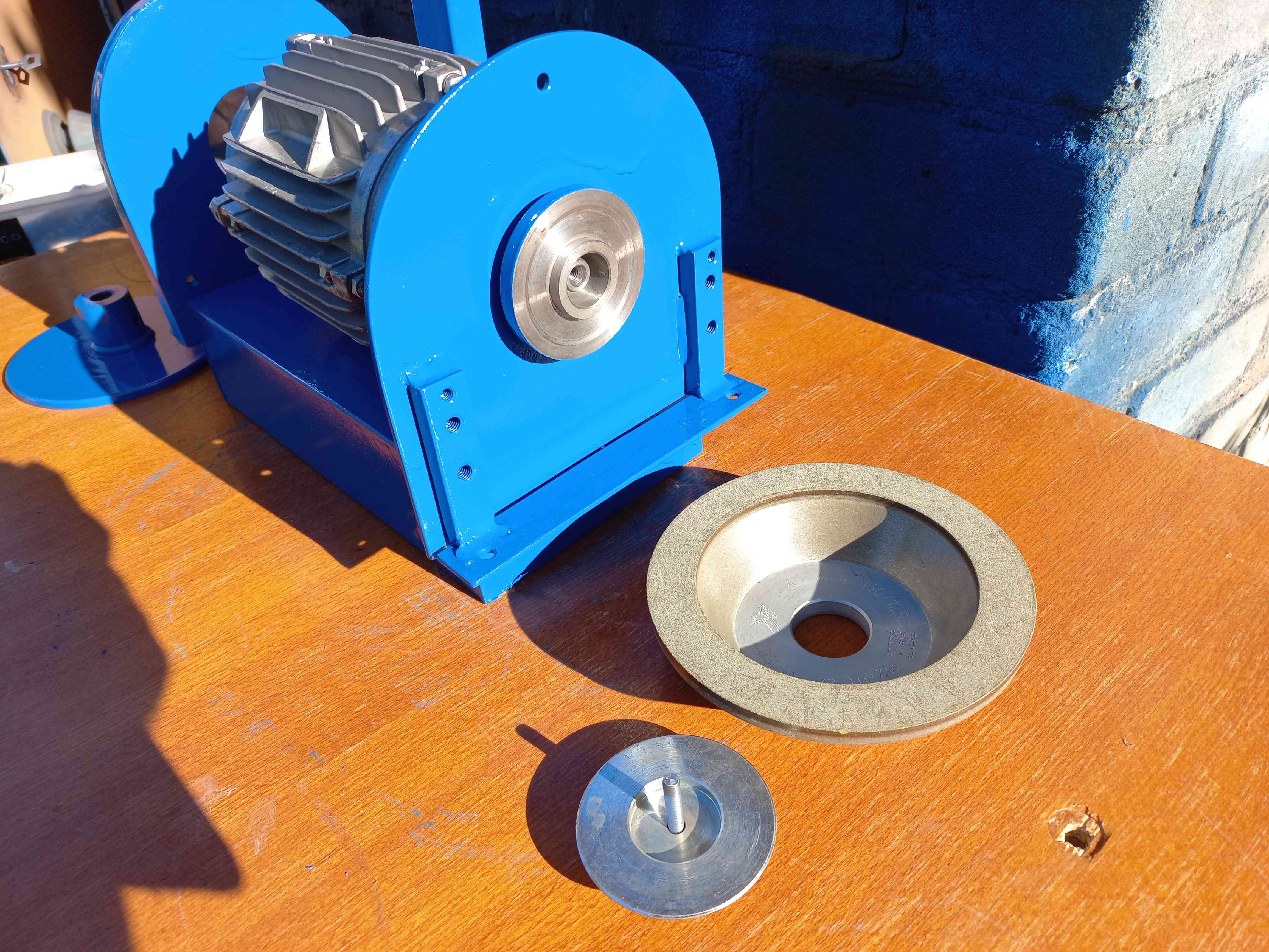

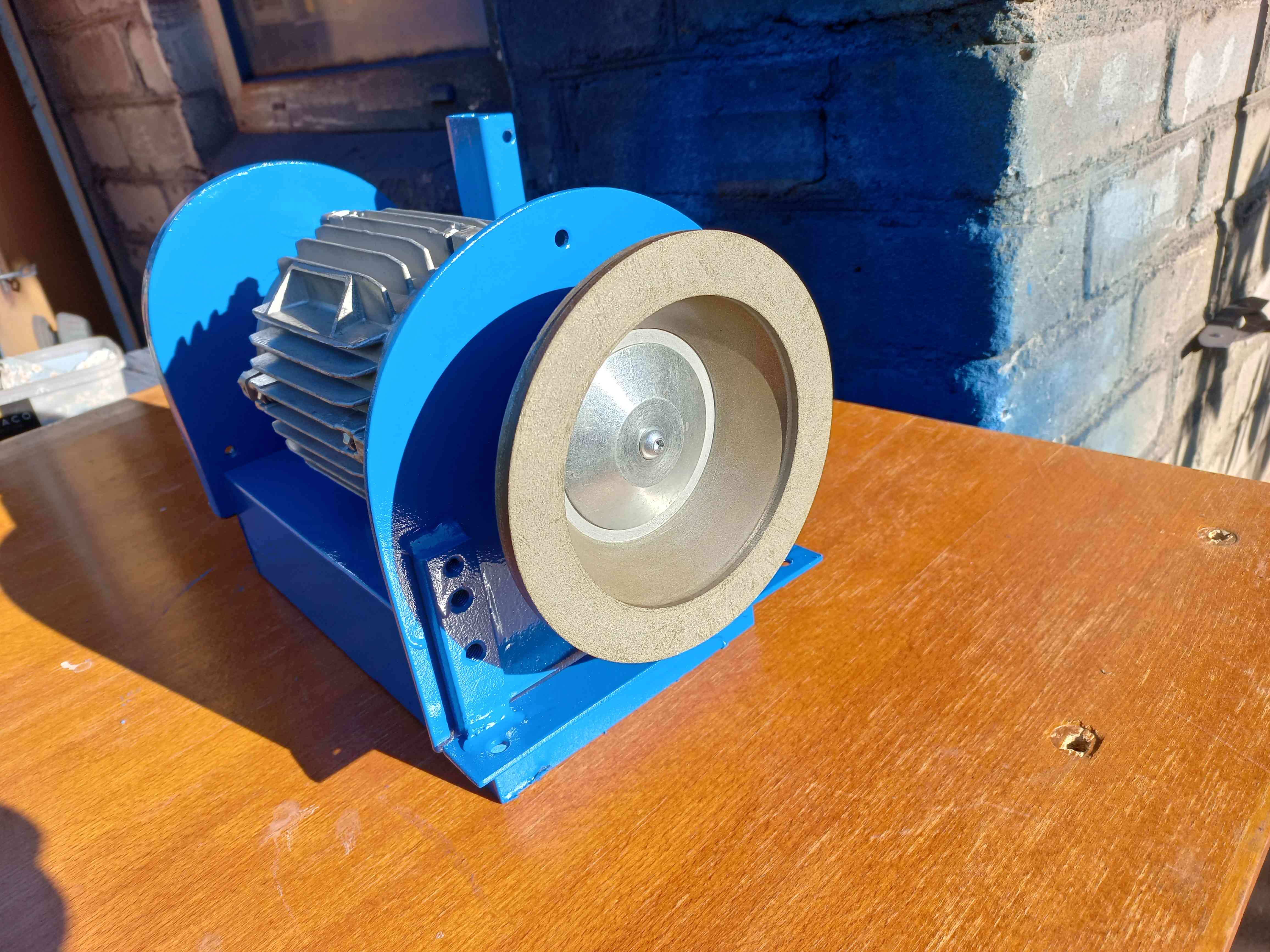

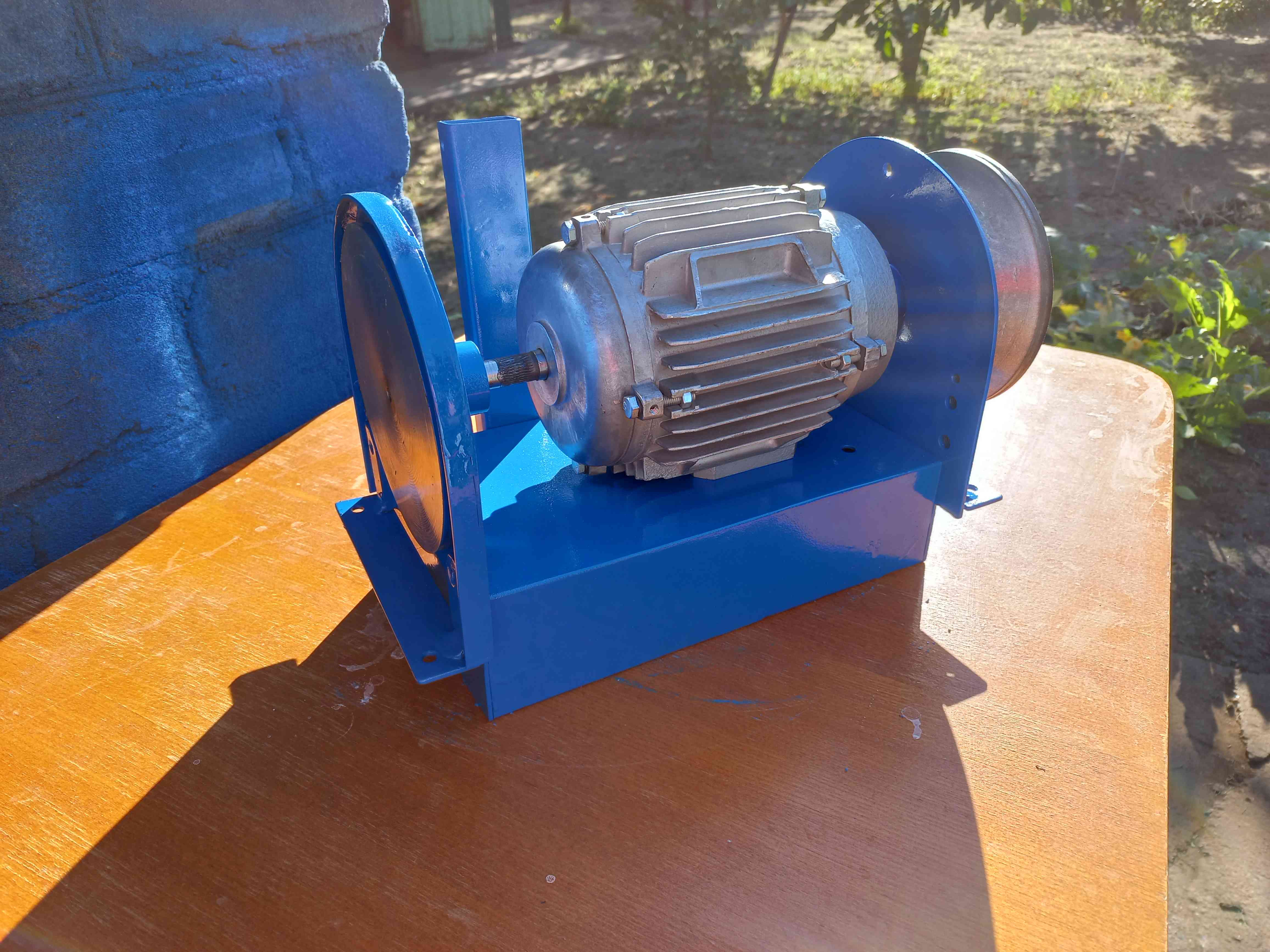

such a diamond cup will stand on one side
Attachment 43638
What do you mean when you say such a wheel will stand on its side? No offense intended, but a little confused by that statement.
I meant that on one side of the electric motor there will be a diamond cup and on the other side a grinding disc. How it will look look at the photo.

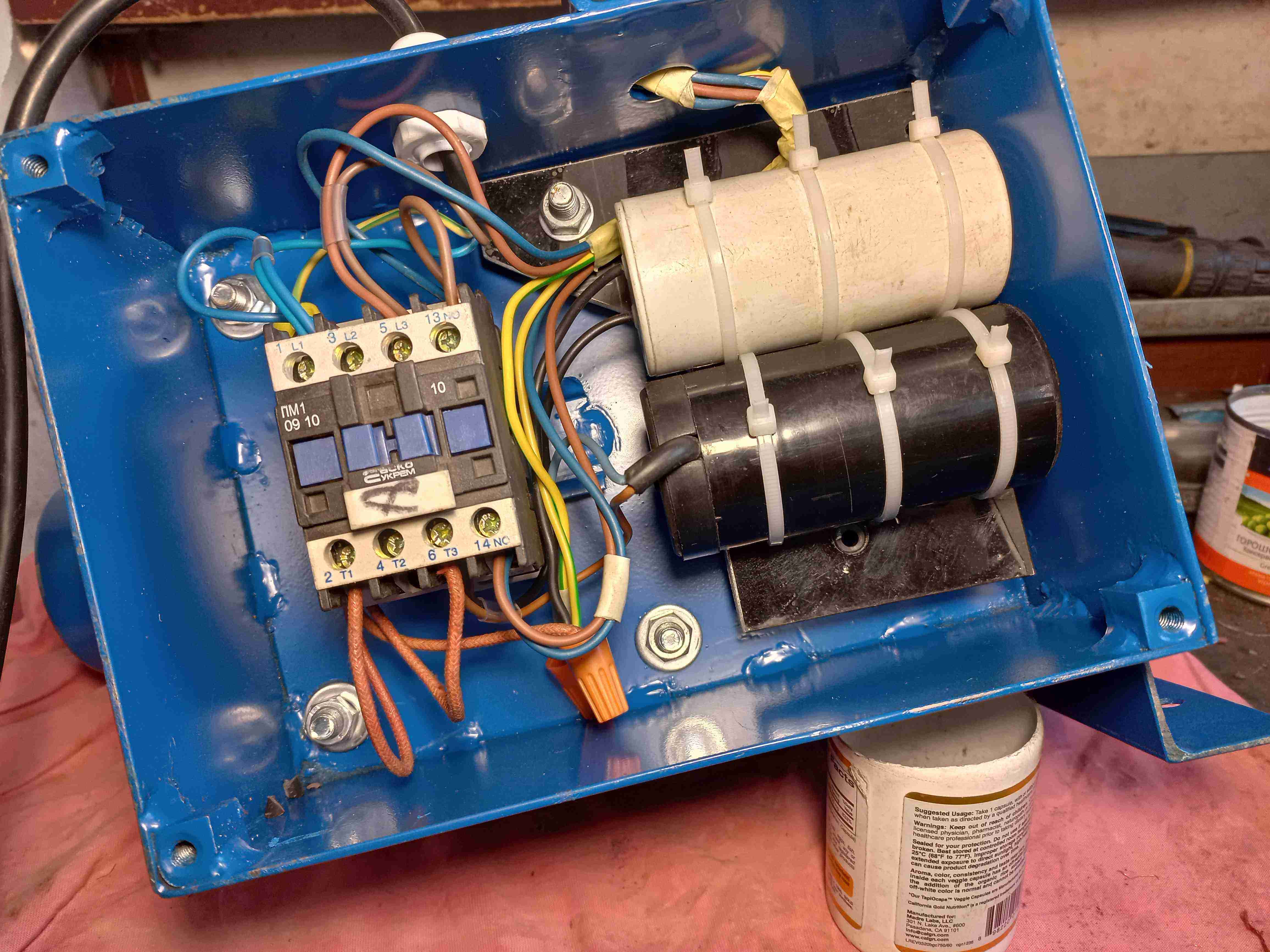

Attachment 43655Attachment 43656Attachment 43657Attachment 43658Attachment 43659Attachment 43660

2. I have been wanting a grinder with a cupped wheel for a long time. My reading has made me wonder if CBN wheel would be better for my needs than diamond.

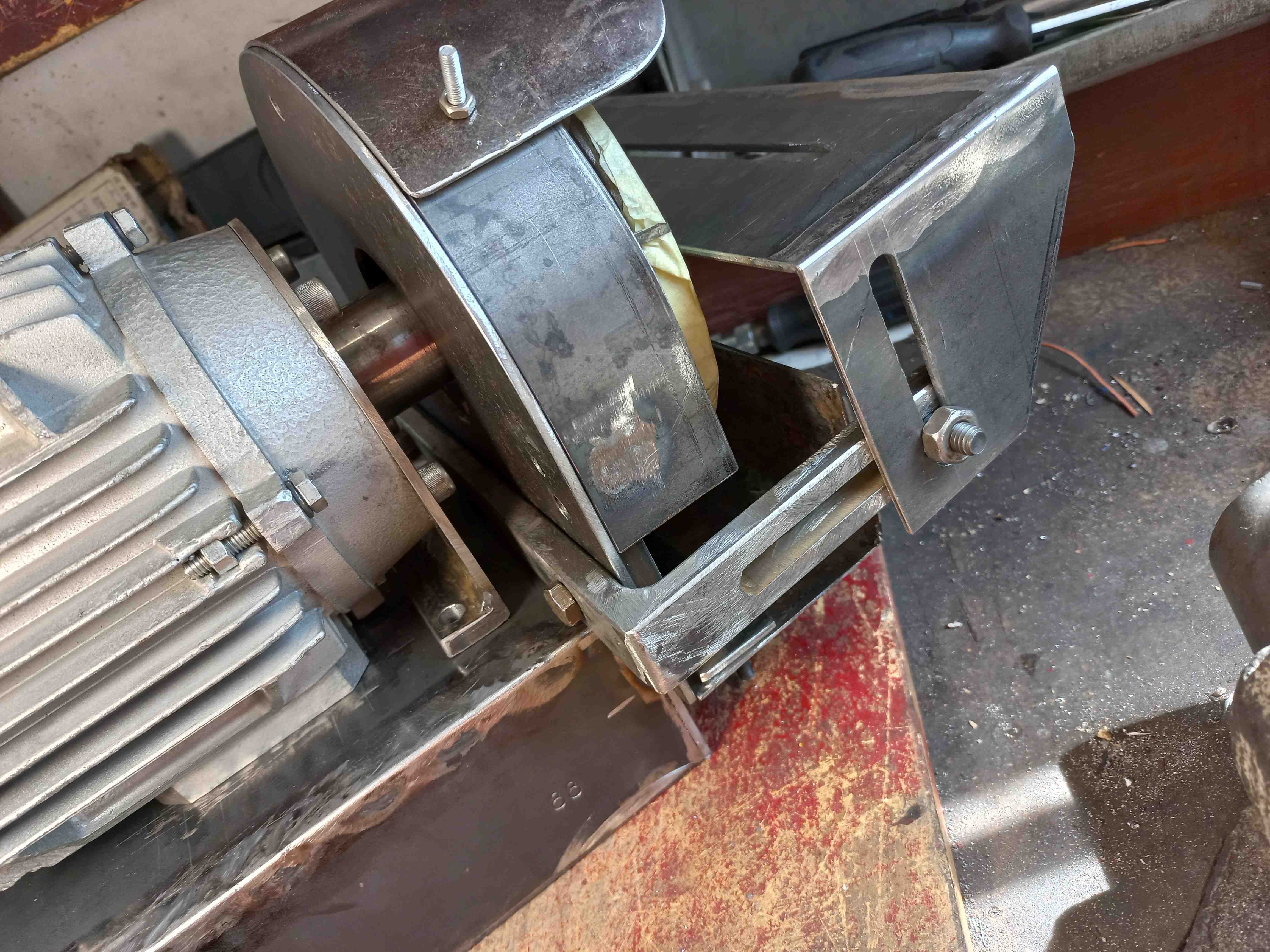

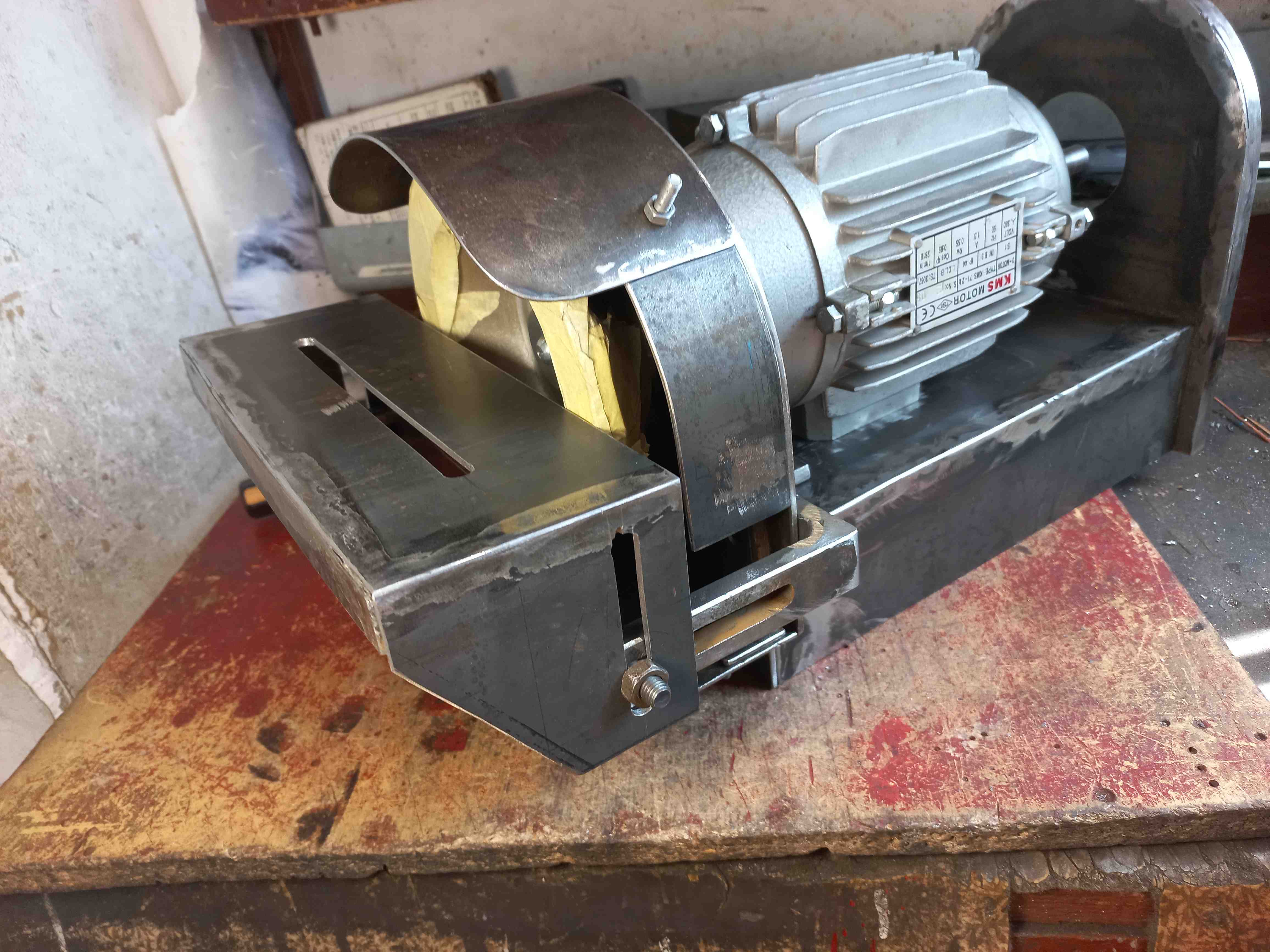

3. It took me some time to look through all 19 pages of this thread. One thing that caught my eye was gluing a regular grinding wheel to a disk so you can grind on the flat side of the wheel. Did this work well? I would worry about doing that, but I like that idea.
