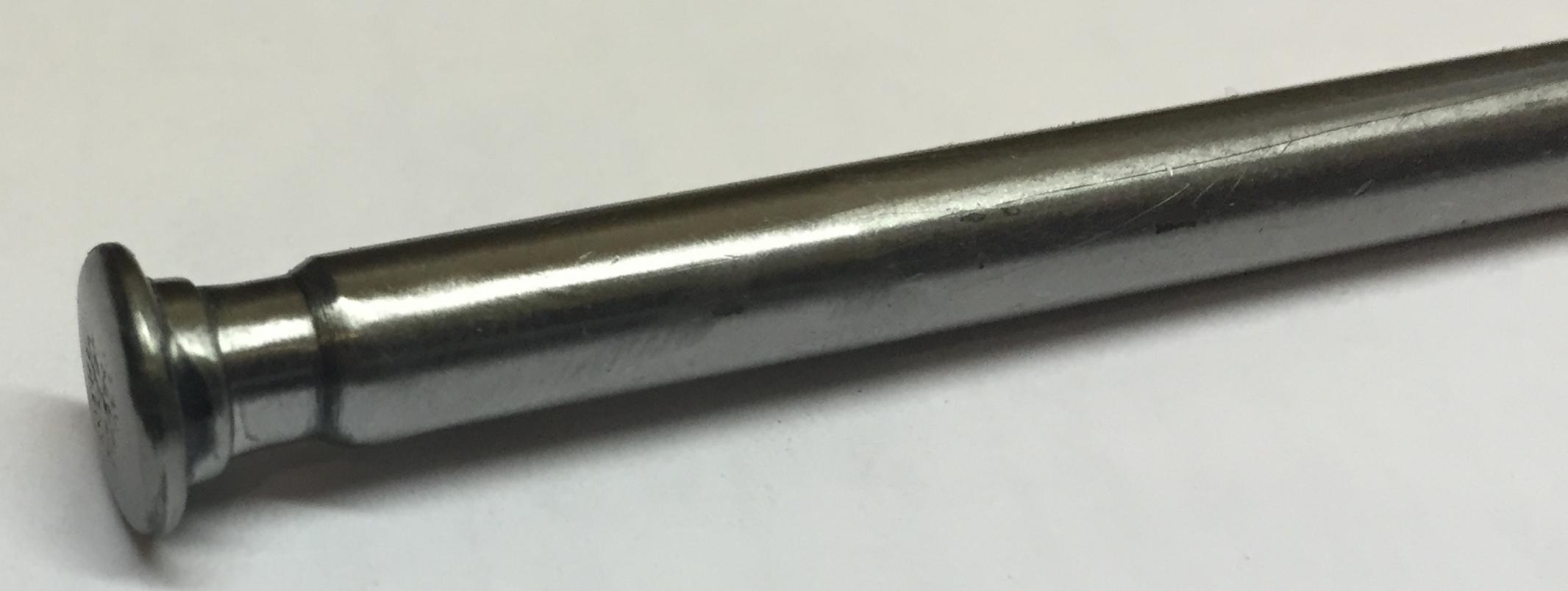

    Inertia Forming on a Lathe
    This video shows how to use friction to form a disk on the end of a rod.Inertia Forming on a Lathe-close-up.jpg

    Was the inertia welding technique you were seeking related to friction stir welding?

    I love this trick Rick, thanks, will certainly find use for that, although my lathe cannot go as fast as yours ... maybe a little help with a torch ?

    You are right about adding this to our bag of tricks and finding a future use. We may need to use Christophe's suggestion of assisting with a touch.

    I've already used this trick to make blind threaded inserts. Article is out but have not submitted it to Homemadetools yet.

    Hi Rick - not sure whether Jon has experienced this but in my up to date Firefox, this is second time an embedded YT video didn't show. Fortunately the URL showed in this reply so went direct to watch. I'd have expected a YT video to have ''embed'' within the URL usually, or be in an iframe.
    Nice idea with the forming method - certainly more regular finish than ordinary peening.

    A word of caution. Touching the workpiece before the lathe stops turning can lead to some interesting cuts and wearing a ring is a real bad idea in a machine shop.
