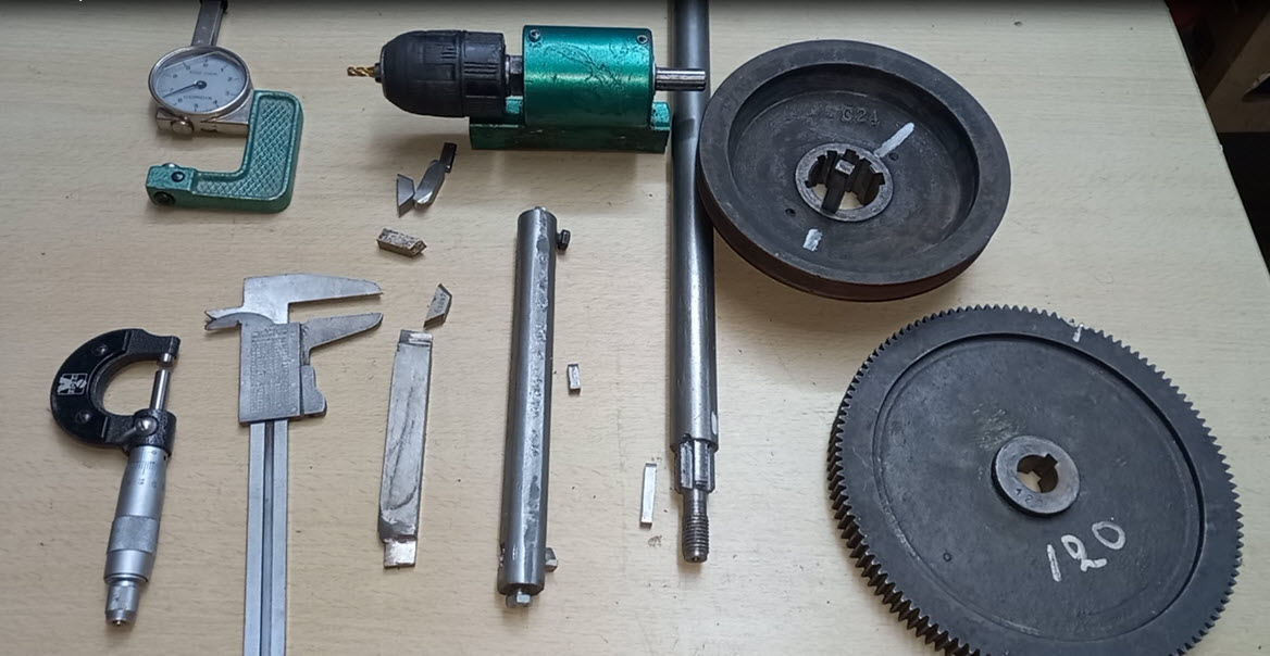

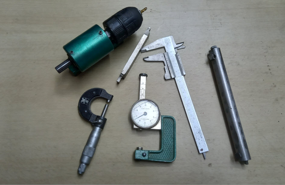

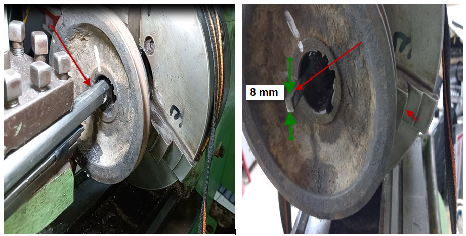

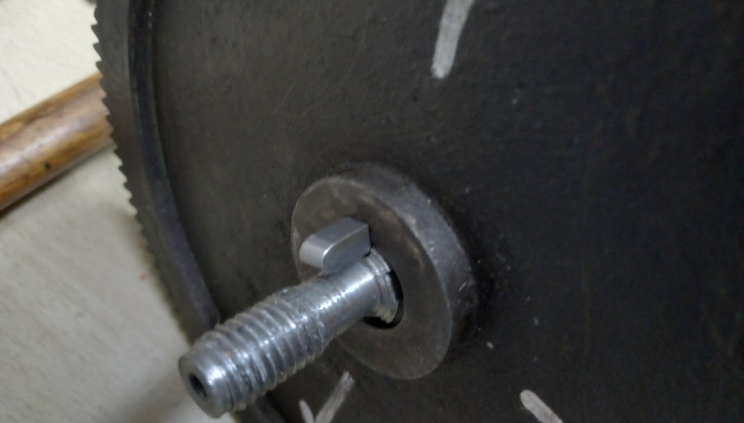

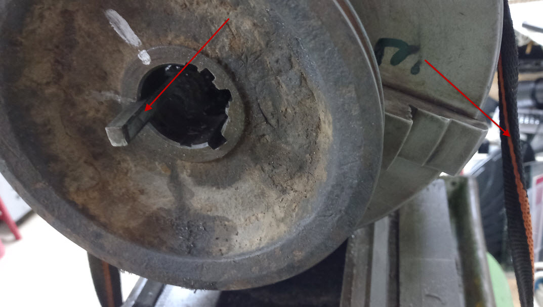

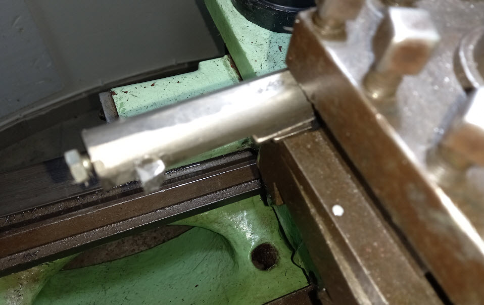

    An easy way to make internal keyway on the lathe without special tools.
    Attached Thumbnails Attached Thumbnails INTERNAL KEYWAY ON THE LATHE.-f1.jpg   INTERNAL KEYWAY ON THE LATHE.-f2.jpg   INTERNAL KEYWAY ON THE LATHE.-f3.jpg   INTERNAL KEYWAY ON THE LATHE.-f4.jpg   INTERNAL KEYWAY ON THE LATHE.-f5.jpg
