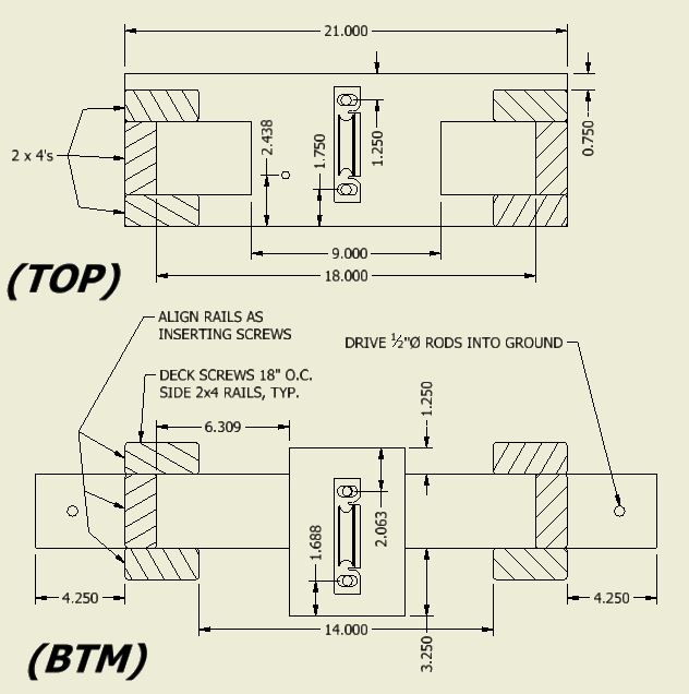

Hello, just joined always looking for ideas. Just wondering if I could get the specs on the home built roofing shingle lift from iowawrench.

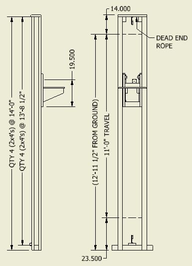

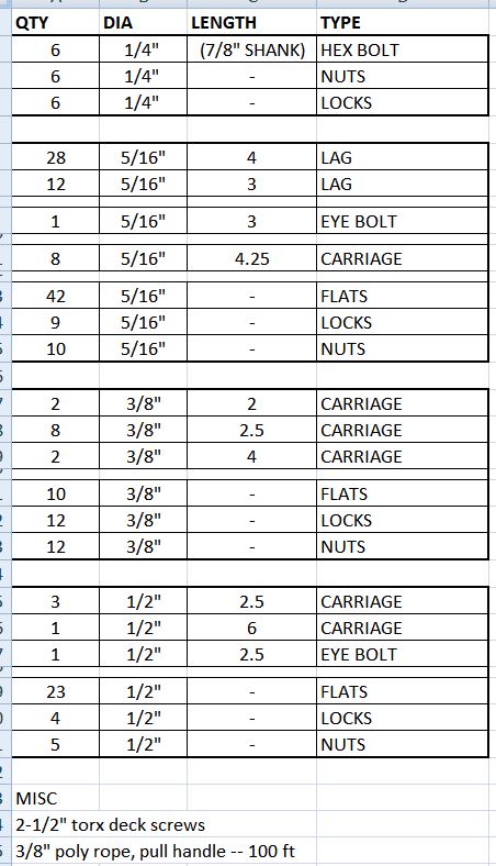

I was persuaded to join to help others out looking for more details on the shingle lift in the youtube video above that I designed and built. A disclaimer: I'm sure you guys would all do it the same way, but I used what I had sitting around as much as possible rather than going out and buying all new. So the drawings I have would need to be tweaked (and maybe improved) to either what you have sitting around, or something similar you can buy. If interested, I could try to revise the design to include a complete BOM using all new parts including pulleys and such from McMaster-Carr or something. Anyways, here are a few snapshots of some of the drawings. If interested, I could post a link to a complete .pdf set of drawings. I thought I had better at least introduce myself though so you all would trust my link to download them. Thanks for letting me be part of this forum.
Attachment 6840Attachment 6841Attachment 6842
