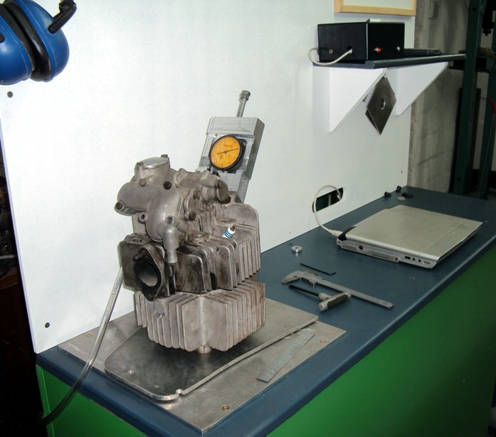

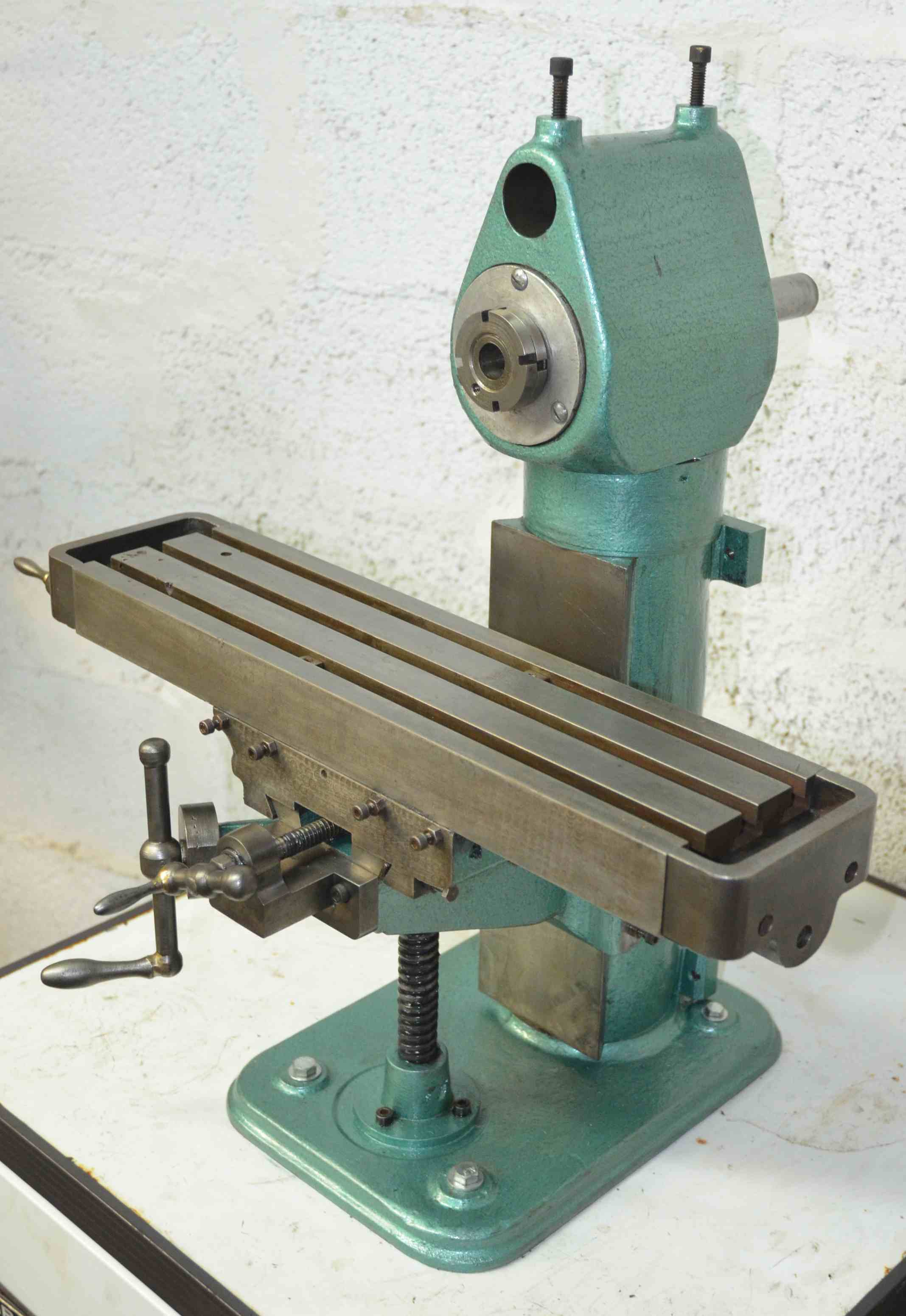

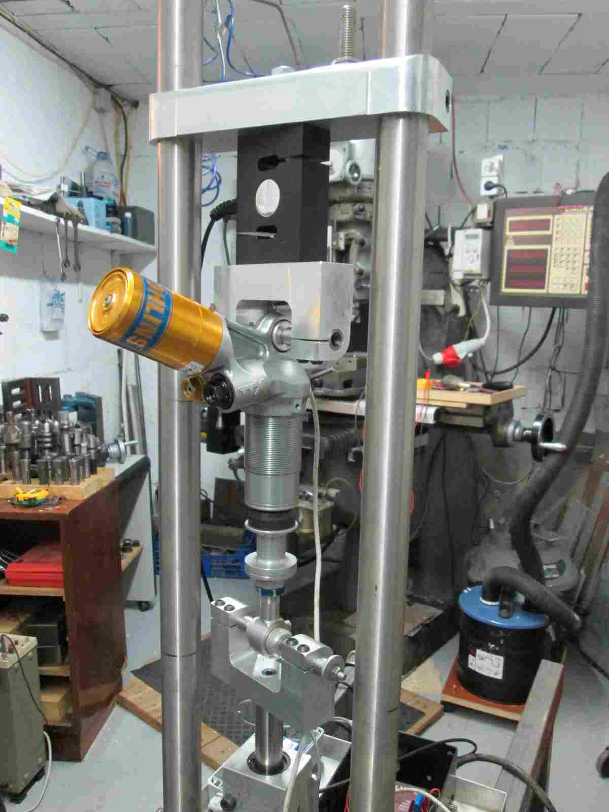

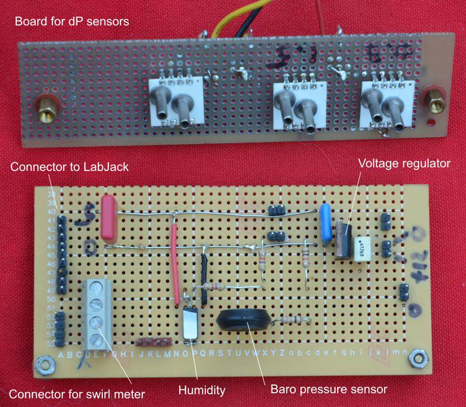

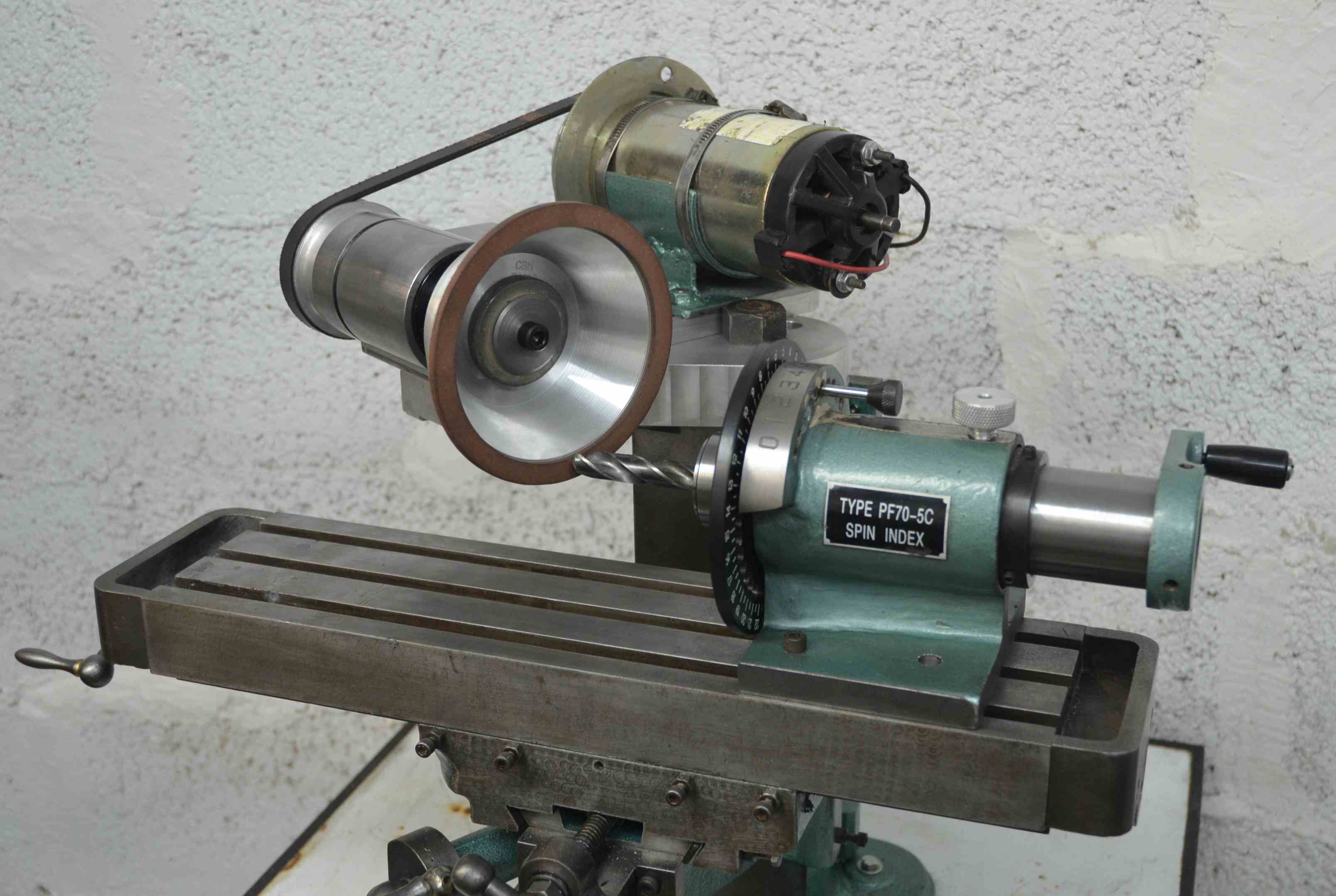

    Glad you like it. I have a bunch more things to post about when I find odd moments to write them up. Some are workshop orientated like a homebuilt milling machine, unusual Tool and Cutter grinder etc. but many are specific to engines etc. like a flow bench, shock dyno, engine dyno, valve train dynamic tester and so on. then there is the electronic and software stuff to make them work. Here are some examples;

    Welcome Tony and a Very nice first post. Great build on the press and recycled converted ram. Most impressive is the Flow Bench and the DP & Sensor boards associated. Couldn't tell what that head was off of (your Aremachhi?), but to build your own bench is impressive in my book. Would enjoy seeing more of that build! Is that bottom picture some kind of shock testing system...looks like some kind of strain sensor at the top there?
    Impressive and varied background and website too. Looking forward to seeing some of your other builds and contributions. Thanks for posting!! ~PJ

    [B][I] Most impressive is the Flow Bench and the DP & Sensor boards associated. Couldn't tell what that head was off of (your Aremachhi?), but to build your own bench is impressive in my book. Would enjoy seeing more of that build! Is that bottom picture some kind of shock testing system...looks like some kind of strain sensor at the top there?

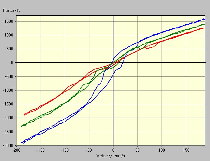

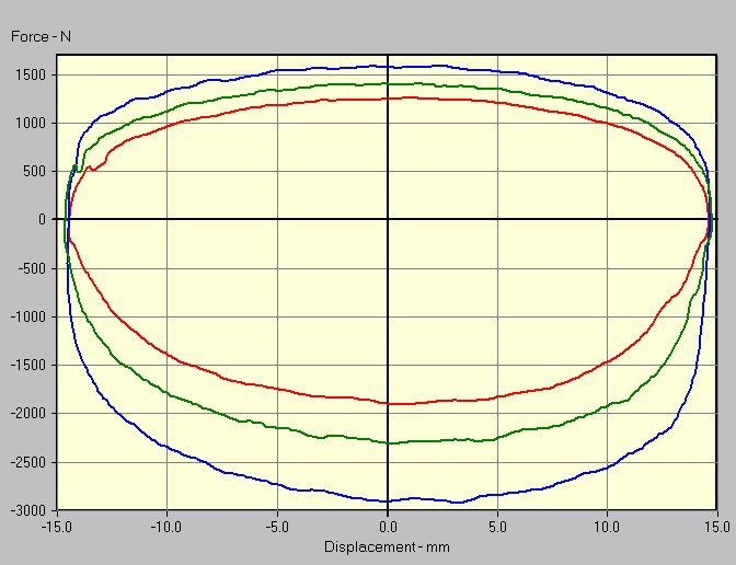

    Yes that's an Aermacchi head and the last pic. is a shock dyno. The shock dyno permits the measurement of fork and shock damper characteristics as in the graphs below. I'll post build details of both.
