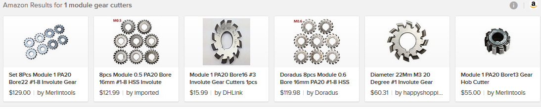

    A full set of 8 cutters can be found

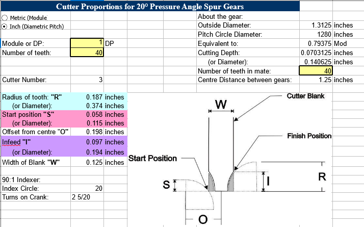

    A bit expensive for a one of job, I have a spreadsheet for making your own cutters or a fly cutter or maybe you are hobbing them.

    Hi, nice & thanks for the details, if could share the spreadsheet may be it would help me to make my cutters.

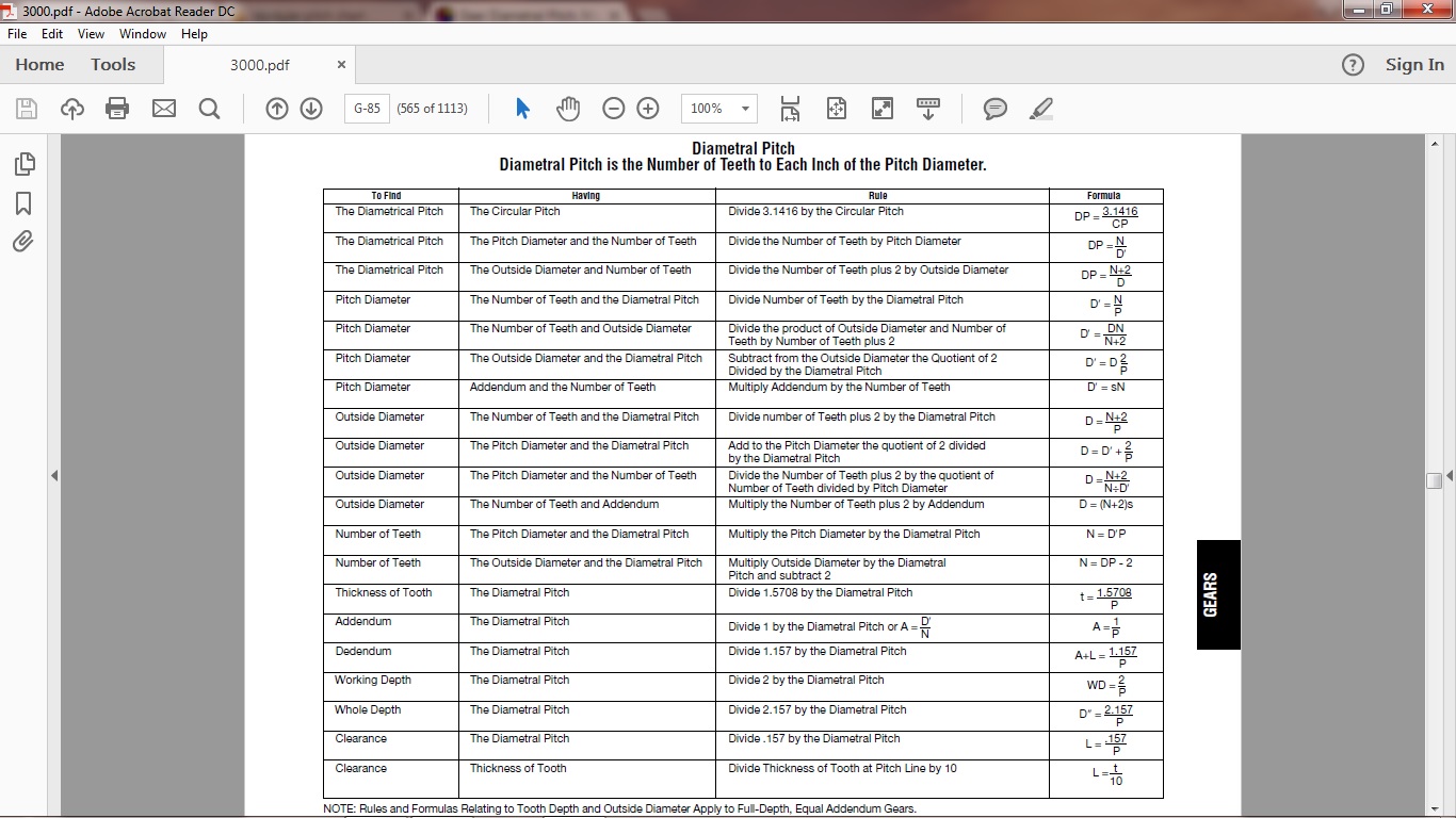

    To find what dimetrical pitch you have try this chart
