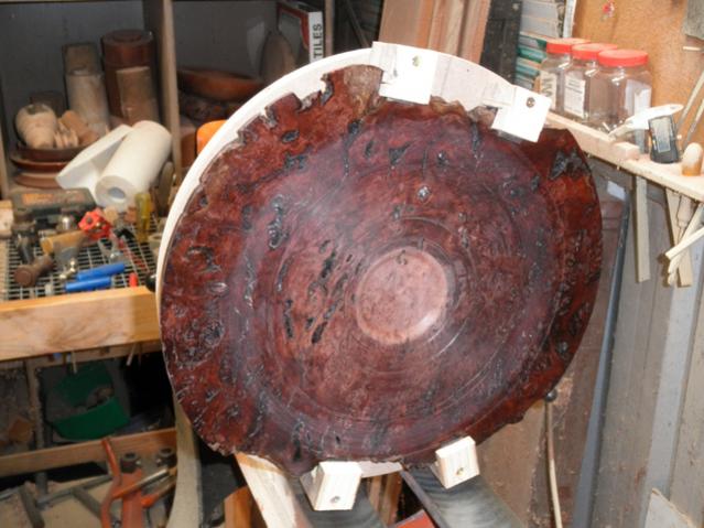

Jaws for odd shapes.
Cut a circle from 30mm marine ply. Cut aluminium disc with tenon which was glued to centre of ply circle.
Trued up on the lathe. Marked circles of various diameters to make aligning easier.
Centralised the wall hanging, screwed & fitted shaped lugs. Lugs have slots not holes to allow for adjusting.
Attachment 1160
Hope it is explained in full, if not please contact me.
