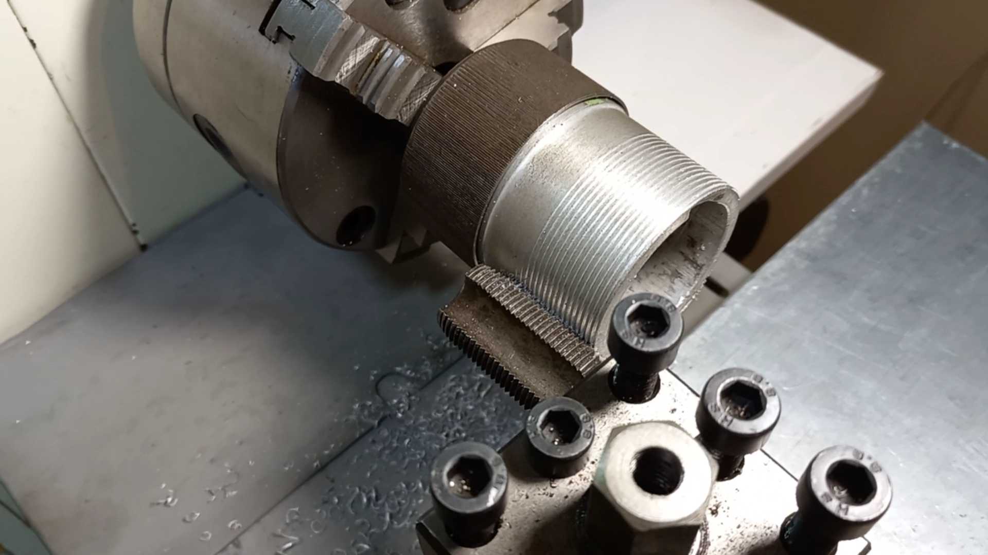

Good afternoon to all iron workers and lumberjacks.

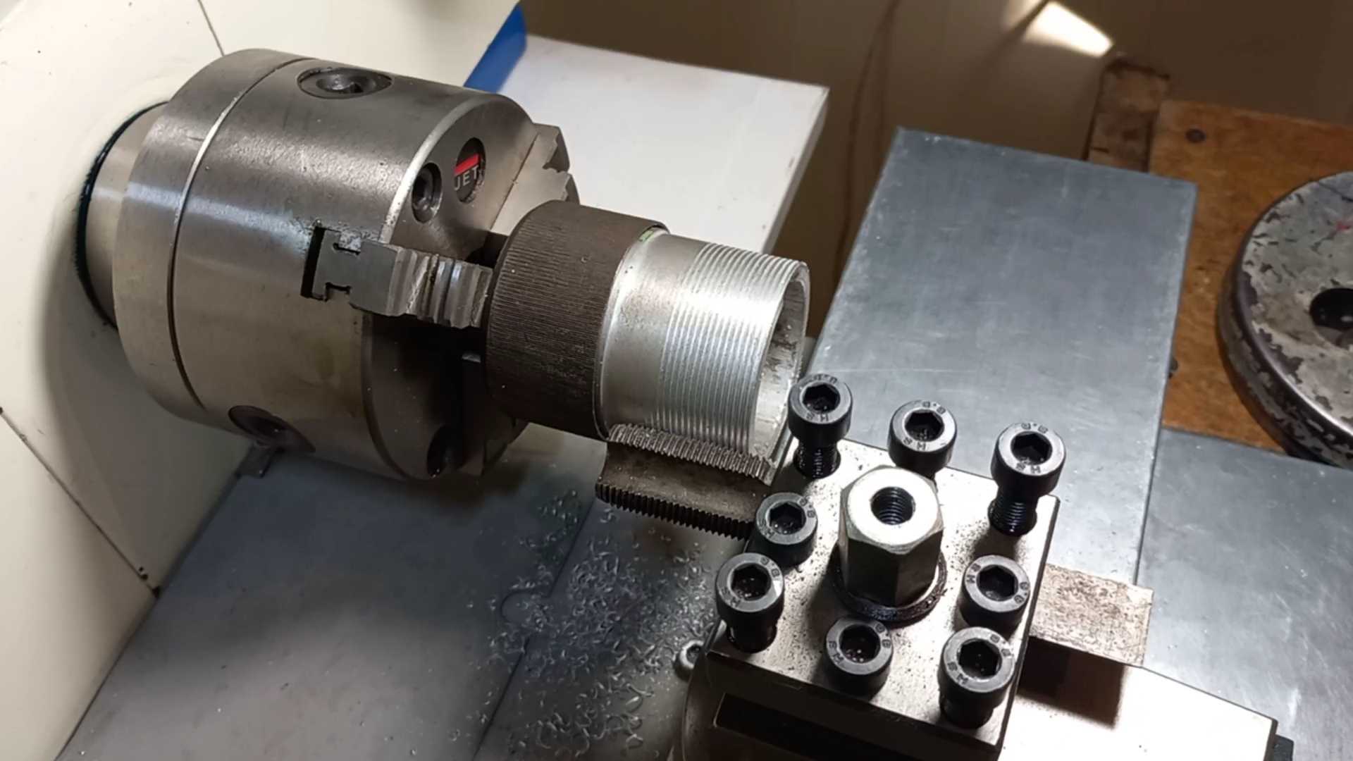

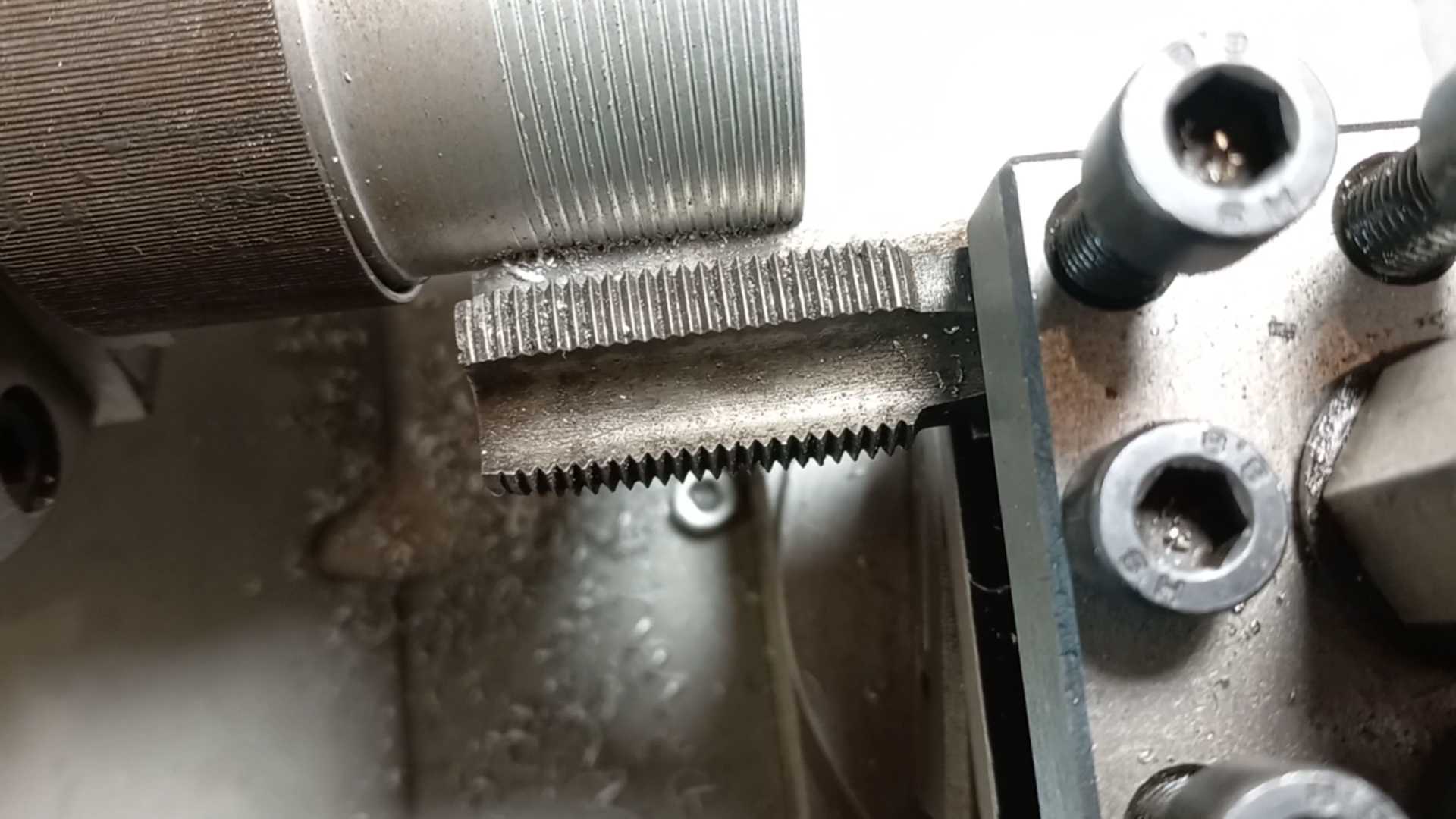

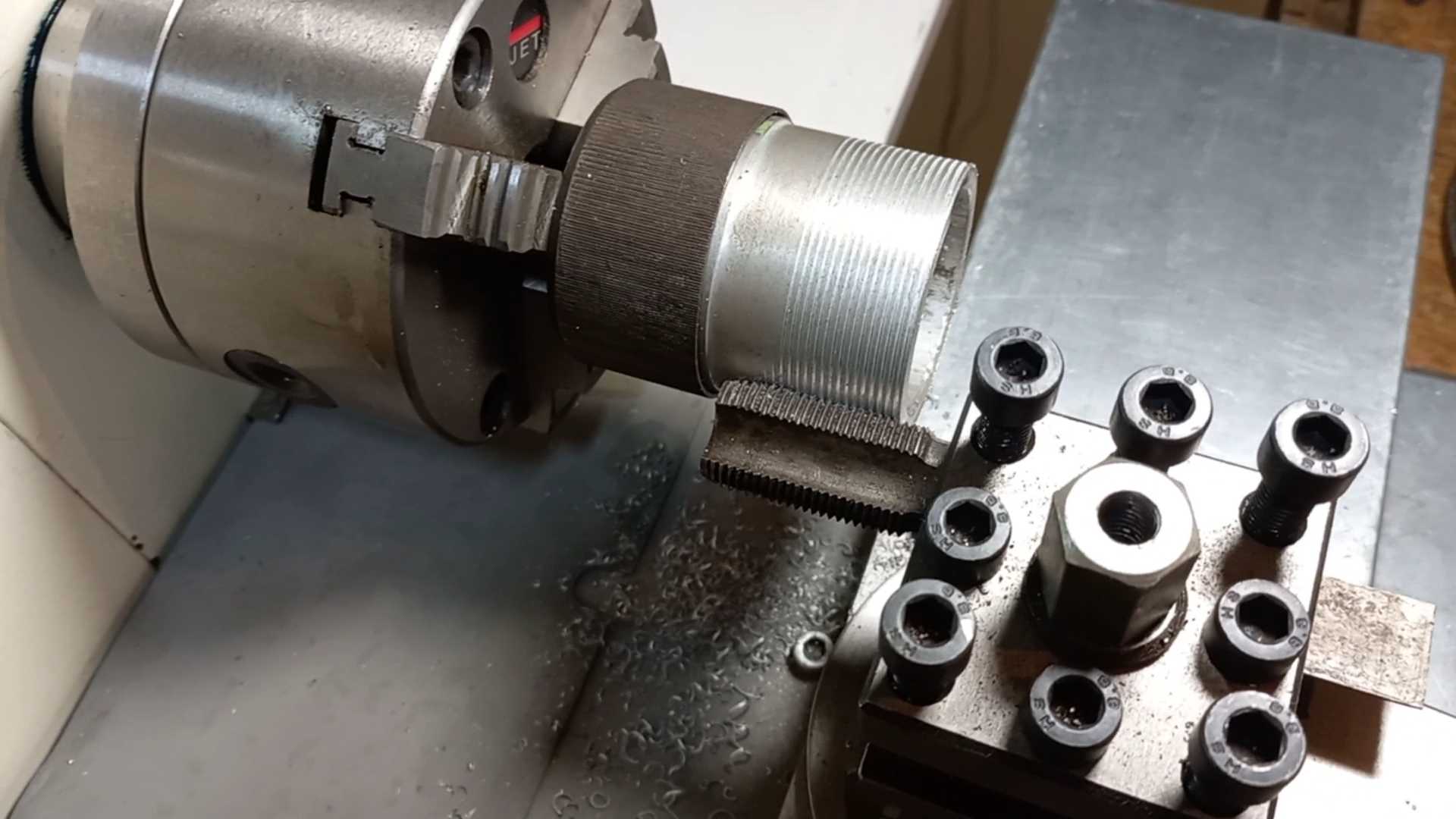

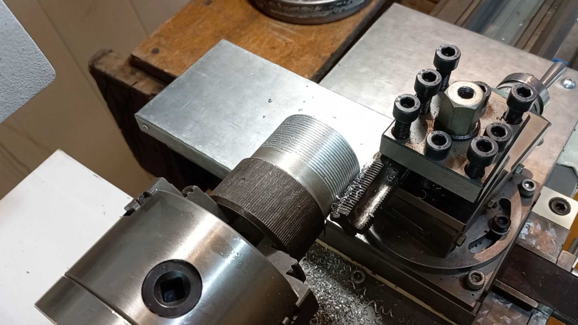

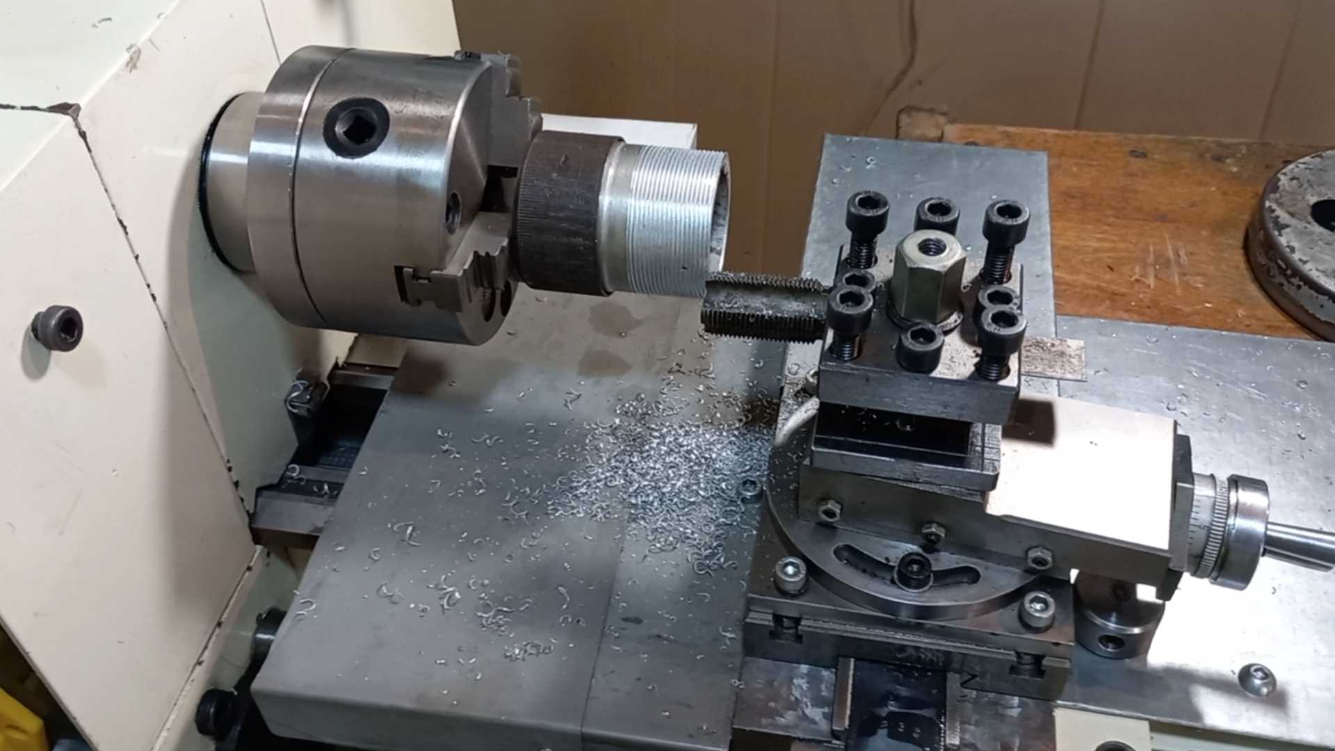

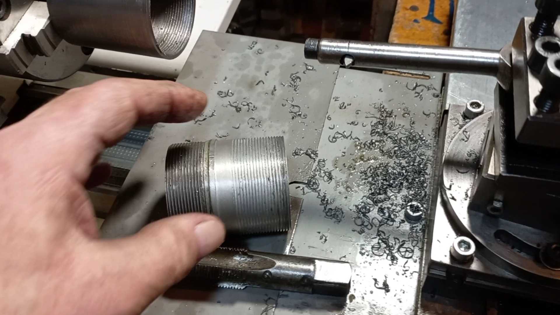

Today I will show you this version of thread cutting.
Attachment 46368Attachment 46369Attachment 46370Attachment 46371Attachment 46372Attachment 46373Attachment 46374
Please also watch the video part 1.
https://www.youtube.com/watch?v=3Q2gKv3h8Zs
Good health and good luck to everyone.
I don't understand Russian, and Youtube's autotranslate is not really helping out, but that looks like a great way to be able to cut tapered threads on a pipe with a lathe.
I had to make a 23/4-12 TPI nut over the weekend and for some reason I Don't have an internal thread cutter . Didn't want to take the time a grind an HSS cutter so I used a 1 1/4-12 tap similat to how it was done in the video only I backed off from the thread before disengaging the lead screw
Do they ever cut a thread? That would work for a straight thread also.
