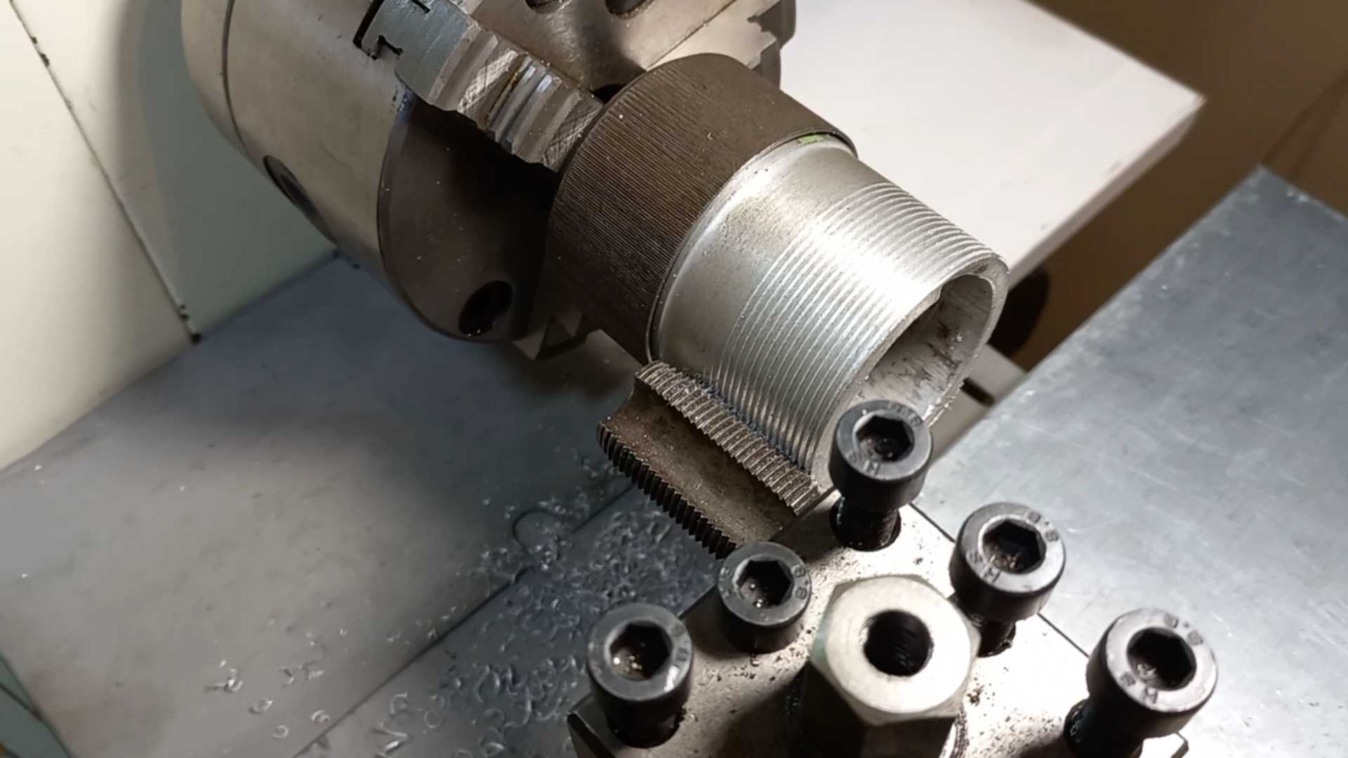

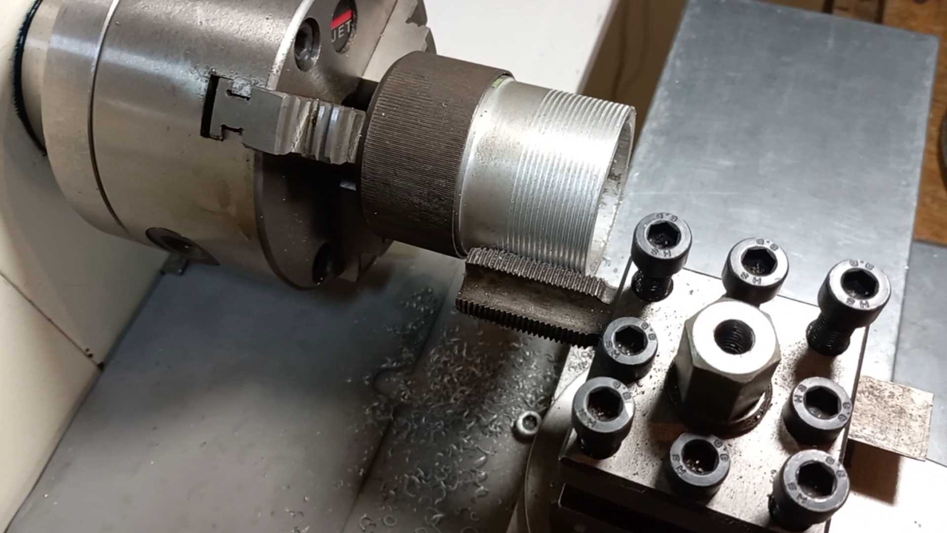

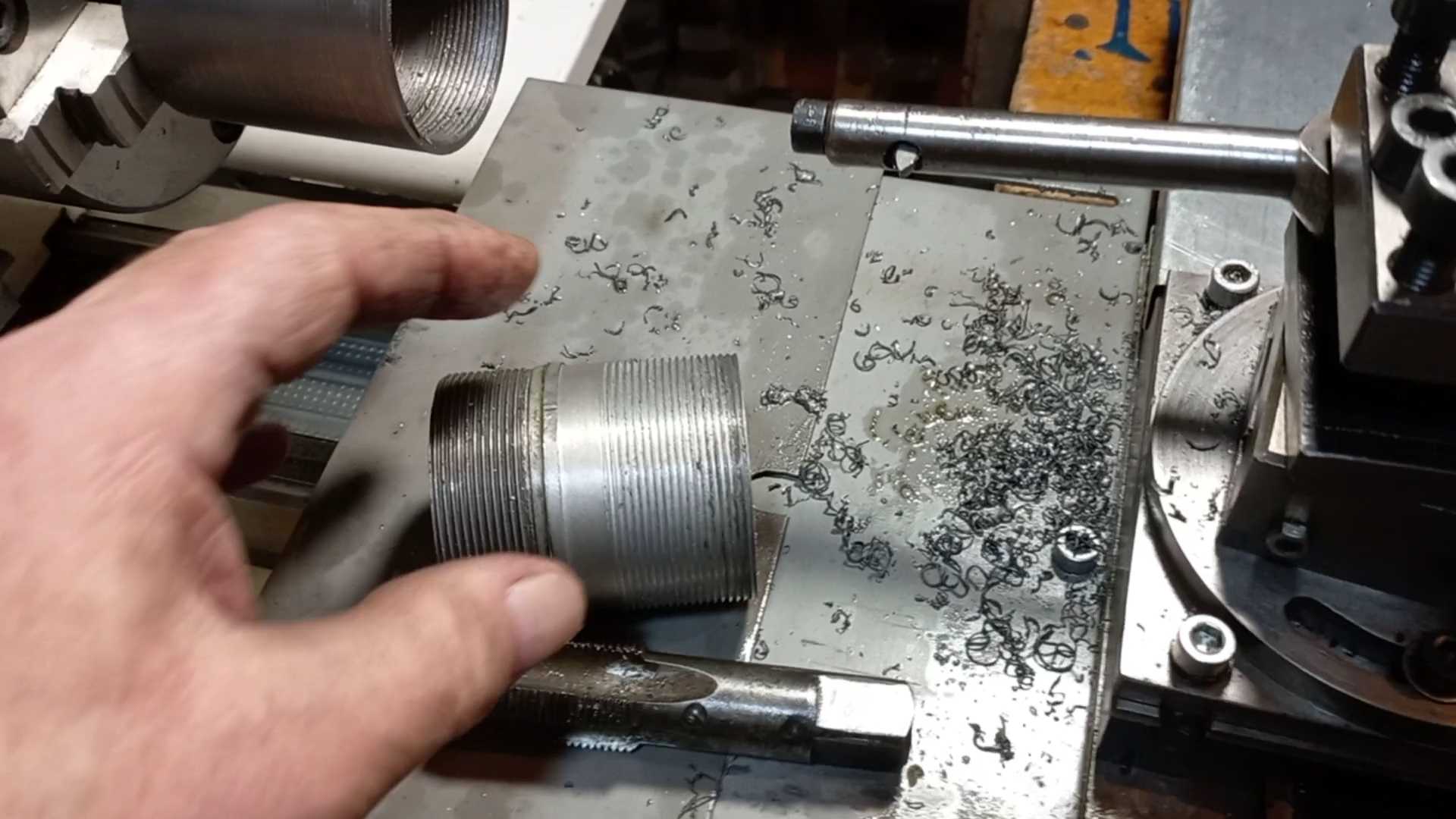

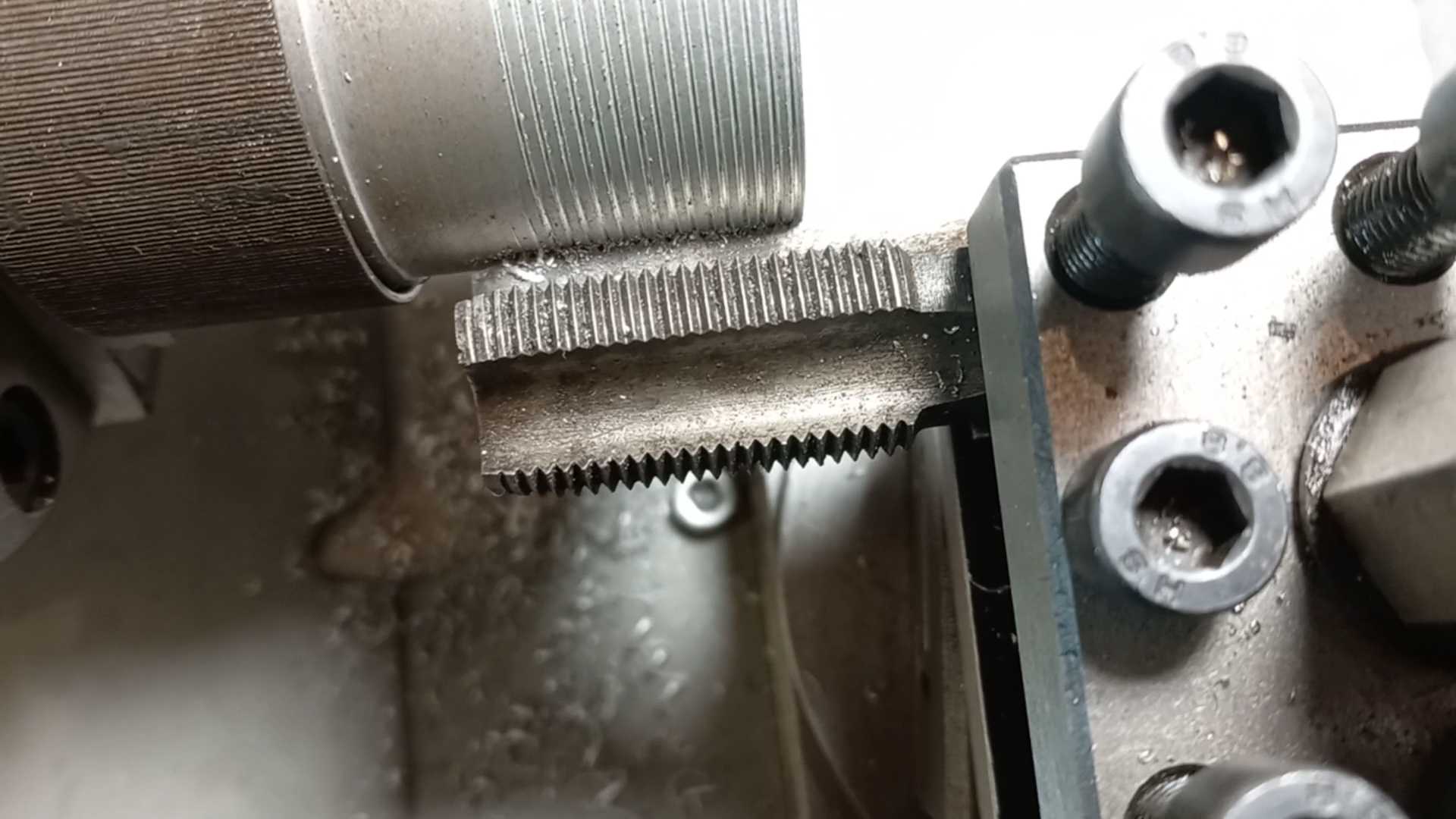

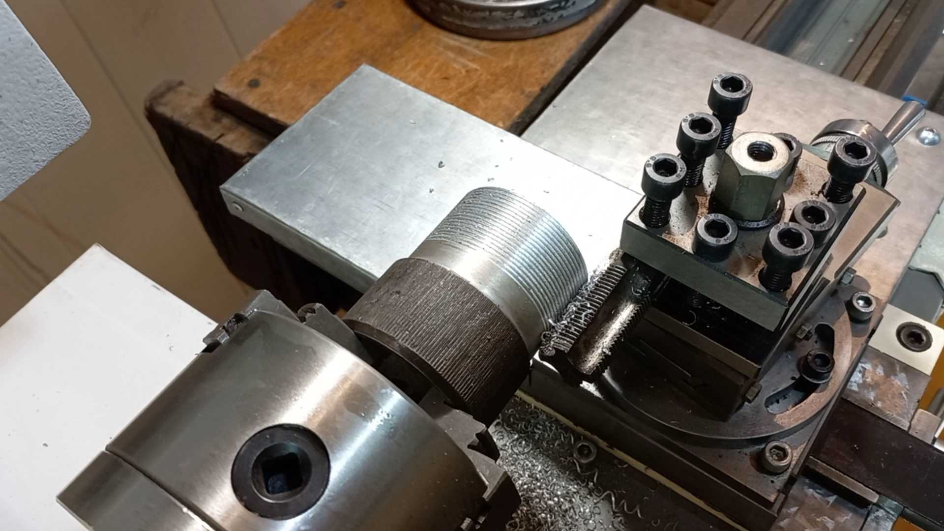

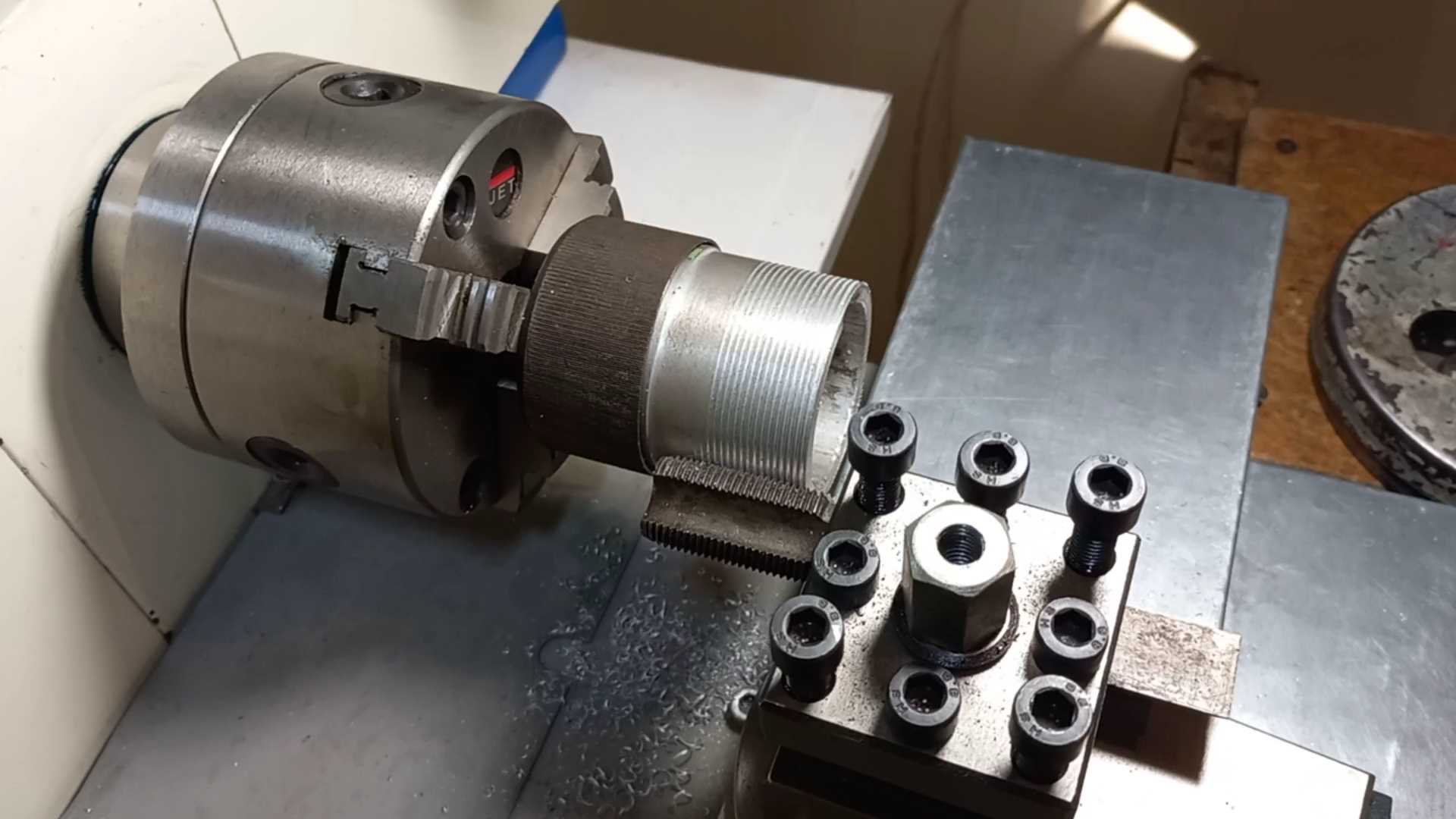

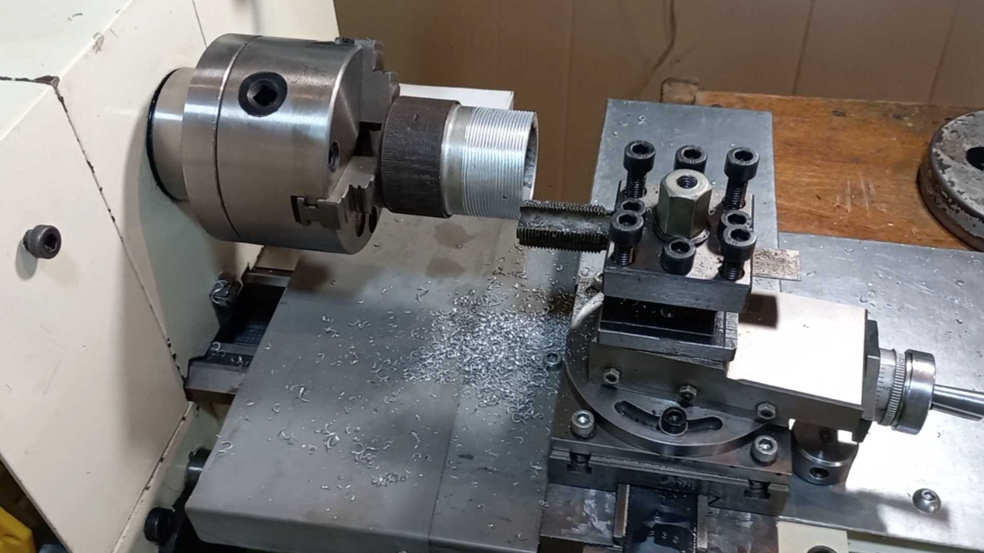

    Good afternoon to all iron workers and lumberjacks.
    Today I will show you this version of thread cutting.
    Jet BD-920W Operating _ Metric Thread Cutting _-1-.jpgJet BD-920W Operating _ Metric Thread Cutting _-1-.jpgJet BD-920W Operating _ Metric Thread Cutting _-1-.jpgJet BD-920W Operating _ Metric Thread Cutting _-1-.jpgJet BD-920W Operating _ Metric Thread Cutting _-1-.jpgJet BD-920W Operating _ Metric Thread Cutting _-1-.jpgJet BD-920W Operating _ Metric Thread Cutting _-1-.jpg

    Please also watch the video part 1.
    Good health and good luck to everyone.

    I don't understand Russian, and Youtube's autotranslate is not really helping out, but that looks like a great way to be able to cut tapered threads on a pipe with a lathe.
    11,229
    1,986
    I had to make a 23/4-12 TPI nut over the weekend and for some reason I Don't have an internal thread cutter . Didn't want to take the time a grind an HSS cutter so I used a 1 1/4-12 tap similat to how it was done in the video only I backed off from the thread before disengaging the lead screw

    Do they ever cut a thread? That would work for a straight thread also.
