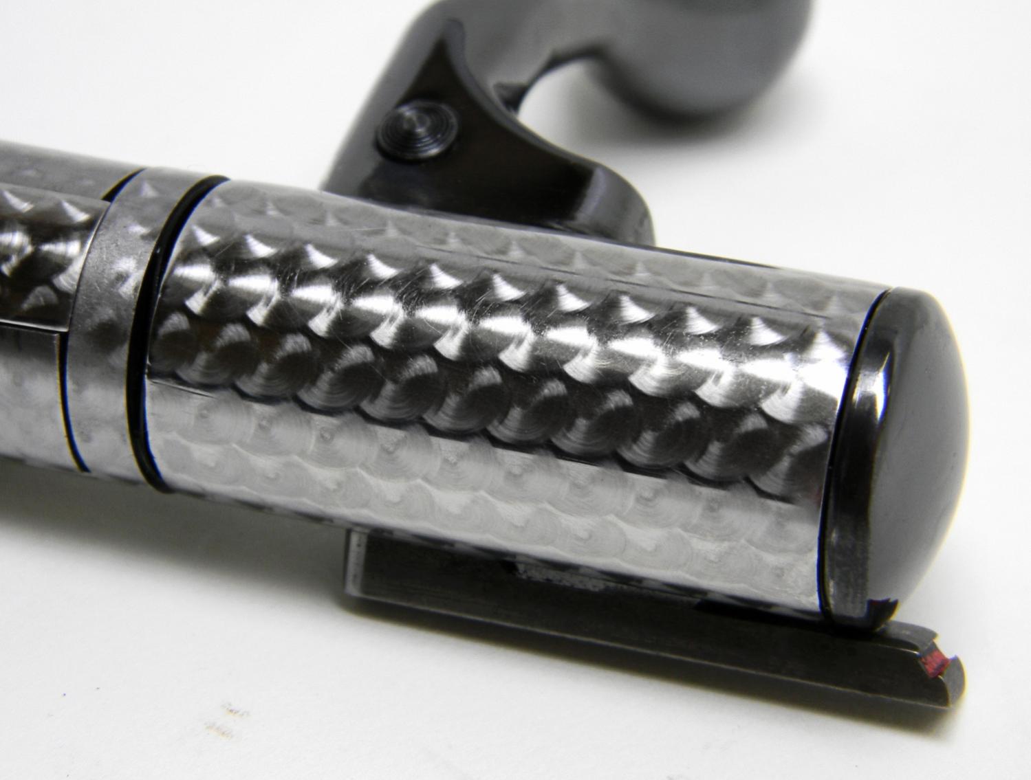

    Hi all!
    I'm searching info about this technique, I would like to use on the aluminum panel of my next amplifier
    I saw some video on youtube about attempts, but there is nothing about a good work.
    In local shop there are no tools at all, I saw that there are some rubber rod filled with abrasive, nearly impossibile to find here.
    Someone used steel brush, someone rubber with polishing paste.
    For a good job, in your opinion, what's should I need?
    That's the effect I desire

    The rubber rods filled with abrasive you mention probably refers to Cratex products, examples of which are shown here...
    https://www.amazon.com/s/ref=nb_sb_s...=1PG71K5J1ET9R
    As an alternative to Cratex, I've had some success using sections of wooden dowel with a patch of leather glued on the end. Smeared with lapping paste and rotated in the drill press, they leave a nice circular swirl.
    An attractive jeweling job requires two things. First the spacing of the circles must be consistent; spacing errors will stand out and look bad. Arrange some method of mechanically stepping the work between swirls. Don't try to space by eye. Second, the pressure with which the tool is applied to the work should be consistent. While this is slightly less of a concern than the spacing, it's still important.
    Be sure to experiment on some scrap before working on the amplifier. Undoing a bad jeweling job is very difficult.

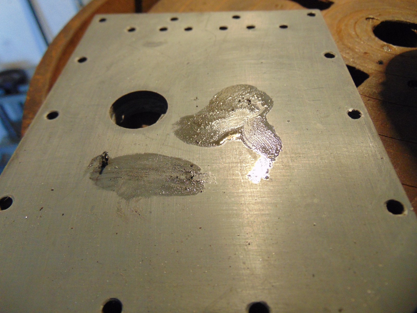

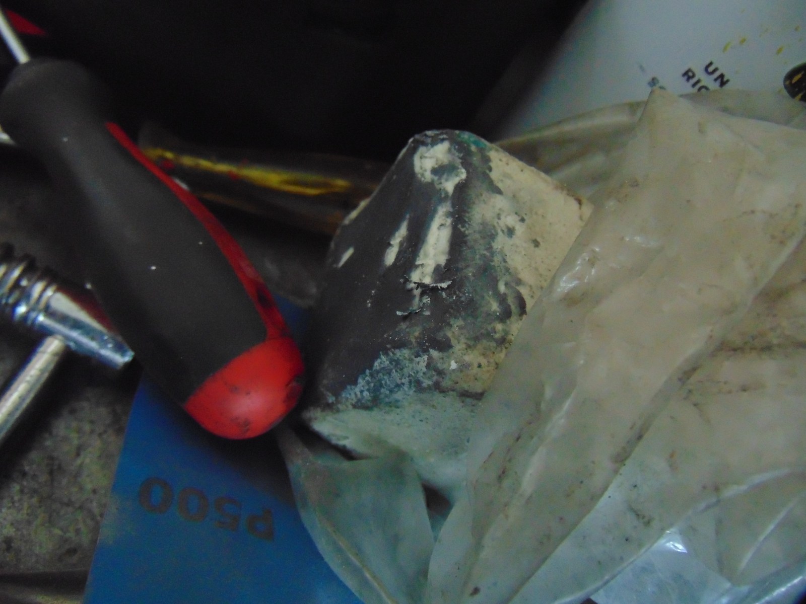

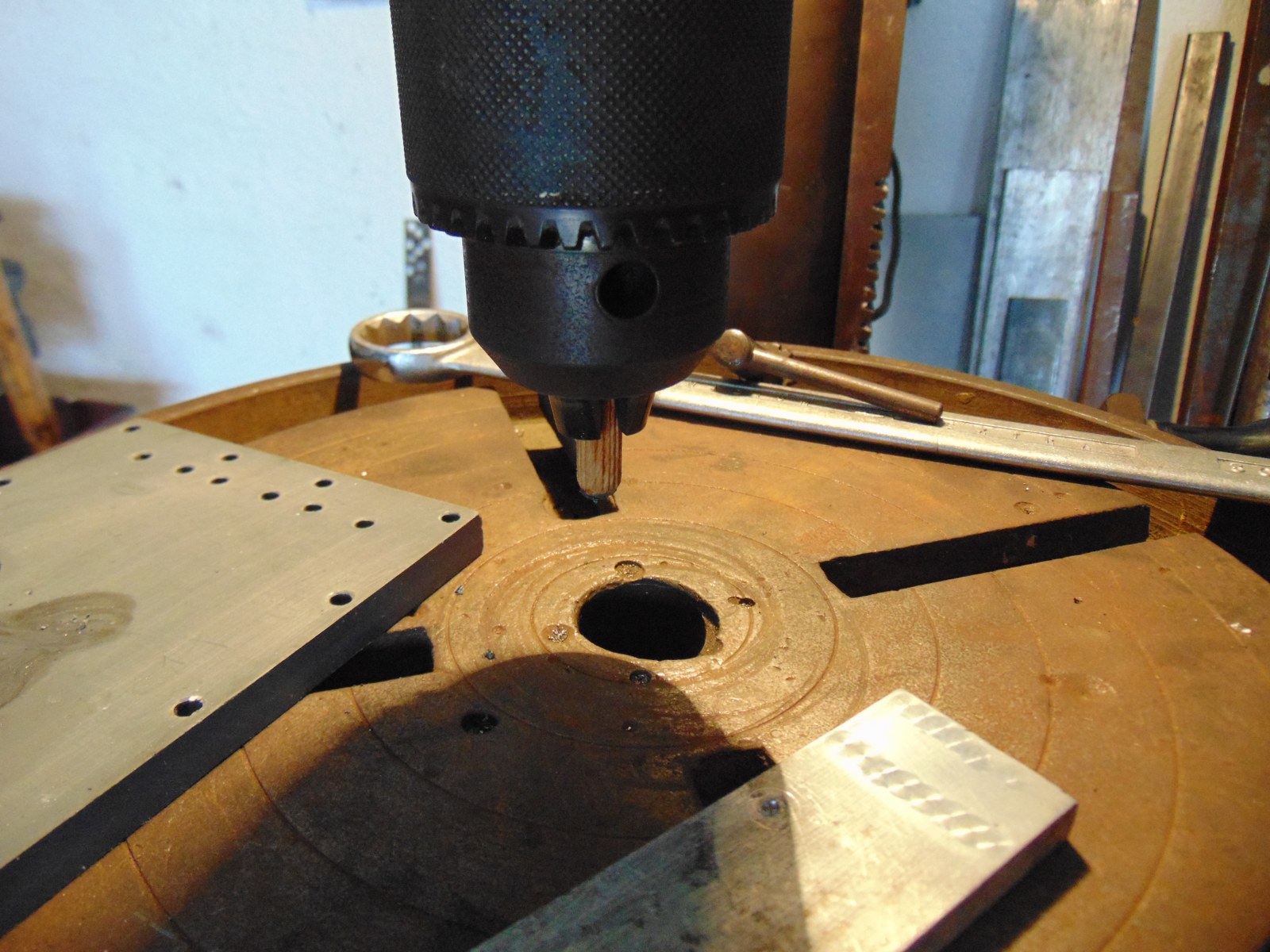

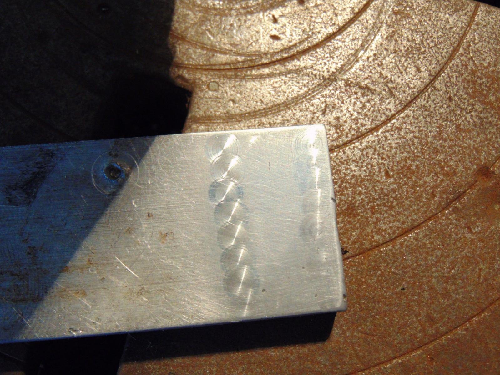

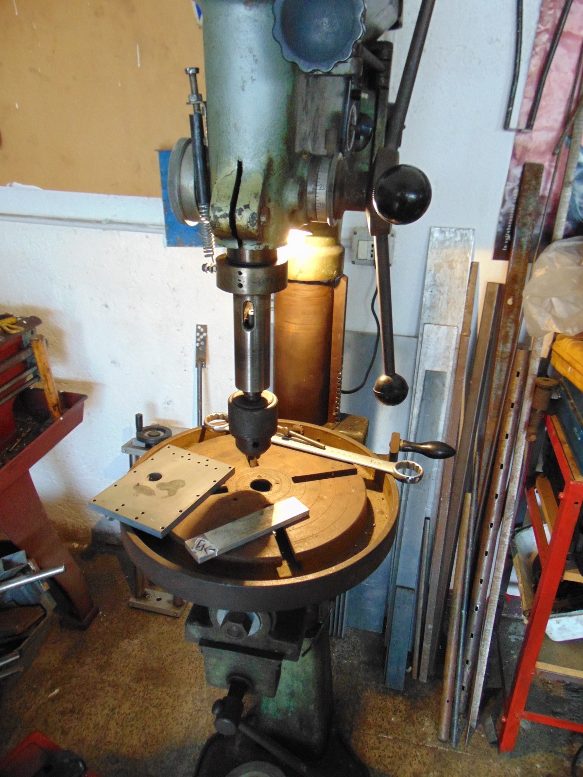

    I just tried for my curiosity a fast tool with leather, glued with mastic.
    I tried to put some White polishing paste crumbled and amalgamated in oil, I know it's a bad job, but it was just an attempt to see what would happen. I used 3000rpm with light pressure, the signs are visible after cleaning, but I bet I need something more aggressive. The aluminum scrap was only cleaned with 180 grit paper, too rough maybe for the job

    It looks like what we call "white diamond" polishing material here in the USA. A bit too fine for jeweling though, as you've proved, it produces the characteristic swirls. Do try to get some lapping grease in the 100-200 grit range.
    At any rate, you seem to have proved the leather-on-dowel tool works reasonably well. Keep up the experimenting; you'll soon be an expert.
