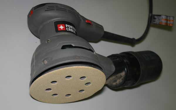

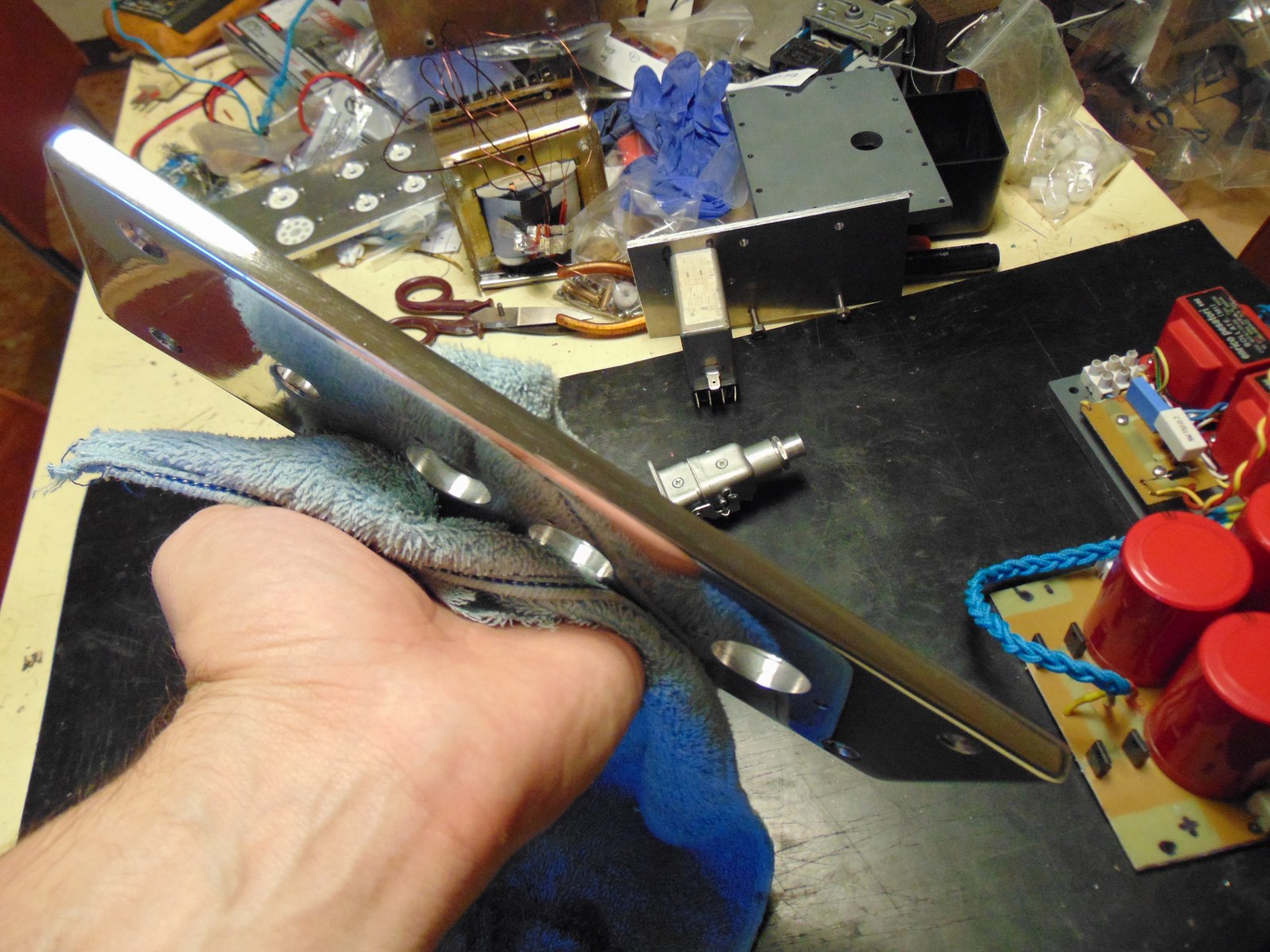

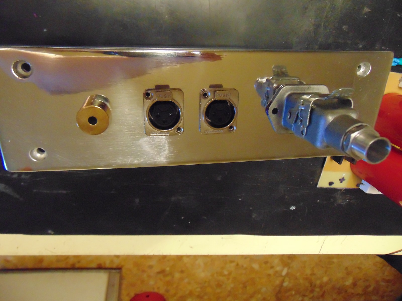

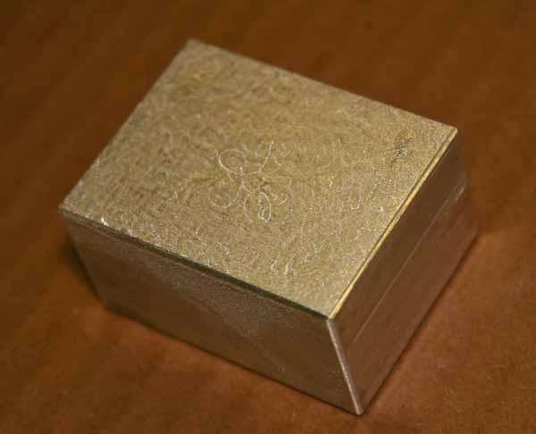

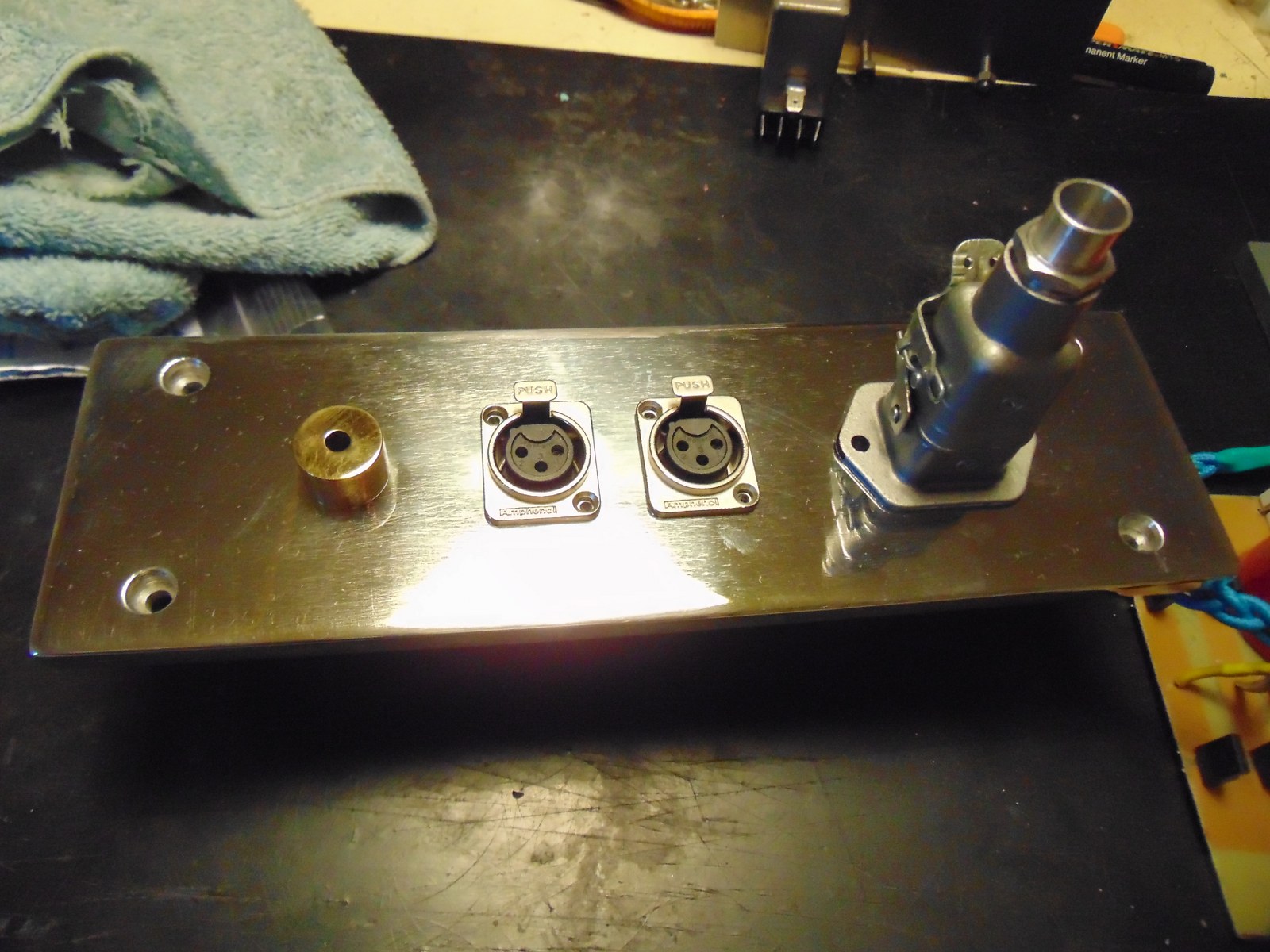

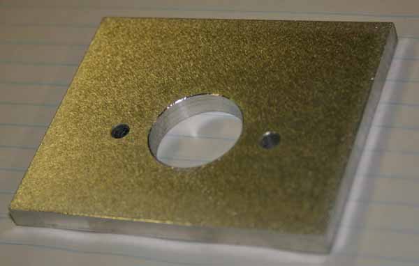

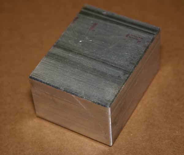

I have done a bit of this work in the past. The information here is good. What I didn't see yet is the original surface finish. In my experiments, the engine turning went faster and easier when the original surface is polished to a very smooth finish. This gives a shine and consistency to the swirls and takes a lot less time on each spot because you are not having to overcome a dull or otherwise imperfect finish.
