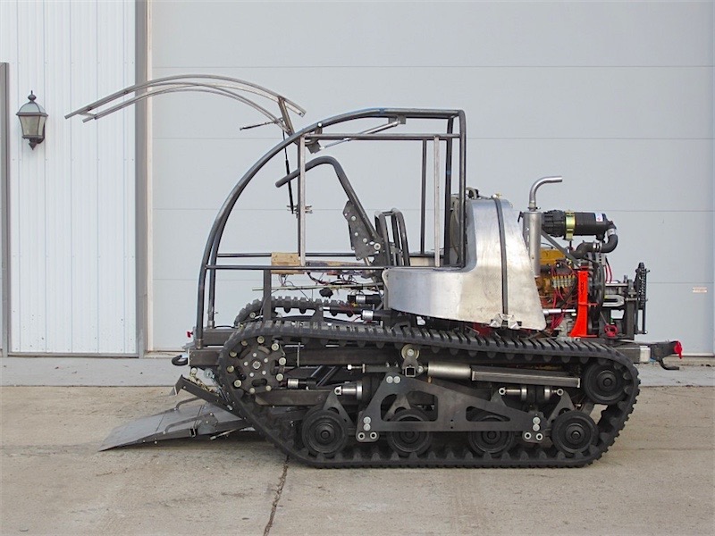

I can empathize with your situation, as I'm currently building a track chair for a client who's in a wheelchair, and is paralyzed from the armpits down, and has limited arm strength, and his hands are mostly locked in a curled position. Because of this, I've designed in many features to allow him to be as independent as possible, and still control everything himself. You can read more about it here: All Terrain Track Chair (ATTC) - Kustom's by Kent

This thread is not complete without an inline pic of Kent's All Terrain Track Chair. One of the coolest builds on the internet.
https://diqn32j8nouaz.cloudfront.net...rack_chair.jpg
